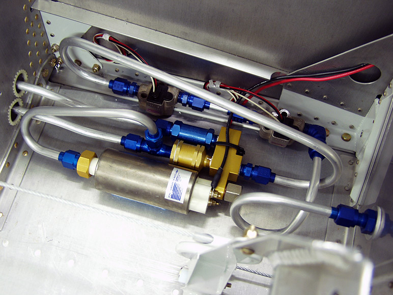

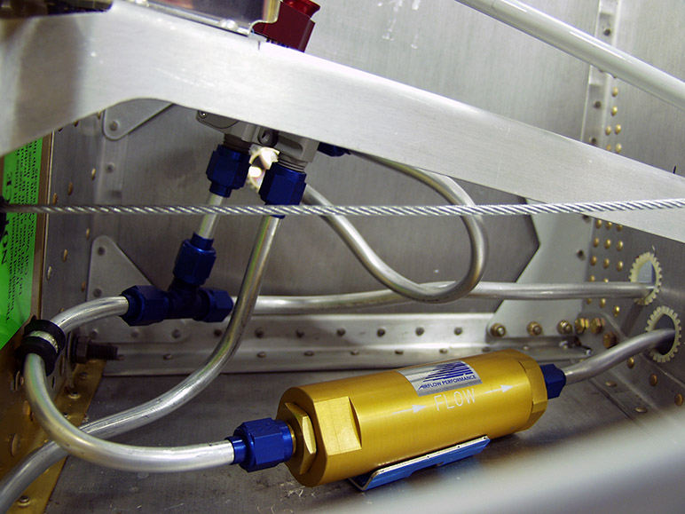

Dear Listers,
I pulled out all of the fuel selector valve and fuel pump goodies from the old fuselage today. I disassembled all of the various flare ends and cleaned up all the Fuel Lube with lacquer thinner making sure not to get any in the pump or valve or transducers. All but two of the fuel lines seem to be reusable and don't show any signs of damage from the Mishap. I really don't want to have to recut, rebend, and reflare all of these if I don't have to.
What's the common knowledge on reusing the flares on the fuel and brake lines?
Am I just asking for a bunch of leaks if I put these back into service now that I've unscrewed them?
Thanks!
Matt

Reuse the good ones Matt.

Matt,
My rule is to carefully inspect each line, pulling back each b nut to
inspect the flares. If you use a good 10x magnifying glass, inspect it that
way. But you can can use lines again without reflaring! If find a crack
discard, make a new line..
Elton Stone

Matt:
Just check for cracks and any debris. You can re use these with no problem at all. FYI, you really DON'T want to use fuel lube on these AN fittings. That stuff is mainly used on Pipe thread fittings where the fluid will leak through the threads. On an AN fitting, the flare fitting takes care of that.
Al

Matt AS a A&P and instructor, those lines that look good are more than likely good. The whole trick is not to overtight the b nuts. U should be fine. Everything I see is looking great!
