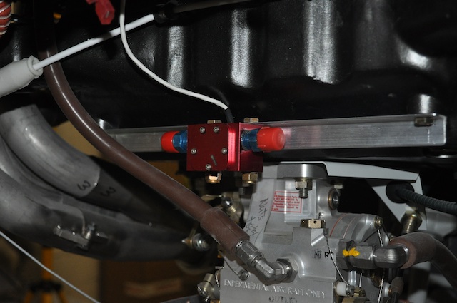

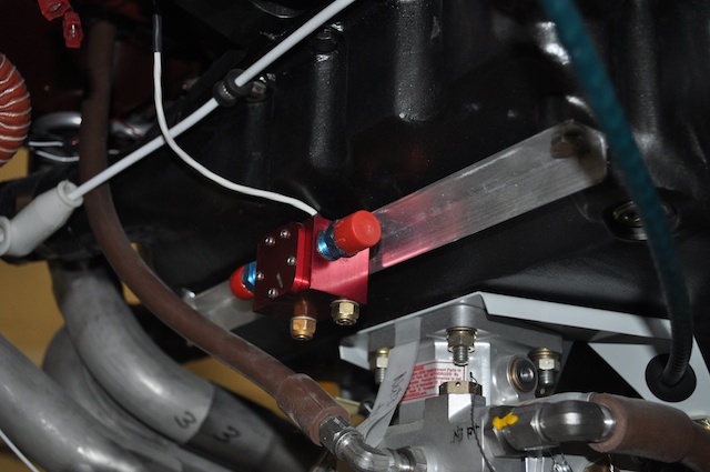

PostPosted: Tue Oct 04, 2011 12:14 pm    Post subject: Re: 5inch before and after redcube fuel-transducer Reply with quote
Hello all,
I thought I´d post my solution of the position of the fuel flow sensor (red cube). For those who are looking for an alternative position.
I need to order now new fuel lines and will then finally attach the bracket to the engine case and safety wire the bolts.
Mike
