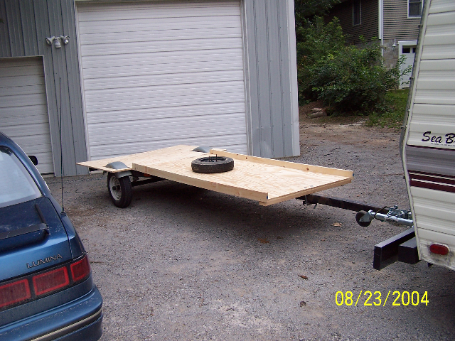

I modified a fairly light boat trailer by screwing 3/4" plywood onto
the trailer. One piece was laid the long way, and one laid crossways,
with cutouts to clear the fenders on the trailer. My wings were put
together, but the fuel tanks were not installed. Without the fuel
tanks in place, the wheels can be raised and stuck through the wings
where the tanks would be. The wings then ride vertically, chord-wise,
alongside the fuse, and resting on the leading edge...cushioned, of
course. It is a VERY good idea to raise the tailwheel, and take
advantage of the "through-the-fuselage" tube that allows for this.
When I first got the notion to travel to Texas (thanks, Jimmie) to
pick up this unfinished plane, I made some late evening measurements
of my trailer, installed the plywood the next morning and I was well
on my way to leaving for Texas in a day or so.

I just recalled some details about my boat trailer modifications
regarding the Kitfox....when I got to Texas (1300 mile trip), I moved
the one piece of plywood closer to the front of the trailer, so that
it would be under the tailwheel, and I recall now having built 1/4"
"sides" on the floor to keep the big chunks of airplane from rolling
off. : )

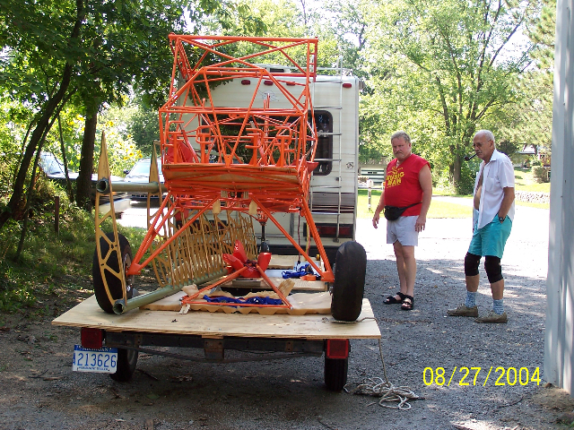

Here are some pictures:

Mark, don't feel bad. I moved my project in about the stage you see in Lynn's pictures. It took me six years to finish then another year to fix what I broke trying to fly it with minimal tail wheel experience, then another six years to get brave enough to try it again after getting the proper training.
Today I am doing my on 4th annual condition inspection and enjoying every minute of it so much I can't hardly stand it.
Anyhow on moving your kitfox. I used a rental Rider 24 foot van. That will probably be pretty expensive as you seem to be traveling much futher. You can probably do it much less cheap...er... inexpensive buying a boat trailer and using Lynn's photos for a guide. Transporting the wings leading edge down is the same as I did.
Lynn, is that Jimmie in your photo? I had many conversations with him while I was building. Some extra parts from my Kit are now in your airplane. Bet you didn't know that.

Lynn Matteson
Posts: 2778
PostPosted: Tue Aug 02, 2011 6:13 pm    Post subject: Trailering advice Reply with quote
Nope, those are two neighbors of mine....both looking kinda doubtful
about what their neighbor just dragged home. But the "fat guy with a
beard", as he calls himself, has been up in my plane several times,
so he's a doubter no more. : )
