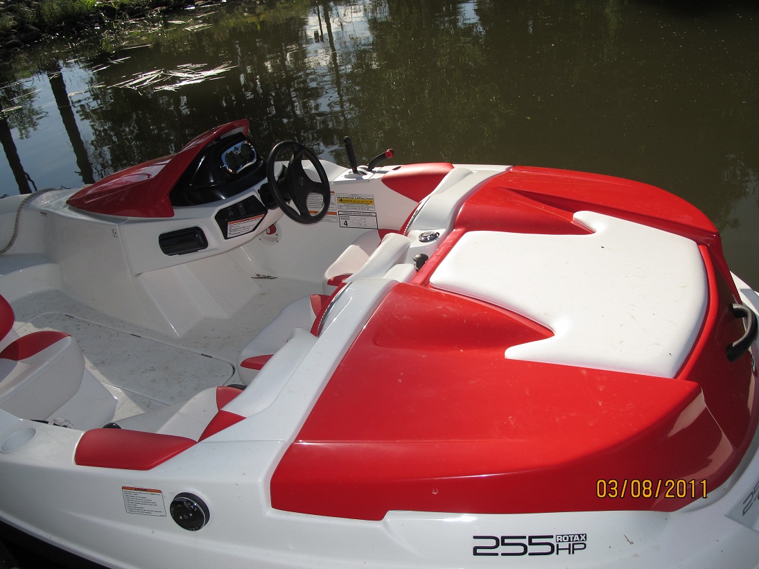

PostPosted: Wed Aug 03, 2011 10:53 am    Post subject: Fuel Injection Reply with quote
Hi Martin
This is slightly off-topic but I cannot resist:
How about this vehicle engined by Rotax?
Fuel injected, water cooled, three cylinder, four
cyckles, super charged with intercooler, 255 HP (at)
8000 rpm, 1493 cm3, very sophisticated sound and
with extremely smooth endless power. Used to be
inside GRP /composite structure. Very fast.
It is my new toy but what is it?
Cheers, Raimo Toivio

PostPosted: Wed Aug 03, 2011 11:39 am    Post subject: Fuel Injection Reply with quote
On 08/03/2011 06:13 PM, Martin Olliver wrote:

On 08/03/2011 08:50 PM, Raimo Toivio wrote:
Hi Martin
Fuel injected, water cooled, three cylinder, four cyckles, super charged
with intercooler, 255 HP (at) 8000 rpm, 1493 cm3, very sophisticated sound
and with extremely smooth endless power. Used to be inside GRP
Boat?
Frans

PostPosted: Wed Aug 03, 2011 4:44 pm    Post subject: Fuel Injection Reply with quote
Seadoo, a big and very fast seadoo Smile

paul.the.aviator(at)gmail
PostPosted: Wed Aug 03, 2011 5:09 pm    Post subject: Fuel Injection Reply with quote
I'll bite.  Jet Ski?

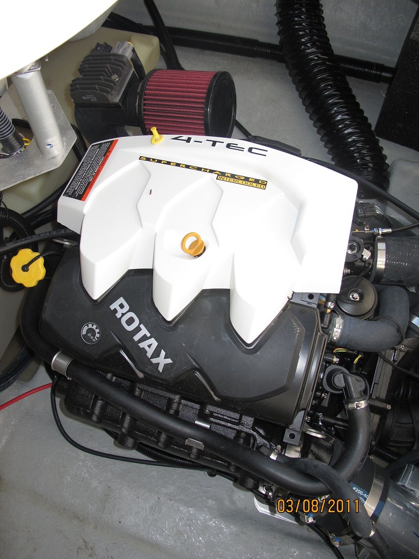

Pete, Nigel, Paul, Frans and all
It is a JetBoat for four persons (attachment). That is only one in the country like my Europa as well.
About the reliability: they claim it is very good but there must be (so far we have logged 6 hrs only so I have not a history with it)
1) good manners to use it (manual is thick like a bible *)
2) regular service (first in 10 hours)
3) correct service methods and tools and usable OBD computers
4) hi-quality liquids and spare components
Typical Rotax (and other hi-tec) requirements, are not they?
* they warn even to swim nearby when engine is on or iddle. Otherwise you may loose your scalp into water intake. One pulling rope went there and ohboy it was a hard task to take it away.

Yes – SeaDoo Speedster 150 (just one engine). Actually quite small one. Weight 659 kg, length 4,67 m, beam 2,16 m, draft 0-30 cm (!).
Fadec included + D.E.S.S. + full monitoring.
Pete, there are two different coolant systems: one (closed) for the engine and another (open fresh water) for the exhaust system.

My guess or my wish is this topic will soon develop “is it (Rotax 1503 4-TEC) possible to install into plane /Europa”. Someone of you genius people around the world is planning the installation possibility.
I start: the overall size is ok and the weight maybe also. It is very compact, clean, hi-tec. Good brand name. It is planned to use with full power or near. Revs are high but we have gearboxes, have not we...
Gentlemen - start to write + and – sides and all that usual fighting...
And, EMHC is not a pure fantacy only: for example tomorrow morning we (my wife + I) are going to fly to Oland to Sweden for Europa Aircraft – Nord Fly-inn.
When over the Lonely Baltic Sea with autopilot we will have some fun before landing to Borgholm ESMB, I promise. That is one essential part of flying delights, pleasures and joys...highly recommendation.

From: Paul McAllister (paul.the.aviator(at)gmail.com)
Sent: Thursday, August 04, 2011 4:07 AM
To: europa-list(at)matronics.com (europa-list(at)matronics.com)
Subject: Re: Fuel Injection
I'll bite. Jet Ski?
On Wednesday, August 3, 2011, Raimo Toivio <raimo.toivio(at)rwm.fi (raimo.toivio(at)rwm.fi)> wrote:
Hi Martin
Fuel injected, water cooled, three cylinder, four cyckles, super charged with intercooler, 255 HP (at) 8000 rpm, 1493 cm3, very sophisticated sound and with extremely smooth endless power. Used to be inside GRP /composite structure. Very fast.
href="http://www.matronics.com/Navigator?Europa-List">http://www.matronhref="http://forums.matronics.com">http://forums.matronics.com

My guess ----
CAN-AM, the name of a recent addition to the road machinery – a powerful 2-seat three-wheel motorcycle made by a subsidiary of Bombardier and Rotax-engined.
Two wheels in front, girlfriend hanging on for dear life aft.
Ferg [quote][b]
