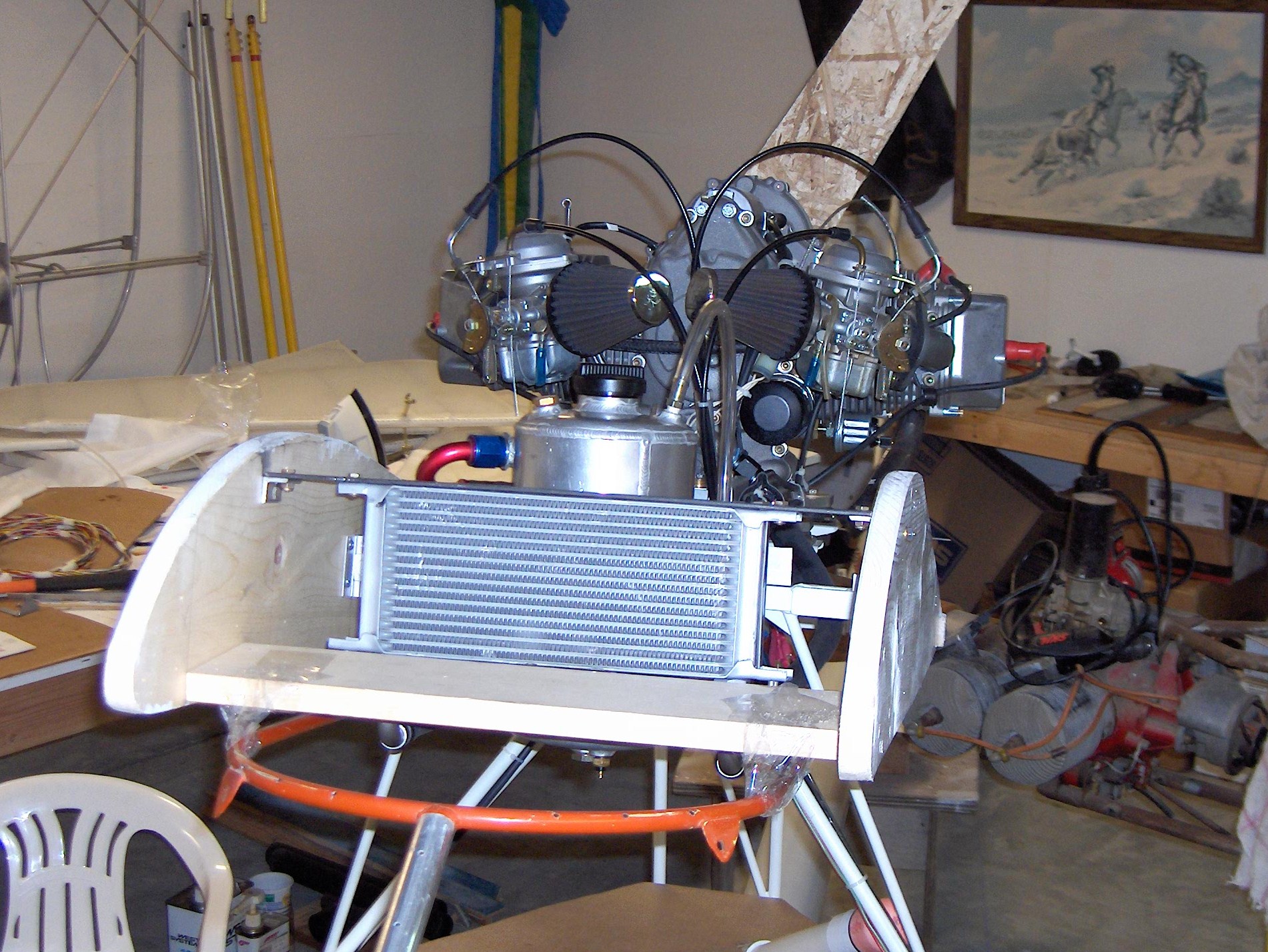

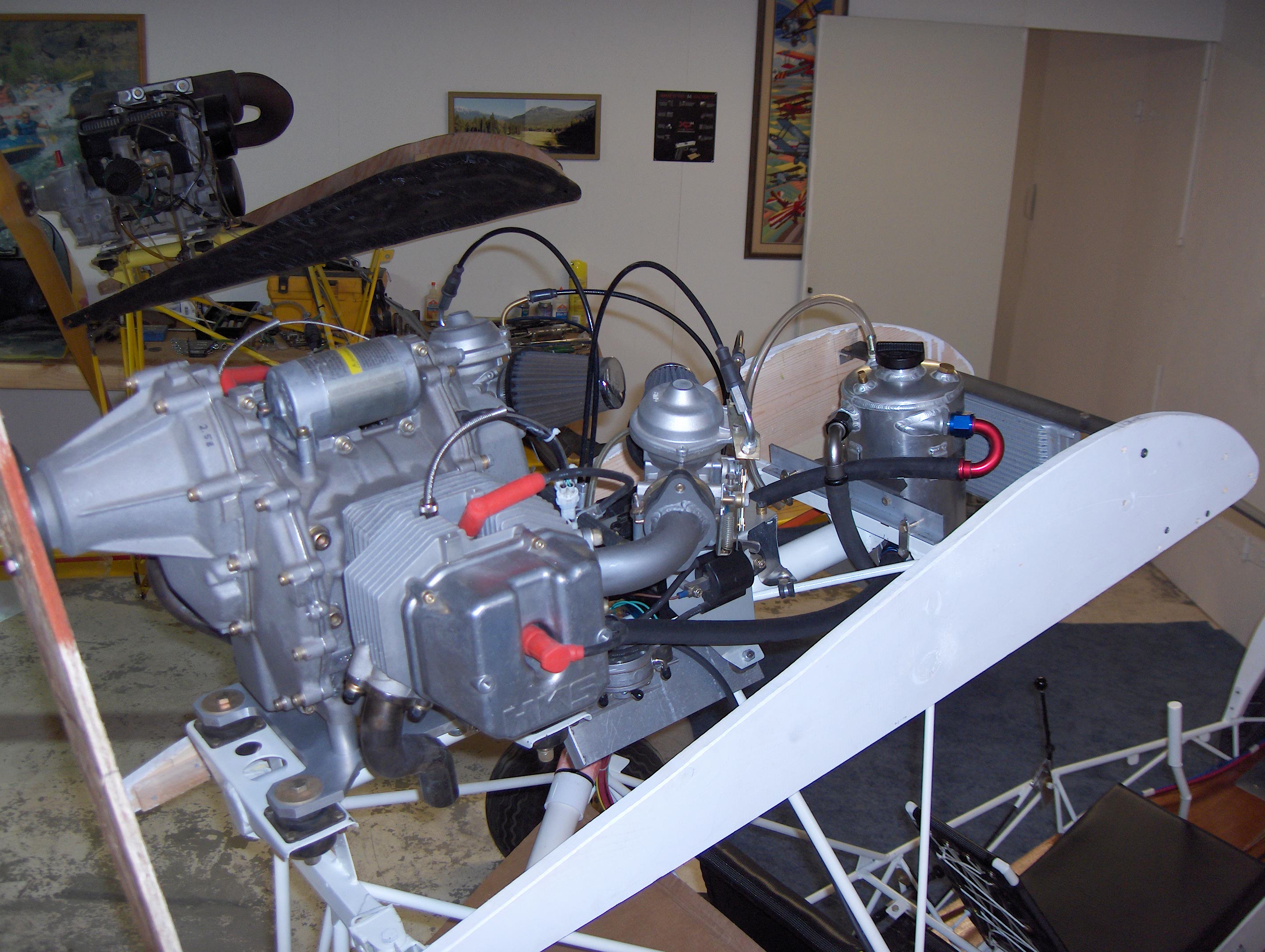

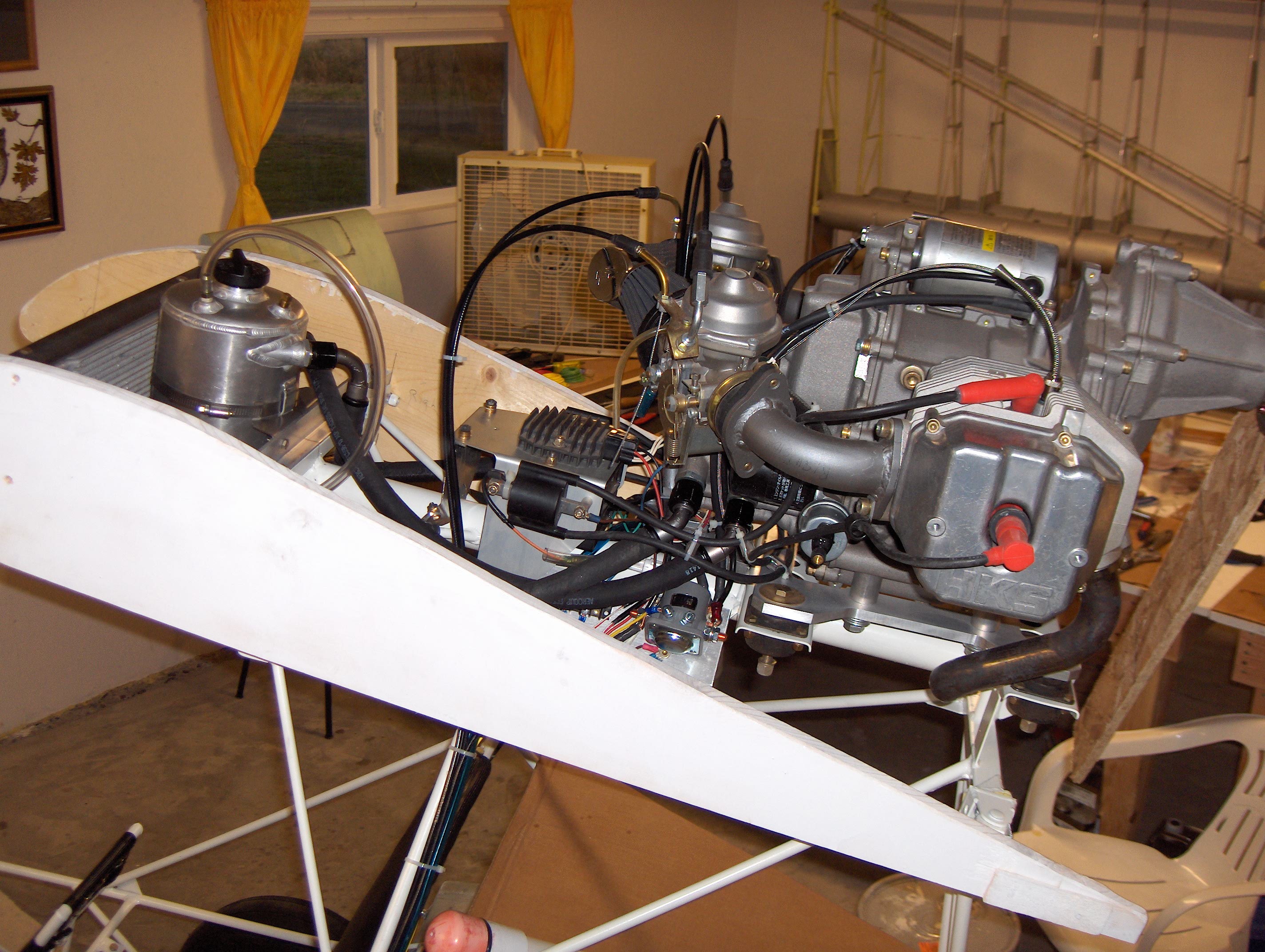

This problem concerned me from the start with construction of my Firestar II with HKS engine. It was obvious to me we need to get the noise behind us. I have never seen it done, but I am putting my exhaust under the engine and out the back. I realize it takes a custom made exhaust system, but think it will be worth it. This also eliminates the huge amount of drag the muffler creates on top. It also, in my mind, necessitated a custom fuel tank which can be firewalled from the muffler heat and fire potential. Mind you, this is still in the developmental process. Included are a few pictures showing the oil cooler and oil reservoir up front where they need to be. You will see a substitute wing root profile used for reference purposes during fabrication and spacing. Eventually the whole gap seal area will have a light one piece removable fiberglass airfoil covering with an air intake opening channeled to the oil cooler. In the winter the oil cooler and oil tank can be used as a cabin heat source.
Andy

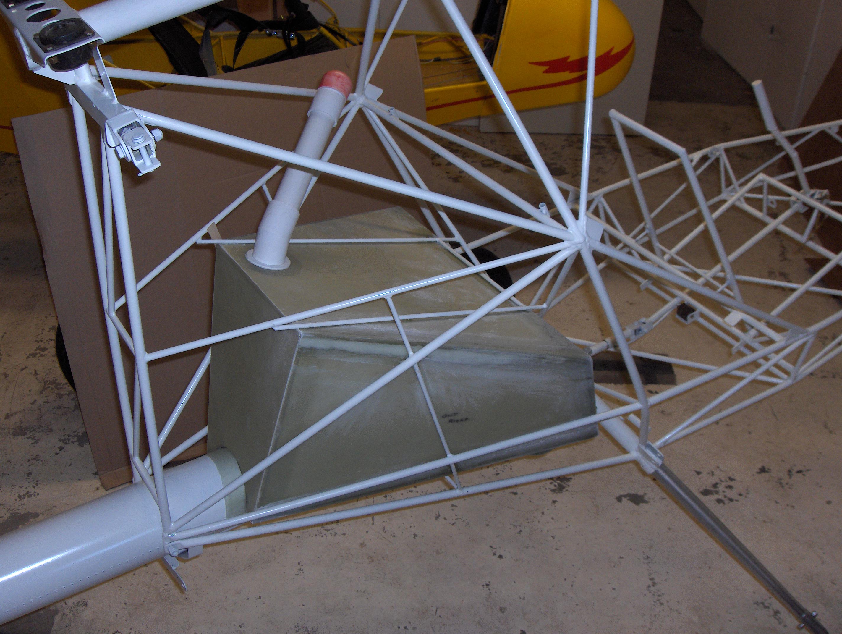

This is how I addressed the muffler issue with the HKS on my Slingshot. For the Tractor enthusiasts out there, I found the best muffler that fit the application was IH Farmall A muffler. It is light weight and short, and had the correct input diameter. It also has adequate back pressure and everyone tells me it sounds very good from the ground. I installed a heat shield between it and the cockpit, which never even gets warm. It is still relatively loud in the cockpit, but just a set of noise canceling headphones makes for easy communication and very easy on the ears for long flights. It is much quieter than my original Firestar with a Rotax 377, which requires earplugs and noise canceling headset. I am sending a picture, but not sure if it will post to the list, never sent one before. If not, just send me a PM, and I will send it direct.
Tom McCarthy
