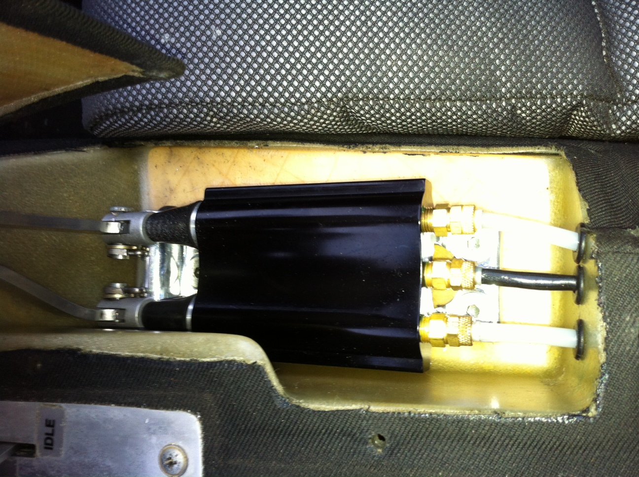

Thanks for the advice, I've just come from the airfield having done a bit more investigation.
Attached is a picture of my master cylinder, apparently it's a "New Jamar finger brake controller all filled with DOT5.1 fluid filled from the wheels as per the build book"
Apparently I have "Matco 5 inch discs on the wheels with new seals fitted."
I just popped the cover off the levers to look at the master cylinders and there are A LOT of very large bubbles in the left hand tube leading out of the master cylinder.
I have just bought a bleeding kit and some 5.1 and will try to sort it out tomorrow, I'm just worried there is a leak or something – as it was fine last week but absolutely terrible now..
Do you think a simple bleed from the LH calliper will do the job?

PostPosted: Fri Nov 11, 2011 9:40 am    Post subject: Europa Finger Brakes Reply with quote
Carl
Not wishing to be a party pooper don’t use Dot 5.1 Brake fluid in your system,
Dot 5.1 is a glycol base brake fluid and is not suitable for the seals in the Brake valve
And callipers, I have had two Jaymar cylinders and both were a problem even after
A complete strip/clean and seal replacement,
Last year I through them out and fitted the twin matco cylinders using normal aviation
Hydraulic oil or ATF, also replaced the calliper and brake valve with the Buna seals and had no problems since,
The only fluid combatable with both types of seals is
Silicone Dot 5
If you check the archive there is a great deals of information about this very subject, I personally do not like the silicone fluid So changed all my seals to EPDM and used DOT 5.1 Glycol based fluid,  That was Until the Jaymars Gave up the ghost, So replace all my seals with Buna/N and fitted the Matco Master cylinders using Standard Aviation hydraulic oil, It all works fine now

PostPosted: Fri Nov 11, 2011 1:38 pm    Post subject: Europa Finger Brakes Reply with quote
Hi,
If you have the Jamar master cylinder, this is what you have to do.....
Lay out some clean paper on your bench, remove the Jamar unit from the plane and disassemble the unit, keep all the seals / springs / pushrods etc in the correct order, laid out on the clean paper.
Take a close look at the quality of all the parts.... this is about as poor as anything could ever be made ! Wrap all the parts up in the paper and lob it in the bin !
You could invest a lot of time in cleaning the buffing soap [ that was used to put the BS shine on the outside ] from the inside, and polish the machining marks from the bores, clean the soap from the tranverse bore between the two cylinders, ease the diameter and radius the edge of the nylon washers and try to make something out of it, but from experience you can spend a lot of time that rarely gives you something you would want to put in an Aircraft.
Two options.
1. Fit Matco cylinders, top quality, very expensive but will work. Can still be a bear to bleed, but you can use the red [ cherryade] brake fluid that every Aircraft Maintenence Facility has ....
2.Use two of the Kart master cylinders as fitted to the Mono Europa and original Trigear [ foot brakes ], you will need to make longer levers [ to get mechanical advantage] BUT there are two kinds of seals / O rings around, one sort is suitable for Dot 3,[ as supplied for the Mono] which works with the Europa caliper, the other is for the cherryade that works with the Matco caliper. Trouble is you can't tell the difference by looking at them, if used in the wrong fluid, they expand / go squishy.
Europa have a stock of these that they don't know which type they are, so no help there.
You CAN use Silicone Dot 5 with both the master cylinders and the Calipers, but it is damn awful stuff, very thick [ so is a bitch to bleed] and if you get any on paintwork [ or God forbid unpainted structure] you will never get anything to really get it off. Only one good place for Silicone, that is where Dolly Parton / Pamela Anderson has it !
Bleeding the set up with the Kart cylinders is a breeze, big [Large Vet's syringe] bit of model fuel tube stuffed over the bleed nipple, bung out of the Master cylinder, crack open the nipple, squirt the fuid in, have someone peek at the bung hole, when it comes to the top, job done 5 minutes a side Max. Down side ? As the pads wear you need to top up the fluid, but simple as you just need to dribble it in the bung hole to the bottom of the threads.
You might be able to use the Jamar unit as the lever / baseplate and graft the Kart cylinders on to that ? I will have a look tomorrow on the feasability of that.That would save a lot of mucking about.

I used Nev's method of the Kart Cylinders and it is perfect.
DOT5.1 is not per the book. The book says 5.0. You might think that 5.1
is an upgrade of 5.0, but it is not, it is entirely different stuff.
Apart from that, the Jamar brakes are rubbish. My kit came with the
Jamar cylinders, after spending almost a frustrating week in futile
attempts to bleed them and to get these things working, I tossed them
out and replaced them by Matco cylinders. Bleeding was then a piece of
cake and the brake system now works like a charm. I'm glad I never flew
with the Jamar cylinders but got rid of them just in time.
I have been there. Forget about getting these bubbles away. I pumped
almost a full can of DOT5.0 through these things but the bubbles never
went away.
Now you have used DOT 5.1 instead of DOT 5.0, you have probably
destroyed the seals. Don't bother fixing them, toss the whole thing out
and replace them by Matco's and fill the system with red aircraft
hydraulic fluid.

Could you please provide the exact part numbers for the MATCO Brake cylinders fitting the Europa TRI?Aircraft Spruce lists 4 types: MCM-5 and MCM-5A. MCM-4 and MCM-4A.
Thanks!
Christoph Both
#223
Wolfville, Nova Scotia Canada
mau11(at)free.fr
PostPosted: Sat Nov 12, 2011 11:21 am    Post subject: Europa Finger Brakes Reply with quote
The Matco master cylinder is MC-4D.
Good evening
Michel AUVRAY
g-iani(at)ntlworld.com
PostPosted: Sat Nov 12, 2011 3:32 pm    Post subject: Europa Finger Brakes Reply with quote
Christoph
The master cylinders that fit are the Matco MCM-4D. AS do not stock them
but they can be ordered direct from Matco. Europa also supply them (the
last pair I purchased were only just more expensive than Matco)
How to fit them is covered in the Combined Build manual CBM-33T (Matco)
available on the Europa site.

PostPosted: Mon Nov 14, 2011 2:41 pm    Post subject: Europa Finger Brakes Reply with quote
Hi I don't know what seal are fitted in your brake system so to be safe you must use DOT5 fluid no other.
To help with bleeding the system first apply the brake on the wheel you are not attempting to bleed and tie the brake finger leaver in the on position. Now bleed the other brake circuit from the wheel cylinder by using one of the std pressure bleeding kit's [Airworld 300981 worked for me] that way you will drive the air up and out of the system at the header tank. Once you are clear of air on the first circuit lock the bleed nipple shut and repeat the same procedure on the other circuit.
Good luck Richard
