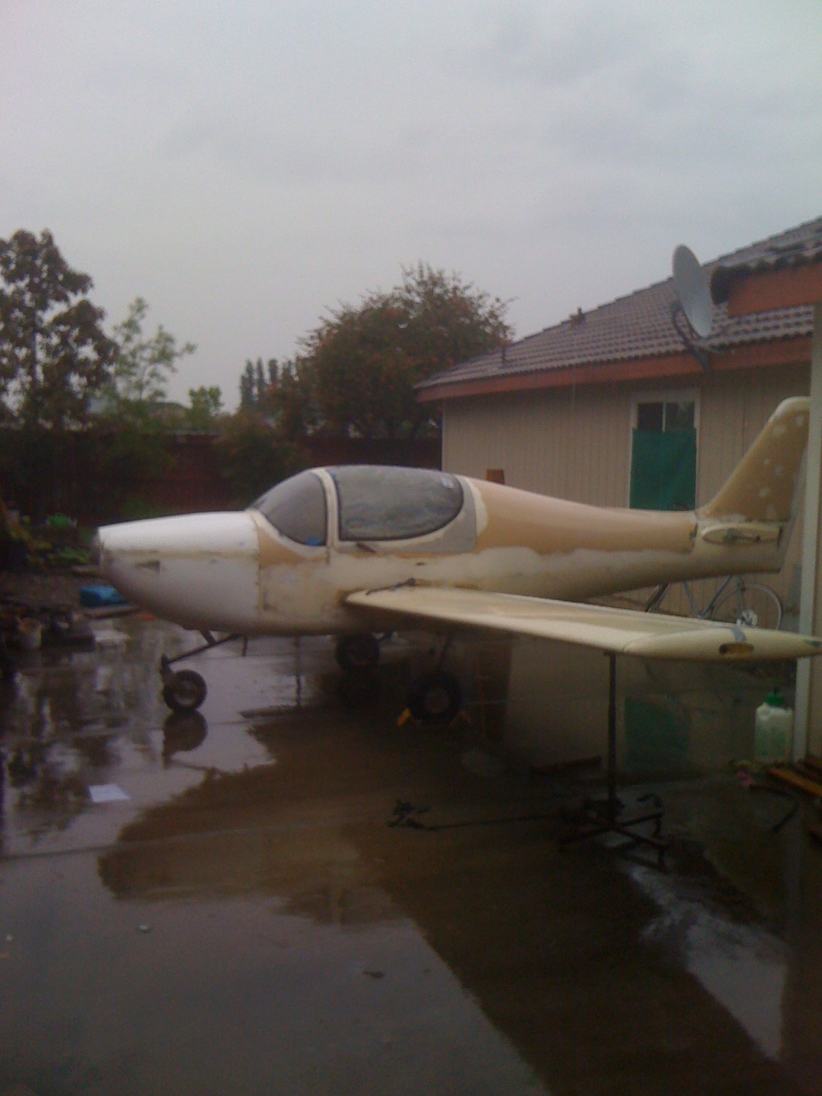

I built a telescoping square brace tubing that attaches to the tie down bolt hole. I have an over center brace that I can take the wings off my dolly and place the spar into the hole in the fuselage. I then lift the wing and straighten it out from the wing tip then slide it into the fuselage. I only have one picture, take in the rain, but can sent the measurements and some pictures. The square tubing is welded to a square legs that have 360 degrees rolls installed. The telescoping inner tube is secured with a Vise Grip pliers on each wing. I have then marked with magic marker and once I have the wings in I telescope the tube to the correct height to install the pins. I have the flap in the down position and work the wing into the fuselage to just before engaging the flaps.
I hope this makes sense. I have put the wings on using this method for the last year by myself.
If you want the pictures e-mail off line
