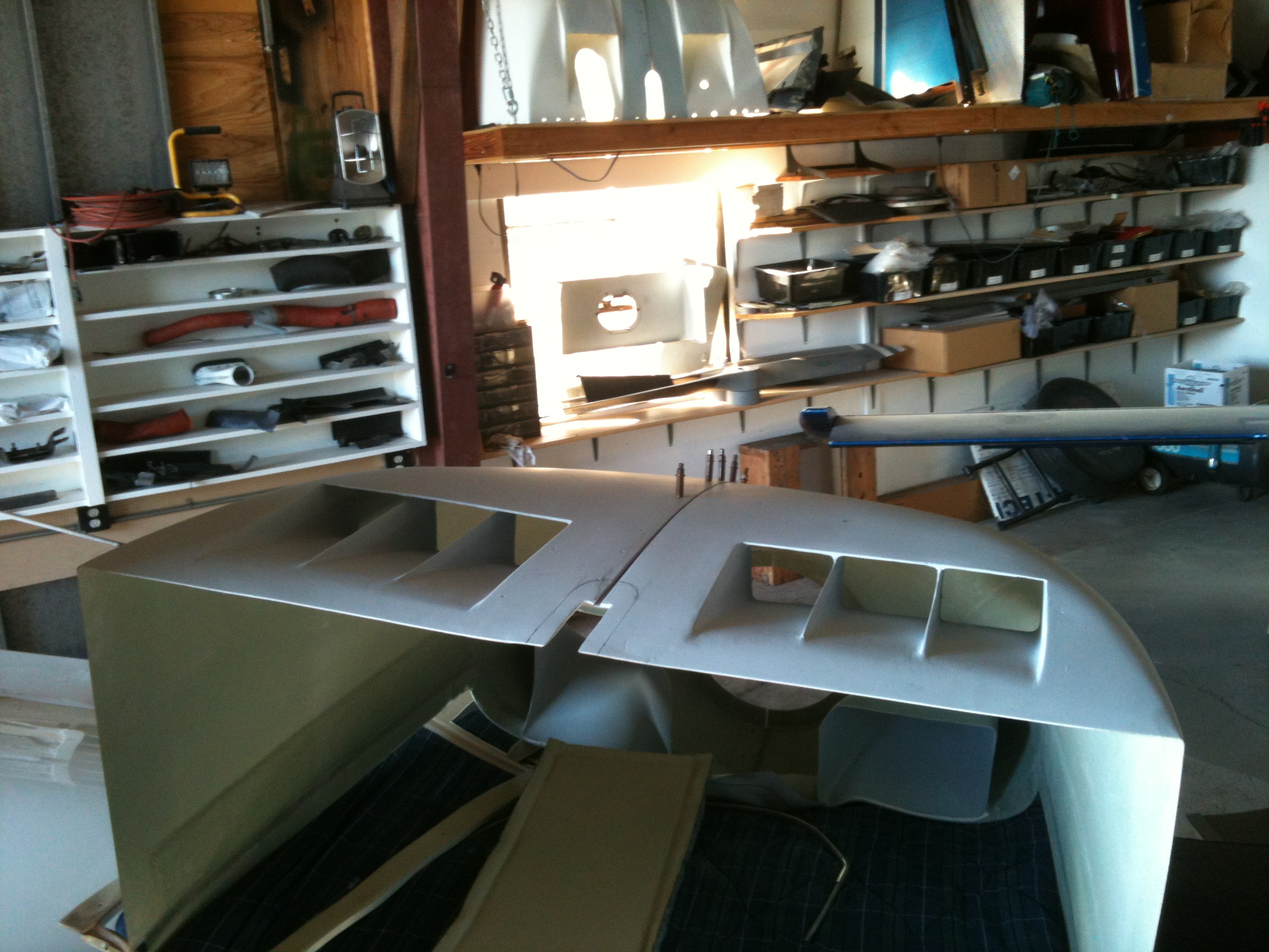

spy photo of special projects

Man I like them ramps.

Gary,
What is that shark gilled mystery?
Bruce

teamgrumman(at)yahoo.com
PostPosted: Wed Nov 30, 2011 12:20 am    Post subject: spy photo of special projects Reply with quote
33% more exit area. Higher exit velocity.
Gary

PostPosted: Wed Nov 30, 2011 11:11 am    Post subject: spy photo of special projects Reply with quote
Gary:
What exhaust were you planning to use?
I guess if you went with the short PF you loose all the fins on one side.
Barry

PostPosted: Wed Nov 30, 2011 5:12 pm    Post subject: spy photo of special projects Reply with quote
Yes, one of the fins will need to be sacrificed on the right side

PostPosted: Sat Dec 24, 2011 8:08 am    Post subject: Re: spy photo of special projects Reply with quote
Gary, so how did the shark gill exits work for cooling?
In the picture it appears there is no pop out from the cowl bottom like
the Jaguar cowl has. They look flat and even with the bottom. Is that correct? I'm curious to know how the cooling compared before / after
Curious about your "new math" that says higher velocity exit air even with increasing exit area 33%??????? The 'vanes' should keep birds out tho.
PostPosted: Sat Dec 24, 2011 9:27 am    Post subject: spy photo of special projects Reply with quote
Haven't flown it yet
