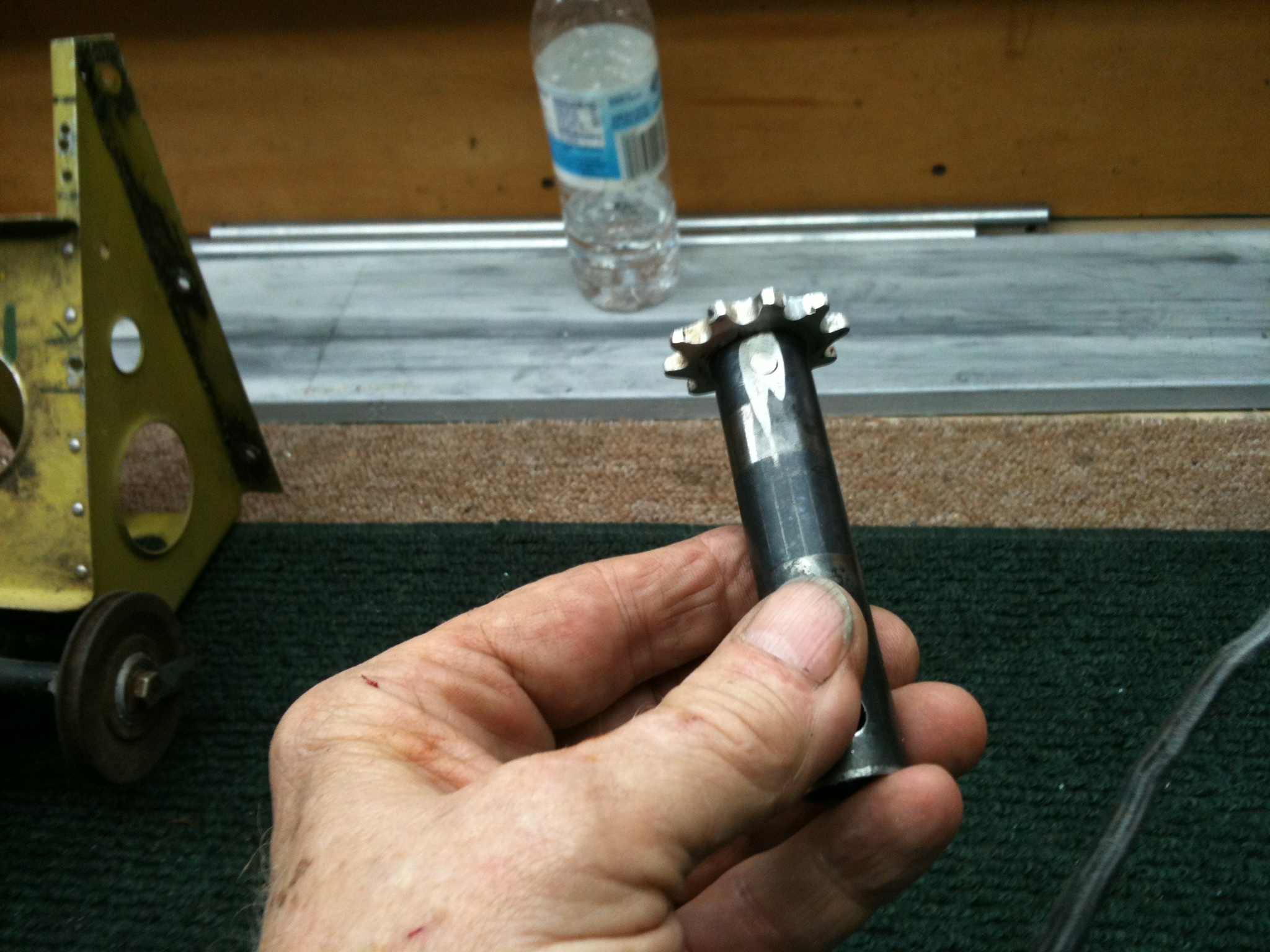

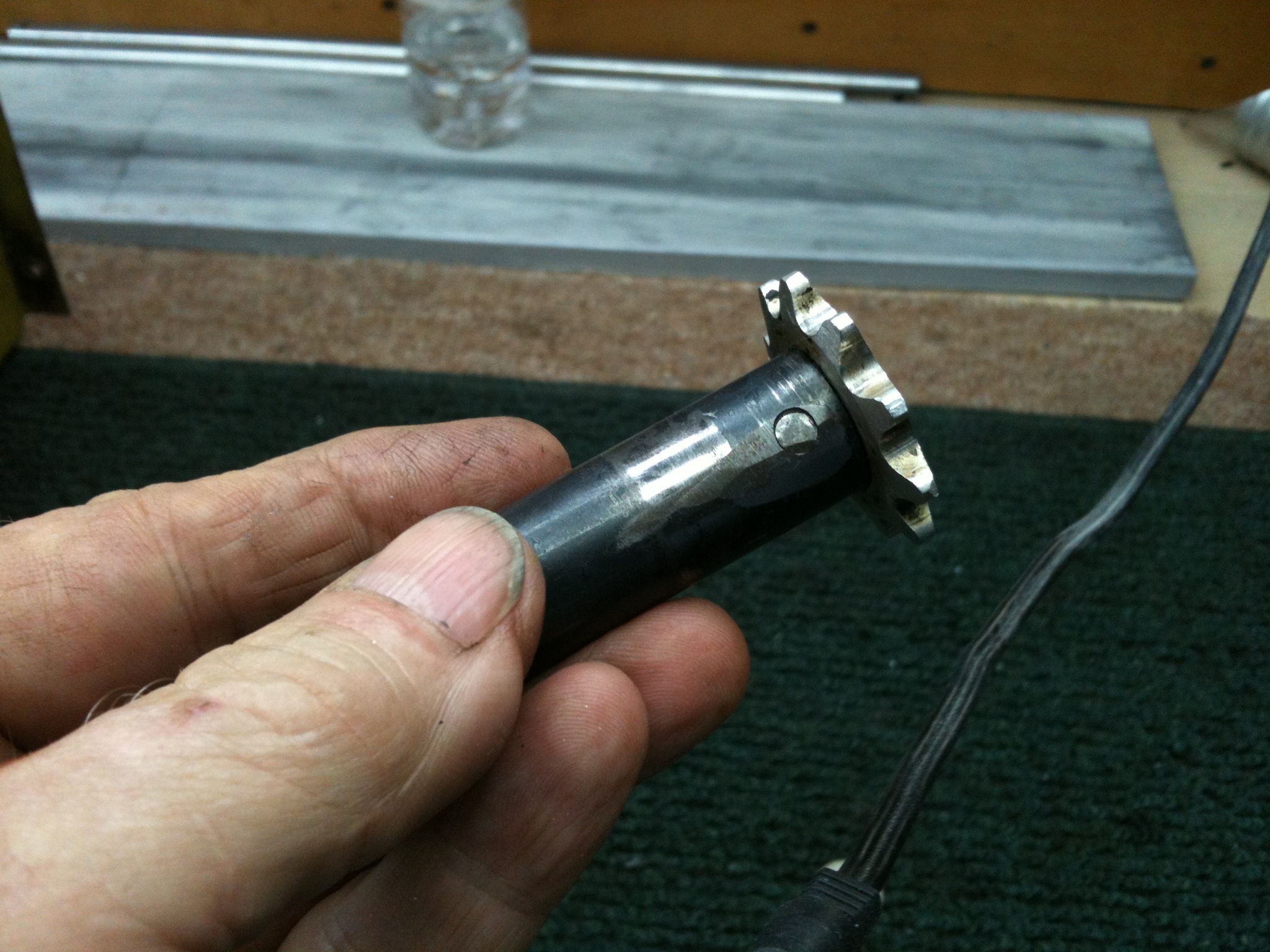

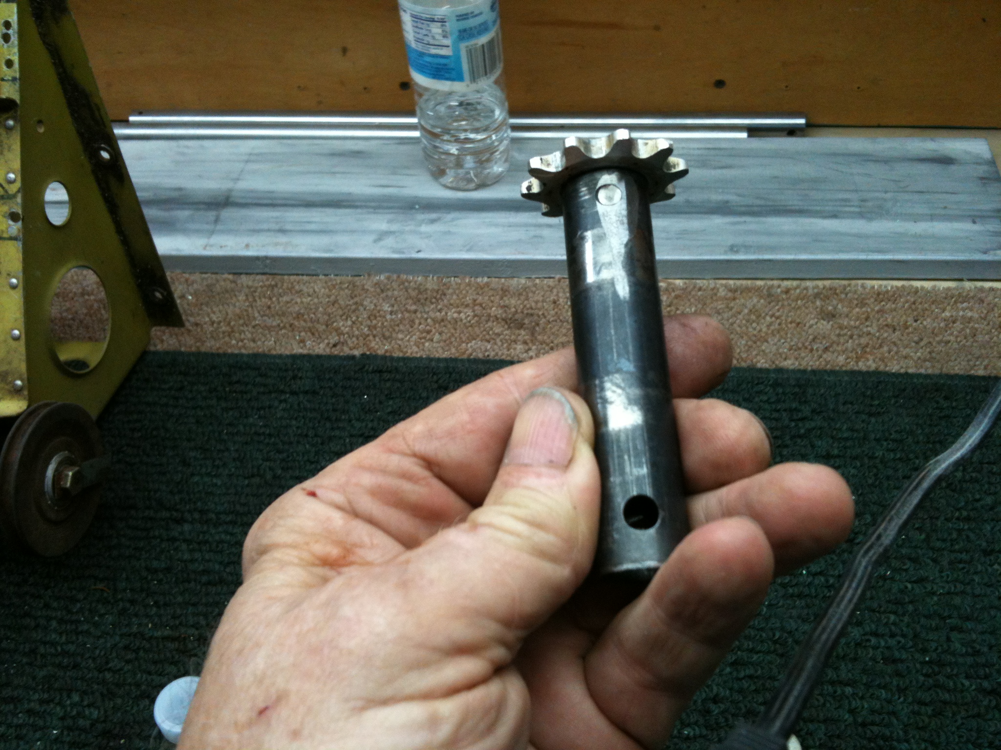

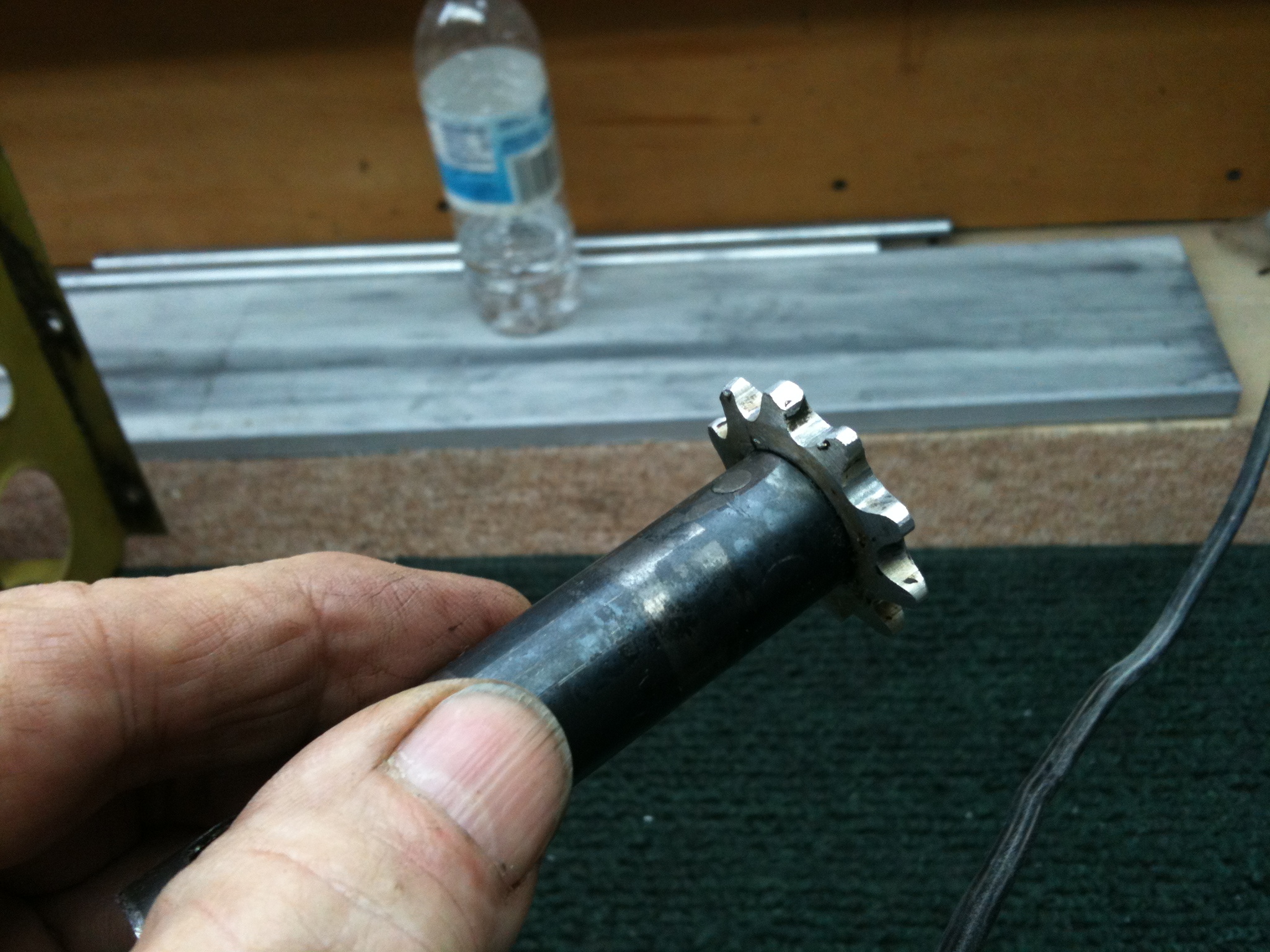

Here is the sprocket and shaft. No entries in the log books for this shaft.  It looks like it had been assembled at the factory with the end of the shaft ground in order to fix an obviously bad pin installation. I didn't remove the pin. I did try to wedge the pin to tighten the sprocket. I wouldn't trust it.
Both universal joints had some play compared to new ones.  The biggest problem was the loose sprocket.

From the photo is looks like the pin doesn't fit the shaft hole on one
side (pretty sloppy work). How is the fit at the opposite end? The pin
must be a press fit in the gear stud that fits inside the shaft, and
maybe in the shaft as well. I'd drive the pin out as maybe the hole in
the gear stub has worn and it is loose inside. You could ream the parts
and have an oversize pin machined on a lathe possibly, or just buy new
parts (less hassle).

The surface on which the roller bearings ride has been ground off. When I got the chain off I tried to turn it without extra drag. It was VERY rough. This entire part should have been scrapped at the factory.
