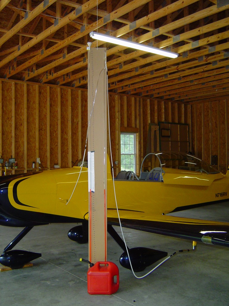

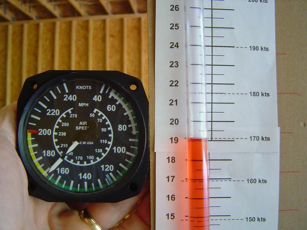

1. It is an easy set up to verify IAS reads properly. Attached photos are
the rig I used. I also attached the scale to translate inches to knots.
There are various placed to find the test rig on the web. You need not take
the airspeed indicator out of the plane, just attached the tube to the pitot
and seal with electrical tape. In the attached rig photo, the pressure
source attaches to the tube that is hanging free on the left. I found an
old blood pressure bulb for this.

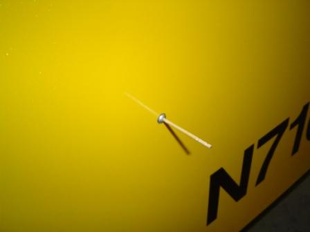

3. When I took the plane down for paint, I installed two of the Cleveland
tool static ports in the standard fuselage locations. These are flush
ports. I found this induced a static error. I did a simple fix by drilling
a 1/16 inch hole in the center of a 3/16 round head rivet, cut the rivet
head off and then epoxied the rivet head over the static port. I used a
toothpick to hold the rivet head in place while the epoxy set, and to keep
the epoxy out the hole. This fix solved the static problem. Photo
attached.
