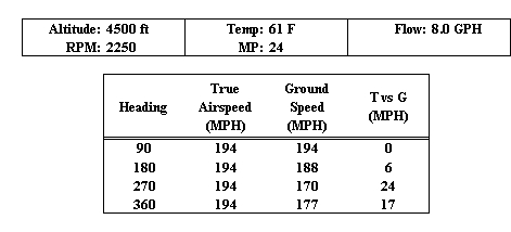

I've been flying the new 10" Dynon Skyview in the RV-6 for a few weeks now and it seems like the airspeed is reading maybe 10mph fast. The GS always reads 10mph or more slower than the True airspeed, no matter which way I fly with respect to the current wind. Looking through the configuration options on the Skyview, I'm not seeing parameters to calibrate the airspeed. If the airspeed were *slow* compared to the GS, I could envision making adjustments to the Pitot tube to get it in better alignment with slipstream. But *fast* is a head scratcher. If there's no electronic configuration parameters to adjust, what do you do? Are there Pitot line "attenuators" like for RF in coax? Wink
Matt
Listers,
I went flying tonight in the RV-6 around sunset and took some airspeed numbers flying the four points of the compass. I let each direction normalize for about 2 minutes before taking the readings. I've still got my little black-tape washer deals on the static ports that I detailed in a previous email.
Do these numbers make any sense?
I set the altimeter to 30.15 (KLVK ATIS). I compared the Dynon altitude with the Garmin 696 GPS altitude. The Dynon was high by 100 ft. I used the Dynon altitude adjustment to set it to match the GPS (-100ft). The readings above were after this adjustment.

You can use either barometric altitude or pressure altitude. GPS
altitude is irrelevant, It is a calculation based on a theoretical
modified sphere, with some WAAS correction, but ATC and all flight rules
are based on barometric altitude. You can derive pressure altitude from
baro and vice versa, but you can't replicate GPS altitude. With a
portable WAAS enabled receiver I see variations of +/- 150 ft at my
home airport in GPS altitude. Yes, it usually is within 50 ft but not
repeatedly. Are you certain the inputs for the Dynon to calculate TAS
from indicated are correct? Is your indicated temp and baro altitude on
the money?
That set of ground speeds computes to 182 TAS
http://www.reacomp.com/true_airspeed/index.html
So your indicated TAS is still 12 kts high.

PostPosted: Thu Dec 29, 2011 11:35 pm    Post subject: Dynon Skyview Airspeed Calibration... Reply with quote
Matt,
What type/shape of static ports do you have? I’m wondering if this is an issue with flush static ports??? Airspeed indicator results/calibration has proven more effective with a static port that protrudes a bit from the edge of the skin.

PostPosted: Fri Dec 30, 2011 9:15 am    Post subject: Re: Dynon Skyview Airspeed Calibration... Reply with quote
Matt,
I'd record the indicated airspeeds as well. Use an E-6B or equivalent to see if the true airspeeds you calculate match the Dynon's. Maybe there's a software error, or an input (temperature, altitude) error there.
Since the speeds look uniformly high, I would just note that a static line leak inside the cabin will usually make the airspeeds read high. Try slightly pressurizing the line with a balloon, see if it leaks.
