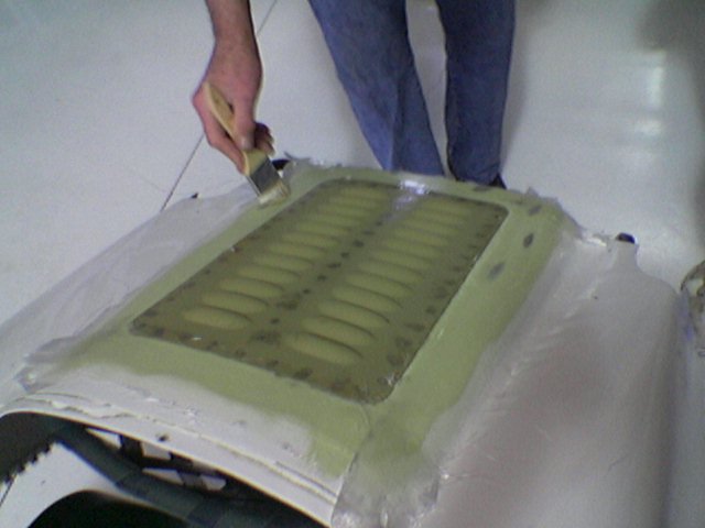

n395v
Joined: 10 Jan 2006 Posts: 450
Posted: Thu Feb 23, 2006 3:19 pm Post subject: Re: NACA cockpit cooling vents |
The following is a series of attachments if you view the bulletin board.
If they are stripped from your e mail version let me know an I will e mail them to you.
#1

n395v
Posted: Thu Feb 23, 2006 3:21 pm Post subject: Re: NACA cockpit cooling vents |
#2 if you need more flow just cut out some of the cross bridges.

n395v
Posted: Thu Feb 23, 2006 3:22 pm Post subject: Re: NACA cockpit cooling vents |
#3

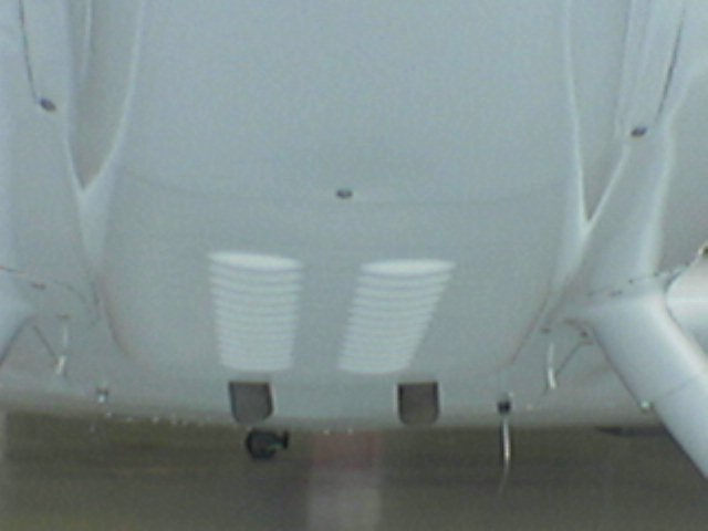

n395v
Posted: Thu Feb 23, 2006 3:24 pm Post subject: Re: NACA cockpit cooling vents |
#5
The finished product
