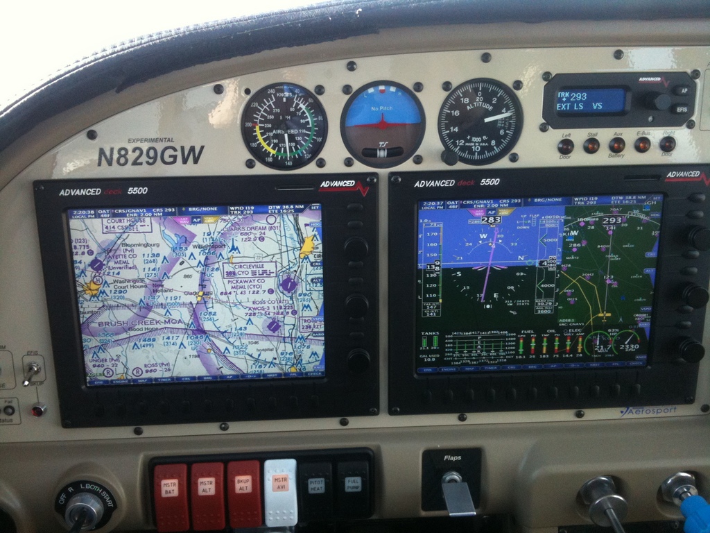

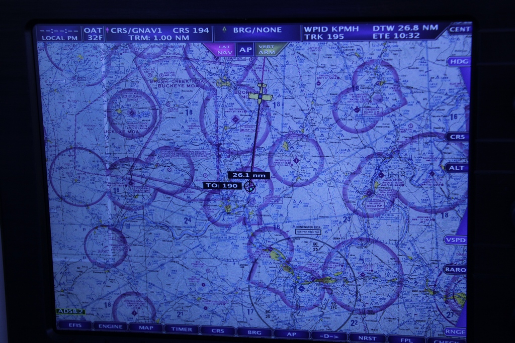

I believe what Wayne is referring to is the VFR sectionals, IFR low en-route
charts/maps and AFD now available
On the New AFS 5600 and 5500 screens. I have been flying these new screens
for 10 hours and they are loaded with features. Attached are some picture of
the VFR sectional on the left screen and the other picture shows the
Rubber band feature move the joy stick to a location on the chart and it
gives you the heading and distance
Pretty cool.
