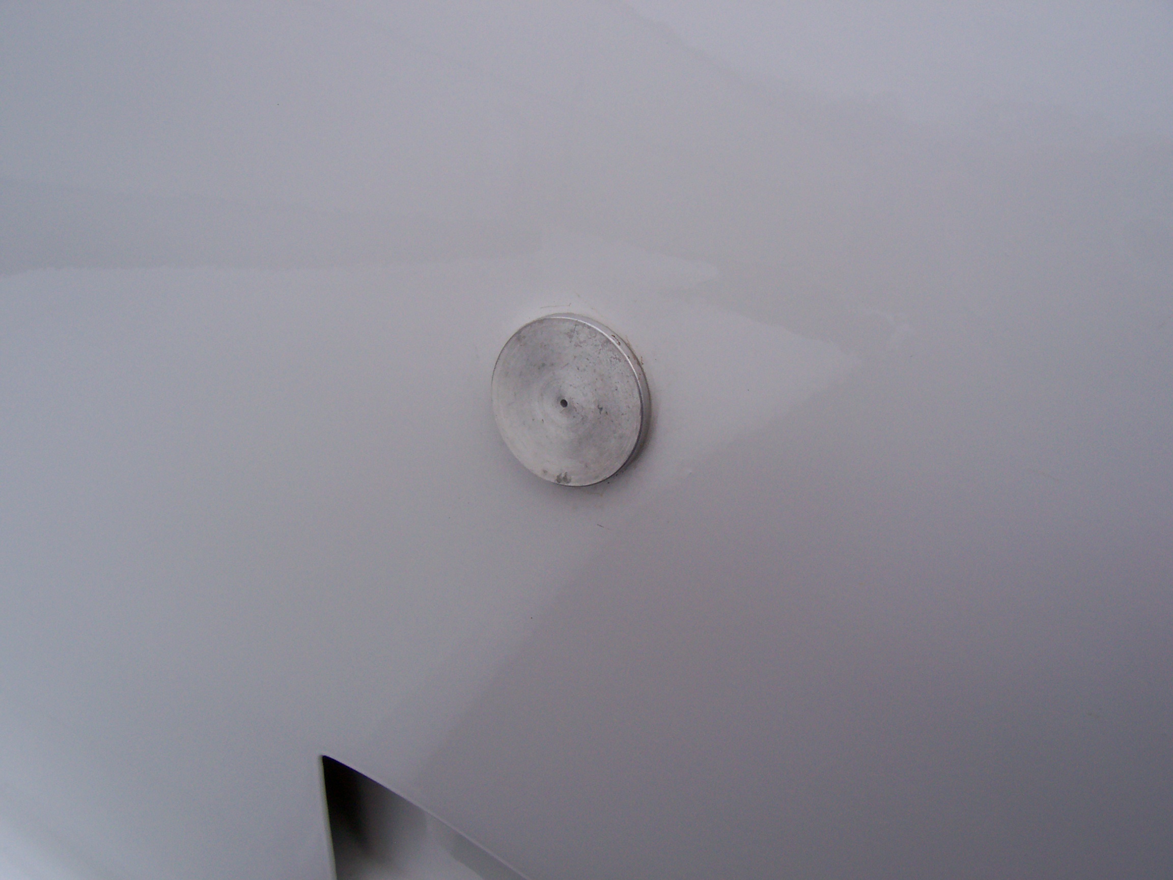

Matt,
Agree with others the symptoms indicate a static problem, specifically the
location is producing a vacuum when moving.
While introducing a "controlled leak" in the pitot side might fix the
airspeed error, probably at only one airspeed, it wouldn't fix the altitude
error also produced by static error.

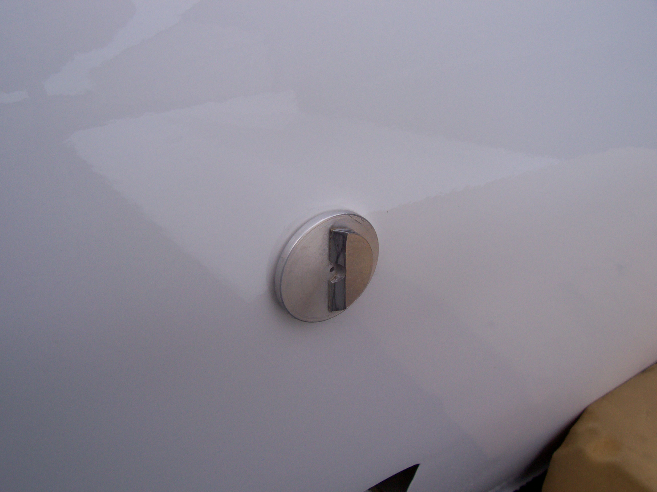

Two very simple things you can do to confirm the problem and start toward a
solution.
First on takeoff set the altimeter to an exact division. Note as you speed
up and rotate if the altitude changes, even a little. Higher altitude
implies dynamic vacuum at the static port(s) which will produce the effect
you describe, lower altitude means dynamic pressure.
As a test, tape a wedge, or even a block such as a short piece or two of
tongue depressor, behind the port(s). If your error decreases you are on
the right track and set for a little cut and try with wedge size and
placement. Before starting be sure to have accurate error measurements.
Use the spreadsheet mentioned by others to get wind independent actual true
airspeeds. Or you are welcome to the spreadsheet I developed from the same
formula with 4 leg input. The 4th leg provides redundant information to
indicate the quality of the input data.

Matt, I've got a couple of thoughts: The pitot / static system depends on
the static port being true ambient pressure, which is actually pretty
difficult to achieve in airflow. If you've got the port(s) in a spot that
generates a slight positive pressure on the static side you will
de-calibrate the airspeed to the low side, if there's negative pressure at
the port airspeed will read high. On the C172SP I rent there's a 1/8" high
lip on the fitting right beside the static hole. As the lip is at an angle
to airflow, I presume they dial in the static system by rotating the fitting
so the angle gives the correct pressure at the port for a specific speed
range. I've read somewhere (perhaps the Bingelis books) about making
adjustments to the static port by laying strips of tape in front of or
behind the port. As an example, the area in front of the windshield on a
stock car is a high pressure area where they take the induction to the
engine, I would suggest laying down a few thicknesses of tape behind the
port to start. Then again if your port is in an area of laminar flow,
tripping the flow in front of the port may have the same effect.
I believe once you have a modification that works you can make a permanent
'fix' that would be more efficient than a bleed port in the line.
Hope this helps.

Hello Matt, Attached are pictures of the two static ports on the foward
fuselage sides of my KIS TR-1:
0599 is the plain static port on the right side of the fuselage.
0602 is the same basic static port on the left side of the fuselage, but
with a self made aluminum wedge installed on it.
Since the wedge is installed aft of the opening in the static port it has
the effect of slightly increasing the static pressure that this port is
sensing and sending to the rest of the static portion of the pitot static
system. This slight increase in static pressure, in the airspeed indicator,
balances out or reduces the effective force being applied to the indicator
by the air pressure coming in from the pitot tube. The result is that the
airspeed indicator indicates a slightly lower airspeed than it would without
the wedge.
A wedge applied before the static port opening would have the opposite
effect.
Plan on doing a lot of test flying to get your wedge(s) fine tuned to
accomplish what you want in the way of airspeed reading without
significantly adversely affecting your altimeter readings.
My thinking is that it is more important to have the airspeed reading what
it should be in the approach speed arena rather than the cruise speed arena.
