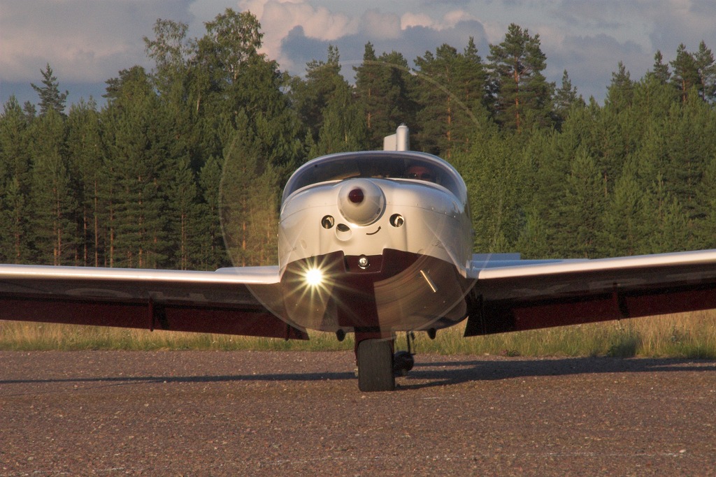

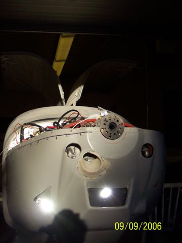

Hi Graeme,
I opened it also and installed there a taxi light (HID Xenon – check an attachment).
Now if you some day decide to go for 914 you have much less to do!
No reason for panic!
Cheers, Raimo Toivio
[img]cid:04859F088860451ABA8E4E5E431E287C(at)Asus[/img]
