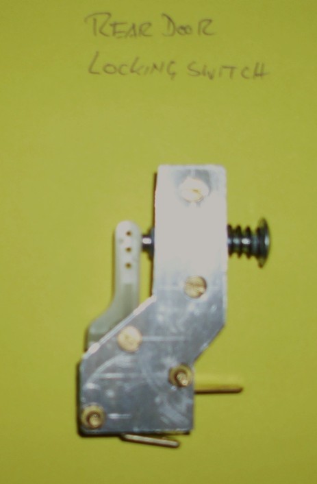

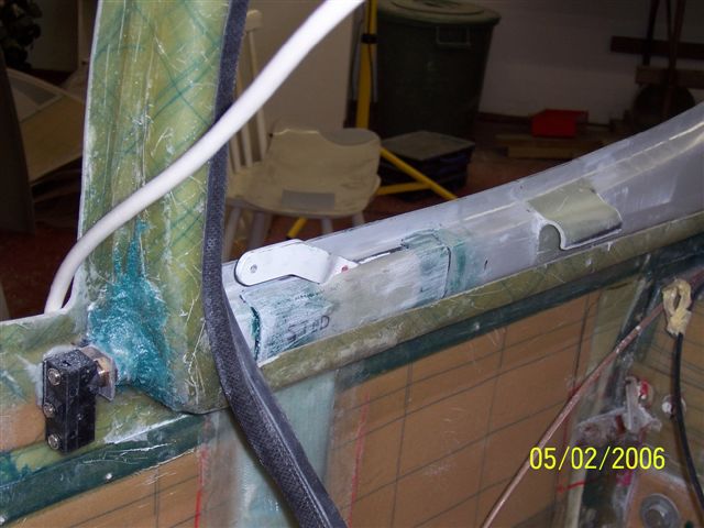

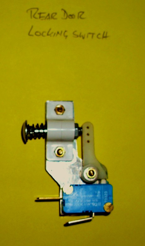

The best protection for this is to built in an advice. I will install in springtime two micro switches mounted on an aluminium plate together with a common carriage bolt (Schloßschraube).
Please see attached pictures (just made for you). You have to make one mirror inverted (spiegelverkehrt). The switch-bolt arrangement weights 35 gramm each.
In my panel I have fitted two small green LED lights and the micro switches are openers. When the door is correctly closed, the LED will go out.

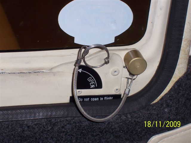

I elected to make a system which have two serial connected micro switches per door. When they are BOTH IN I have a green led. When I have two green leds I am pretty sure my doors are firmly closed.
Otherwice, they are open OR system is somehow broken. Two Greens = The System is operational = The Doors are closed.
Maybe you would like to have red lights (when doors are open) instead of greens or change MS´s to be NO (normally open [when doors are open]) as I have them.
I promise what more you see green lights when flying that happier you will be (there are possibilities to have masses of green)!
Notice also my extra safety: there is also a pip-pin to prevent an unwanted inflight door opening.
