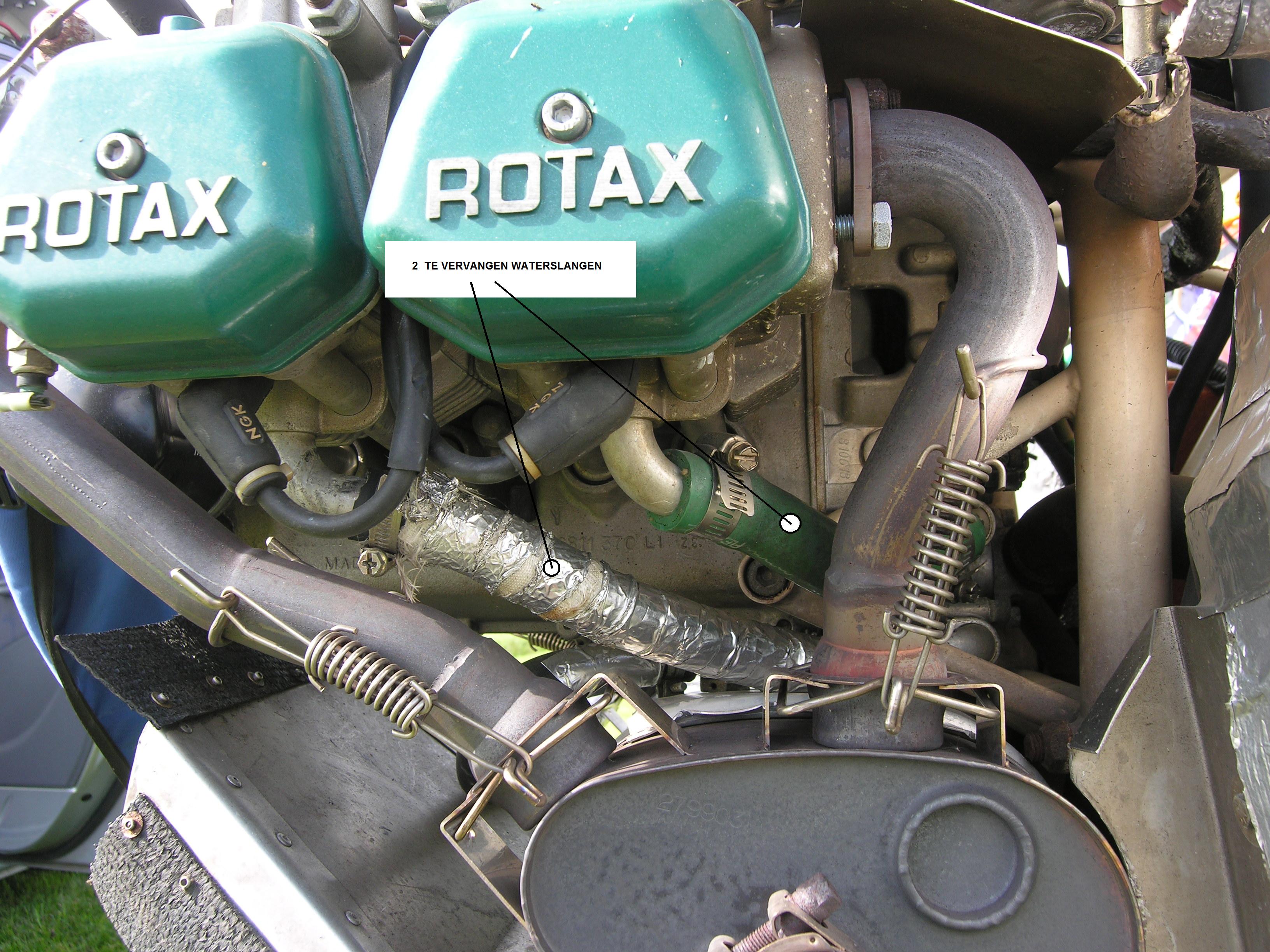

Hi all,
This is about a Europa XS with the 912S and the oval exhaust silencer.
2 years ago I had a burned coolant hose (to cylinder 2) because the hose runs too close over the exhaust. This was a very scaring experience because it happened just after take-off at low altitude. So the replacement was well protected with heat shielding. But doing so makes the o.d. larger and therefor the heatshielded hose is actually quite heavily pressing on the silencer.
Now I like to solve this properly and I plan to cut the 2 rear downstacks to allongate them by 1-2 cm. But before doing so I would like to know if others recognizes this lack of space too. I hardly can imagine that my Europa is the only one with this problem, but I could not find a topic about it in this forum. So any suggestions how others have solved it, or reasons why not to cut the rear stacks are most welcome.

Hi Ivor,
Thanks for your reply. I have just mounted a shielded silicon hose so that is done. But I just don't like a hose pressing on the silencer so I want to create at least some clearence. At the moment the silencer is even a littlebit pushed down so there is some leakage of exhaust gas here. This is because the new hoseprotection is a bit thicker than I have used before.
I still wonder if I am the only one with this problem or ar my downpipes wrong manufactured?
Kees de Bussy
PH-SBR

<?xml:namespace prefix="v" /><?xml:namespace prefix="o" /><![endif]--> Kees,
I have had good success by changing the 90 degree angle socket which comes out of the water pump and runs the lower #2 cylinder hose very close to the muffler) to a 45 degree as on the 914 setup. This is a tight fit as both cylinder coolant hoses will run through that tiny V in the engine support, and will require patience and good practices to accomplish as most of us 914 owners have found. The best way to describe the move is to simply look at a 914. The socket tubes that are on the water pump are held in with green Loctite and with care and heat, come off. The threads are very fine so use modest heat from a torch until too hot to touch, continue the heat (about 600F) until the tube begins to unscrew. Turn the #4 cylinder pipe, to allow the #2 to unscrew and remove both. Heat while you unscrew and all works out. Clean and reapply Loctite IAW the Rotax manual. The Loctite sets up fast, so dry run and mark where the tubes should be before you glue them in place. Carefully refit the water pump, gaskets and O rings and this setup will last years.
On one aircraft I found an owner which put a straight nipple on the water pump and ran a longer hose which worked fine also. Parts are available through your Rotax Dealer.
We order our engines here with the ring mount attached and the tubes changed by the Rotax dealer. Normally this is done for no charge. On engines where the owner bought the ring mount separately we do the mod in house.
At Custom Flight we have done this mod to all our 912S models with great success and hose longevity. The new silicone hoses do hold up quite well if you decide to upgrade, but I would still cover my lower coolant hoses with heat shield. I use Thermotec brand, but any silvered heat shielding tube will work...

Hi Bud,
Thanks for your input. I have been thinking about this solution too. A straight socket however will interfere with the engine-mount. A 45 degree one will probably do the job. But because everything is mounted, all hoses have just been replaced I guess at this point it is easier to make the downpipes a little longer. A second advantage is that at the same time the oil hose at the bottom of the engine gets more clearance too.
Is there anything against making the downpipes a little longer ?
By the way my Europa, serial #A168 is the former N-303AU. So maybe you know the kit and builder.
Kees de Bussy
budyerly(at)msn.com
PostPosted: Wed Feb 22, 2012 2:29 pm    Post subject: Lack of space between exhaust and coolant hose. Reply with quote
<?xml:namespace prefix="v" /><?xml:namespace prefix="o" /><![endif]--> I don't blame you, I do know that any hose within 1/2 inch with heat shield of the muffler doesn't last more than a few years without some air blowing on it. Even a short hose and a nippled metal extension will work for a longer down pipe. It just takes time.
