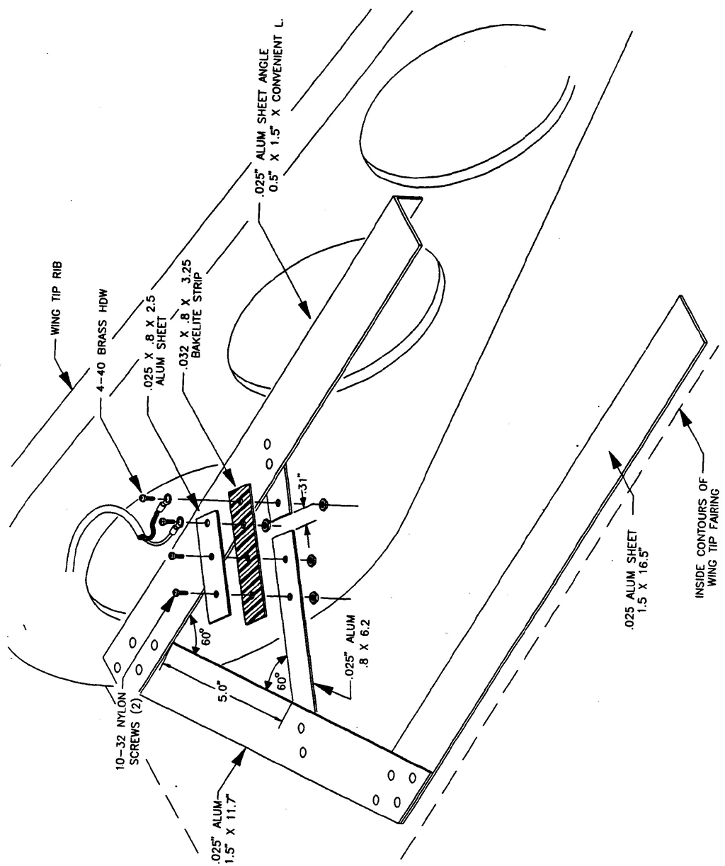

Hi Alfio
I am planning on doing the same do you have a drawing with the required dimensions on.The drawing I have dose not have the dimensions.
Here's the data as published by Van's Air Force many moons
ago.
[img]cid:7.1.0.9.0.20120318154627.01dfa198(at)aeroelectric.com.0[/img]
 Filesize:  319.42 KB
 Viewed:  1244164 Time(s)
wynaire(at)citlink.net

PostPosted: Mon Mar 19, 2012 12:02 pm    Post subject: wingtip vor antenna Reply with quote
cheers mike and bob
Dose the L angle length have any affect on reception as it just says convenient on the drawing.
Mark

PostPosted: Mon Mar 19, 2012 4:39 pm    Post subject: wingtip vor antenna Reply with quote
At 02:58 PM 3/19/2012, you wrote:
cheers mike and bob
Mark
That piece is a mounting bracket that fastens
the antenna to the tip-rib. It's dimensions have
no appreciable effect on performance as long as
all other dimensions are not altered.
PostPosted: Mon Mar 19, 2012 4:46 pm    Post subject: wingtip vor antenna Reply with quote
cheers mike and bob
Mark
Beautiful 3 Bedroom 2 Bathroom villa to rent in Orlando, Florida
http://www.obeo.com/Public/Viewer/Default.aspx?ID=321207
Check out our virtual tour
01582 529820 Emma and Mark Harris
From: wynaire(at)citlink.net
Subject: Re: Re: wingtip vor antenna
Date: Sun, 18 Mar 2012 15:44:35 -0600
Bob,
Thanks for the Sunday surprise (VOR antenna diagram). Looks like I may be building "a spare VOR ant" for the Lancair, as well.
What does the tip-rib look like? Keep in mind that the
Bob Archer VOR wing tip VOR antenna was designed for
RV's . . . aluminum wing with aluminum tip rib . . .
and a Fiberglas tip cover.
The antenna is a highly distorted, quarter-wave radiator
with a gamma-match feed line attachment. The quarter-wave
antenna needs to work against a substantial RF ground. When
the antenna is up in the air, ground is provided by a suite
of "radials". On an airplane, the 1/4 wave comm antenna is
grounded against structure or the aircraft's skin.
If the proposed installation is not onto an aluminum airplane,
the antenna's performance versus that which has been demonstrated
on RV's (and other metal airplanes) is degraded. Too much? Don't
know without trying it. But if it's a 'spare', maybe performance
isn't a big issue. Just be aware that it WILL be different . . .
your in-flight observations (perhaps being able to quickly switch
between antennas) would be VERY interesting.

PostPosted: Mon Mar 19, 2012 8:48 pm    Post subject: wingtip vor antenna Reply with quote
At 08:00 PM 3/19/2012, you wrote:
Bob,
Do you have dimensions for an Archer-style comm antenna for composite planes?
Jim
No. In fact, the dimensions for RV wing tip VOR antenna were
published in Vans Airforce newsletter. But from the description
I deduce that it's the same design as the VOR except trimmed
for the higher frequency. It' wouldn't be hard to craft one.
Of course, it's still primarily horizontal antenna but certainly
would perform better than a rubber duck in the cockpit on a
hand held. Just shorten the length values by 11% to get you
into the Comm frequency range.

PostPosted: Sat Mar 24, 2012 10:32 am    Post subject: wingtip vor antenna Reply with quote
Hi Bob
Just another quick question I fabricated the parts for the VOR antenna today.is it ok to alocrom the parts before assembly and then would paint etch prime be ok ,I would bear the connection points.
Mark
