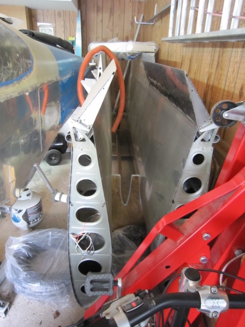

Bill: The attached photo shows my wing cradle (sorry for the clutter in front; a challenge of building in a garage). It was made from wood scraps. Plywood cut to leading-edge curves, with the two wings bottom out, and a slot in the center for the horizontal stab. Cutouts lined with felt strips. (Some have made carpet slings instead of using plywood.) Another ply piece at the bottom to keep things squared up, with casters underneath. Then joined by a 2 x 4 to put them about 8' apart, plus a diagonal brace to keep the vertical ply straight up.
With the 4" casters, it has been rolled two blocks away to another garage for storage when I was moving. Also made it easy to roll up onto a trailer for moving.

Thanks Phil. Those are a lot like my stands. I realize now i wasn't clear. I meant vertically in the longest dimension, so standing up on the spar join end to minimize floor space.
