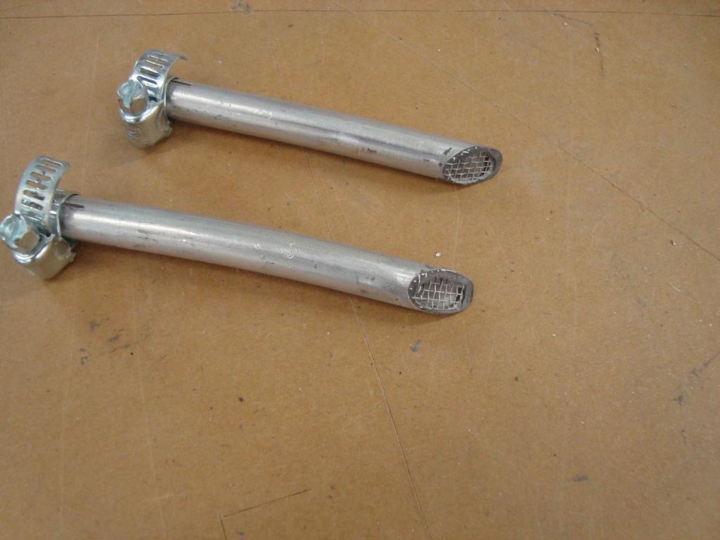

Here is a simple way to keep mud-dabbers from clogging your fuel vent. I think more than one RV has collapsed a fuel tank from a clogged vent.
Take a few inches of 3/8” aluminum tubing, cut one end at 45 degrees or so, then JB Weld on a piece of aluminum window screen material. Once the JB Weld is cured, clean up the edge on a ScotchBrite wheel or similar. Do a ¾” cut in the other end for a hose clamp, then slide this over the now somewhat shortened standard ¼” vent tubing. Have the ¼” tubing extend well past where the clamp goes.

An alternate method: flare the end of the tube, cut a circular patch of flexible fiberglass screening and make radial cuts leaving center ¼” uncut. The cuts will allow you to wrap the screen around the tube overlapping the cut pieces. Secure the screen with a piece of shrink tubing.
Easy to do, lasts a long time (2 years so far on my - but can be easily replaced if necessary.
