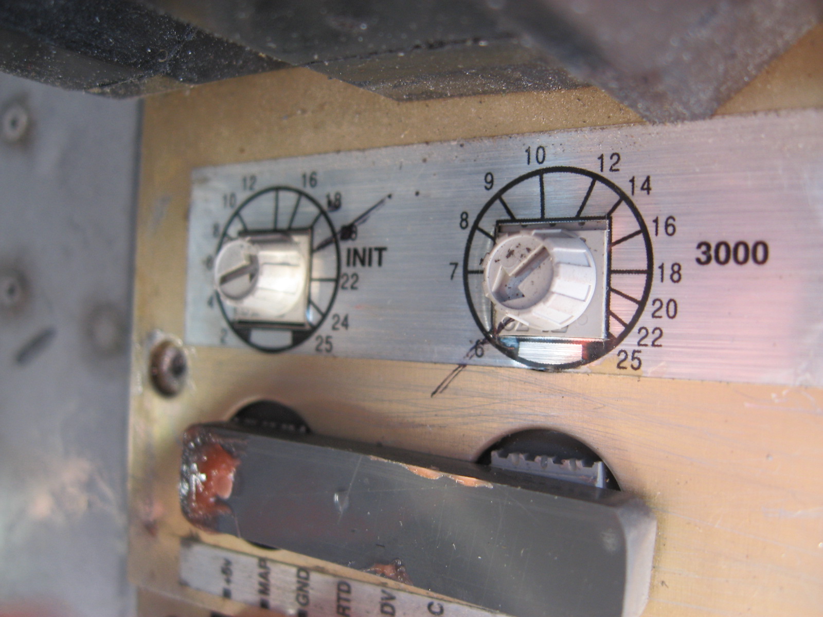

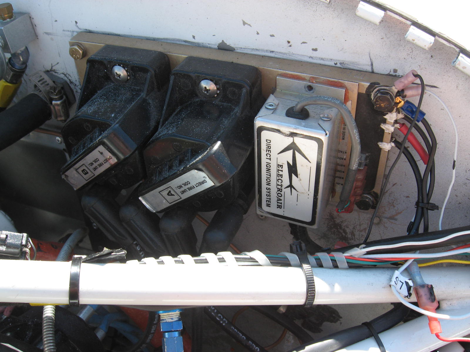

Here are pictures of the 'silver' box (aluminum).  The newer certified units must have changed to black.  See picture # 001

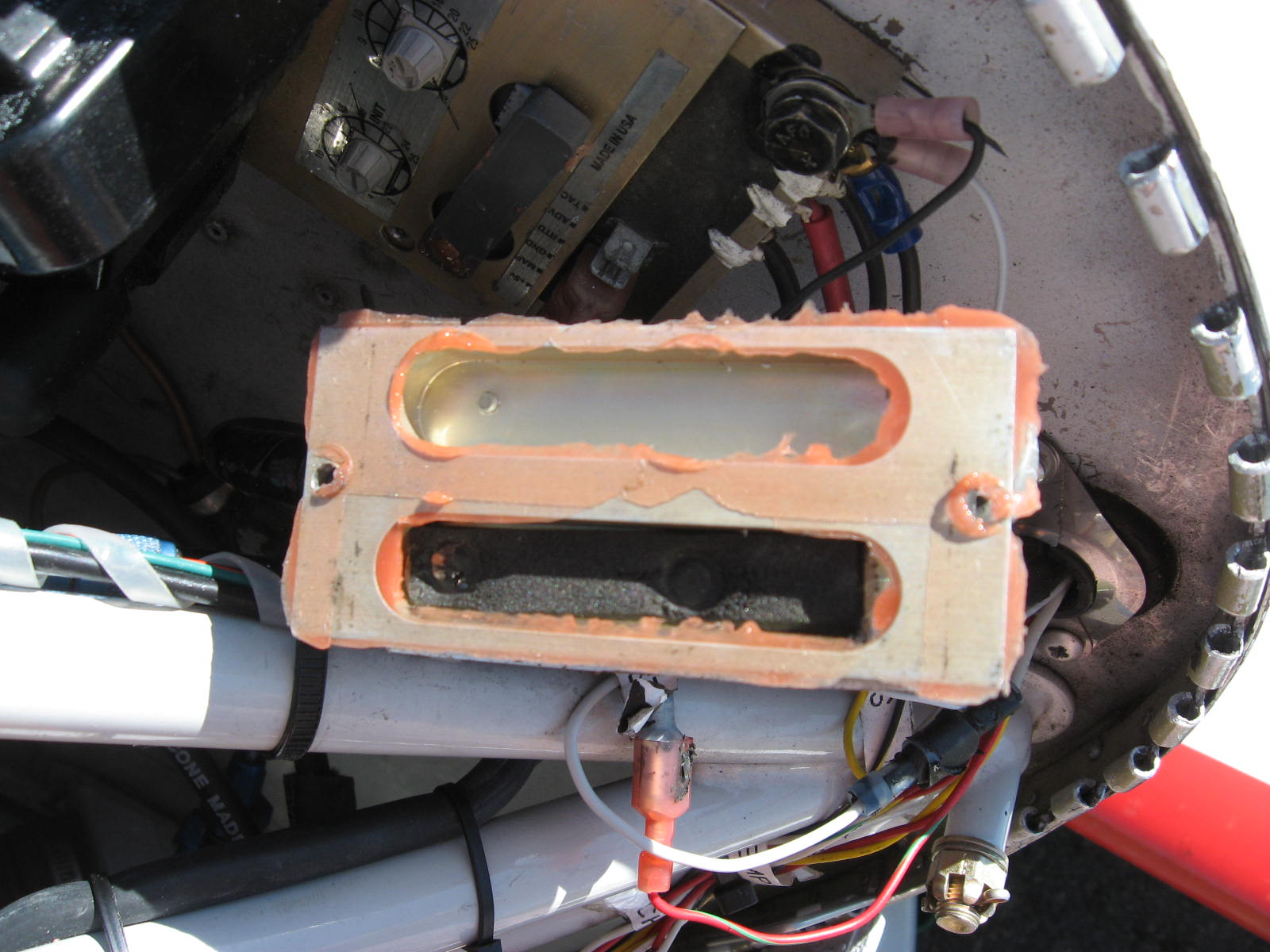

As I mentioned, under the box are the two adjustments.  But, before you go there look at the underside of the box.
You will notice two slots, one of the slots has a foam rubber insert.
This inset presses up against the adjustments and is used to hold them from moving.  See picture # 010 & 011

[Barry] - See above - These are the adjustments.  They are also called out in the manual. See picture # 010 & 011
• There is nothing to rub or wear out.
[Barry] – Well that is dependent on if you want to consider vibration on the adjustments.
And that is why the rubber presses against the two adjustment knobs.  See picture# 010 & 011
