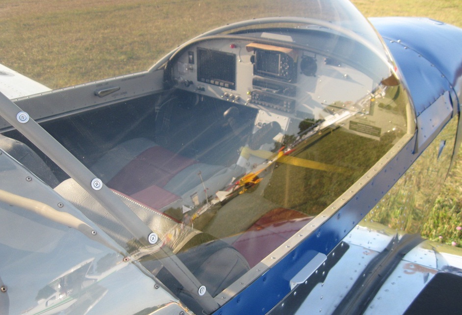

I don't tie my 601XL down very much outside, but when I do, such as at Oshkosh, I use a ratchet strap. It hooks from one rudder pedal on the right to another on the left with a loop around my center control stick. It is a little clumsy to put on, but I only do it once in a great while, so I don't mind it. The only picture I could find was one I took a Oshkosh, but it only shows where it loops around the stick.
Good luck,
 Filesize:  182.43 KB
 Viewed:  11391 Time(s)
David Gallagher
Cincinnati, OH area

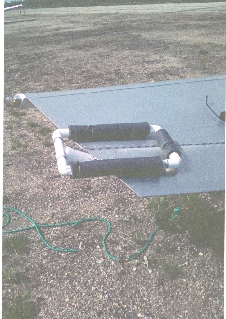

wood23(at)sasktel.net
PostPosted: Tue May 22, 2012 10:24 am    Post subject: flight surfaces control lock Reply with quote
I suffered considerable damage to ailerons and rudder last summer when a 70 mph wind caught my plane from behind. The rudder damage was probably caused due to the tail tie down pulling out. I had been using the bungee cord control stick tie down method for a number of years but the wind from behind shredded the aileron at the control horn on both sides.
The control surfaces have been rebuilt and as the aircraft is tied down out side I wanted a gust lock that didn’t put a load on the aileron at the control horn. My solution was to make a frame from PVC pipe that fits into the gap at the wing tip. I tried attaching a photo, hope you can see it. Another PVC pipe gust lock is attached to the elevator.
For the rudder I’m relying on ratchet straps and better ground stakes.
If anybody's interested I can get more pictures of the gust locks next time out to the airport.
Ron Wood
C-FJFH CH 601 HDS
Stratus Subaru
 Filesize:  330.64 KB
 Viewed:  11380 Time(s)

<?xml:namespace prefix="v" /><?xml:namespace prefix="o" /><![endif]--> I'd be very concerned about wedging something in the space under the aileron as a gust lock. I've seen people use two flat pieces of wood, 6 to 8 inches long, with a non-skid facing, at top and bottom of the aileron-flap gap, holding it all together with a threaded rod and a couple of wing nuts. It comes apart quickly, and stows in a small bag.
Paul R
