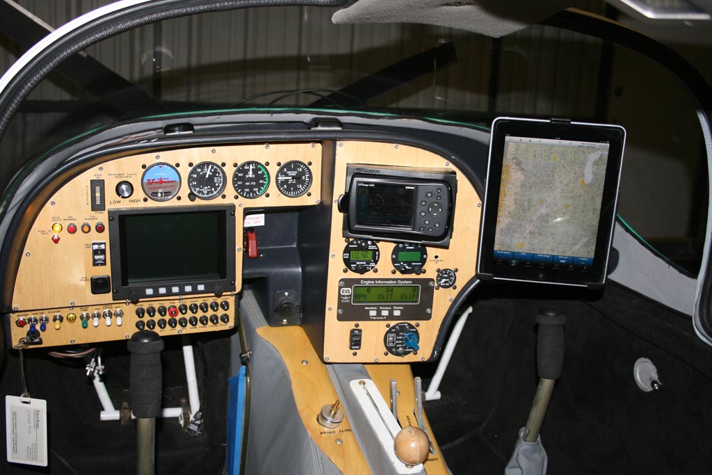

Steve,
FWIW:
Main panel, top row, left to right: Trim Indicator, EL Instrument Lighting control, 4 stand-by instruments; TruTrak Turn Coordinator, Altitude, Airspeed, Vertical Speed.
Row of lights, left to right: Hi/Lo Volt Warn (Yellow), EIS Warn (Red), 2 turbo warn lights (Orange & Red)
Just below the Volt Warn lamp is the press-to-test for the volt warn system.
Big screen is a Grand Rapids Technology Sport EFIS. To the left of the Sport is a USB port feeding the Sport. And an On/Off switch for the Sport as required by GRT.
Switch & Fuse panel, left to right: Master Switch (Red), A & B Ignition (Blue), Starter (Yellow), Starter Engaged Lamp (Yellow), Fuel Boost Pump (Green), Nav Lights (White), Strobes (White) & Instrument Lights (White). Then two rows of circuit breakers. The breaker with the Red Ring is for the trim. There is also a keyed switch that prevents anything working.
Recess between the panels: TCU Emergency Off Switch - Red Guard in the ON position & a 12 volt DC outlet.
Right panel, top to bottom: Air Gizmo mount & Garmin 396, Microair 760 Radio and Microair Transponder, GRT EIS 4000 for Rotax, UMA Differential Pressure Gage, Controls for the Airmaster Prop.
On top of the instrument panel are GPS antennas for the GRT Sport and the 396. Behind the iPad mount, in the corner of the shelf, is the XM Weather Antenna/Receiver for the 396.
I have not flown with this panel yet. Still trying to get the 914 running properly after a year of down time.

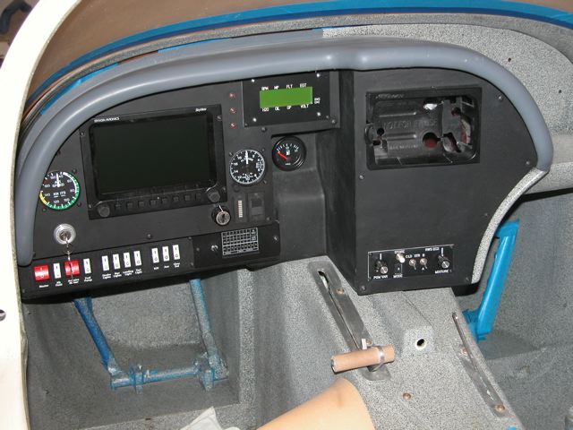

Steve,
Photo below shows my effort to KIS and visually serene...still a work
in progress...instruments include the Dynon Skyview, UMA 2.25 ALT and
ASI backups, Gizmo for Garmin X96; small green screen is EMS
compatible w/ programmable ECU; space for ICOM 210 & xponder. I
extended the valence over the nav panel in an effort to enhance
visability of GPS screen; increased the size of the lip to conceal a
36" length of red LEDs for panel illumination.
Am considering mounting an iPad directly on the top of the control
stick...LOL...

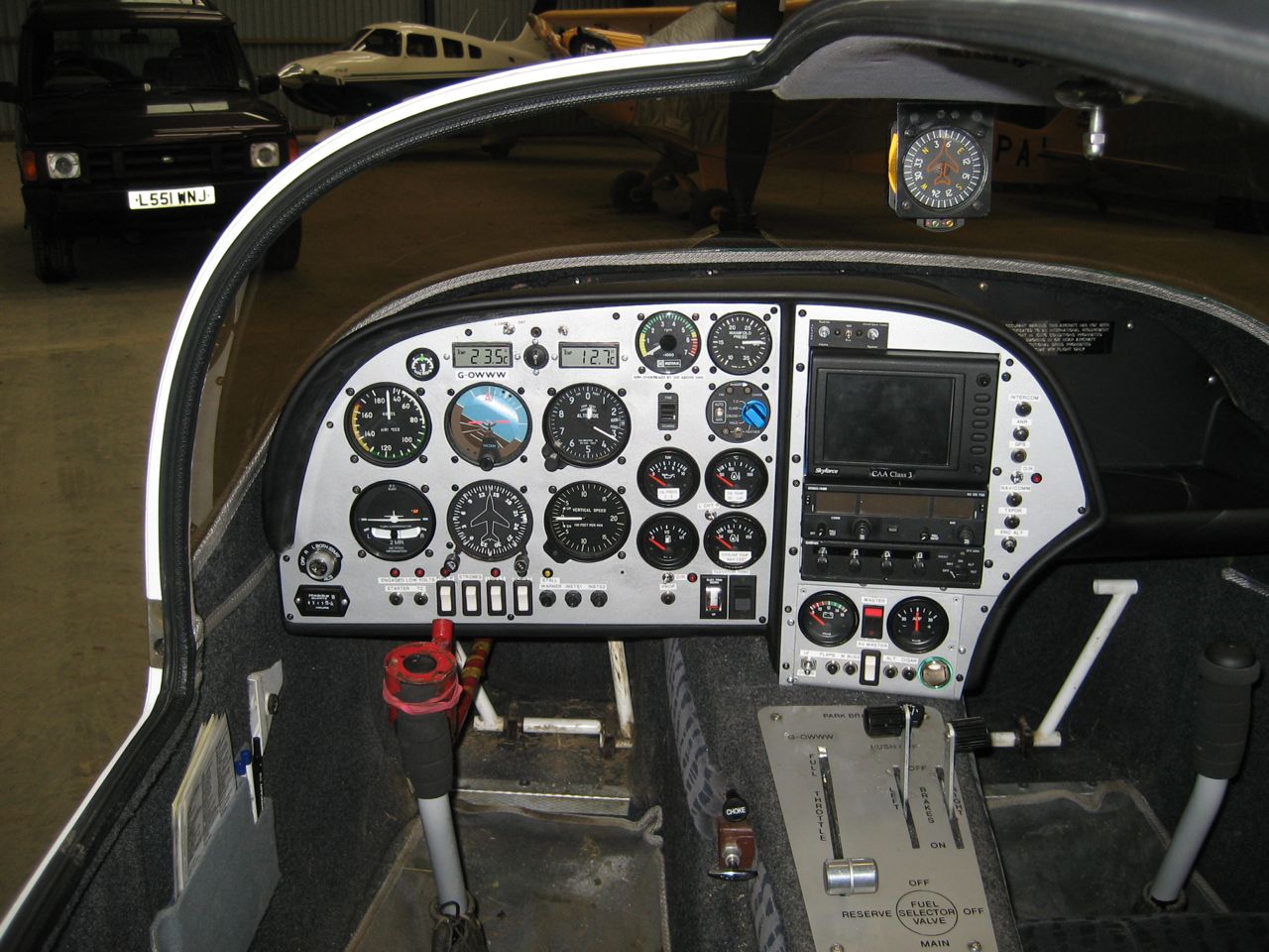

This "old thing" on G-OWWW, does me, for now !
The ammeter and voltmeter sit on a sub panel which stays
in the aircraft when the panel is slid out. The space
neatly avoids the brake and throttle levers.
Richard

Hi Richard
Thx. for sharing your panel with us.
Can you explain or show a shot of the other side of the red rubber band and steel? I imagine it clamps somehow onto the rudder pedals.
Another question, what is the T handle for by the choke? If not a parking brake can you explain your plumbing and routing of air.
Last question, it looks like you have some kind of paint protector for the door shoot bolt hole (port front). How does it work, what did you use?
Thx.

The red rubber band and steel is the control lock. The
other side goes to a "T-piece" that is goes into the
rudder pedals. It actually slides into the hollow pedals
(from between them) The red rubber bands are there as the
cylindrical shape isn't quite aligned with the top of the
stick so helps to keep it in place. UK residents will
recognise the red rubber bands as Royal Mail issue Smile
(Previously enjoyed)
The T handle is for my cowl flap which is behind the
radiators - blanking off the space when it is cold. When
pulled the shaft is marked with green and yellow and red
bands.
Parking brake is in front of the brake levers.
It is a piece of something (I didn't build that bit) maybe
SS, which provides an accurate hole for the shoot bolt and
protects the surrounding fibreglass.

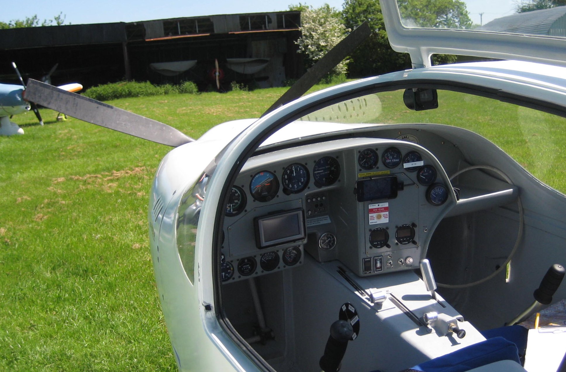

Here is a my very simple panel,. Sorry no carpet, no leather. The base model. Ventrui AI and DI, Area 500 gps, iphone memorymap.
The middle panels can be removed and all instruments and fuse panel and wiring accessed without taking out the whole console.
I am already changing it, taking out the rotax tacho and clock and putting in the CS prop controller.
