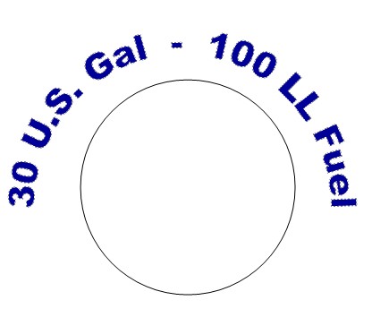

Tim(at)MyRV10.com
PostPosted: Thu Jan 19, 2006 8:53 am    Post subject: Fuel Label / Placards Reply with quote
I'm not 100% sure it's a requirment or not, but I believe that it's
one of the things the inspectors look for. A label near the fuel
filler opening (or on the cap) that says the quantity and type
of fuel. Makes sense, since fuel related problems are one of the
largest causes of accidents. I know in my Beech, the POH actually
had pages with all of the required placards on it, and they
had a nice one that went by the filler necks.
I attached what I plan to use. Randy or one of the other people
flying may be able to tell you what they found/heard.
Tim

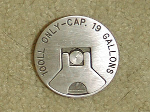

Ray.R.Doerr(at)sprint.com
PostPosted: Fri Jan 20, 2006 6:42 am    Post subject: Fuel Label / Placards Reply with quote
You could do something like this instead. I did this on my
RV-9A and also had the N number on it in the middle.
Thank You
Ray Doerr
40250
 Filesize:  28.03 KB
