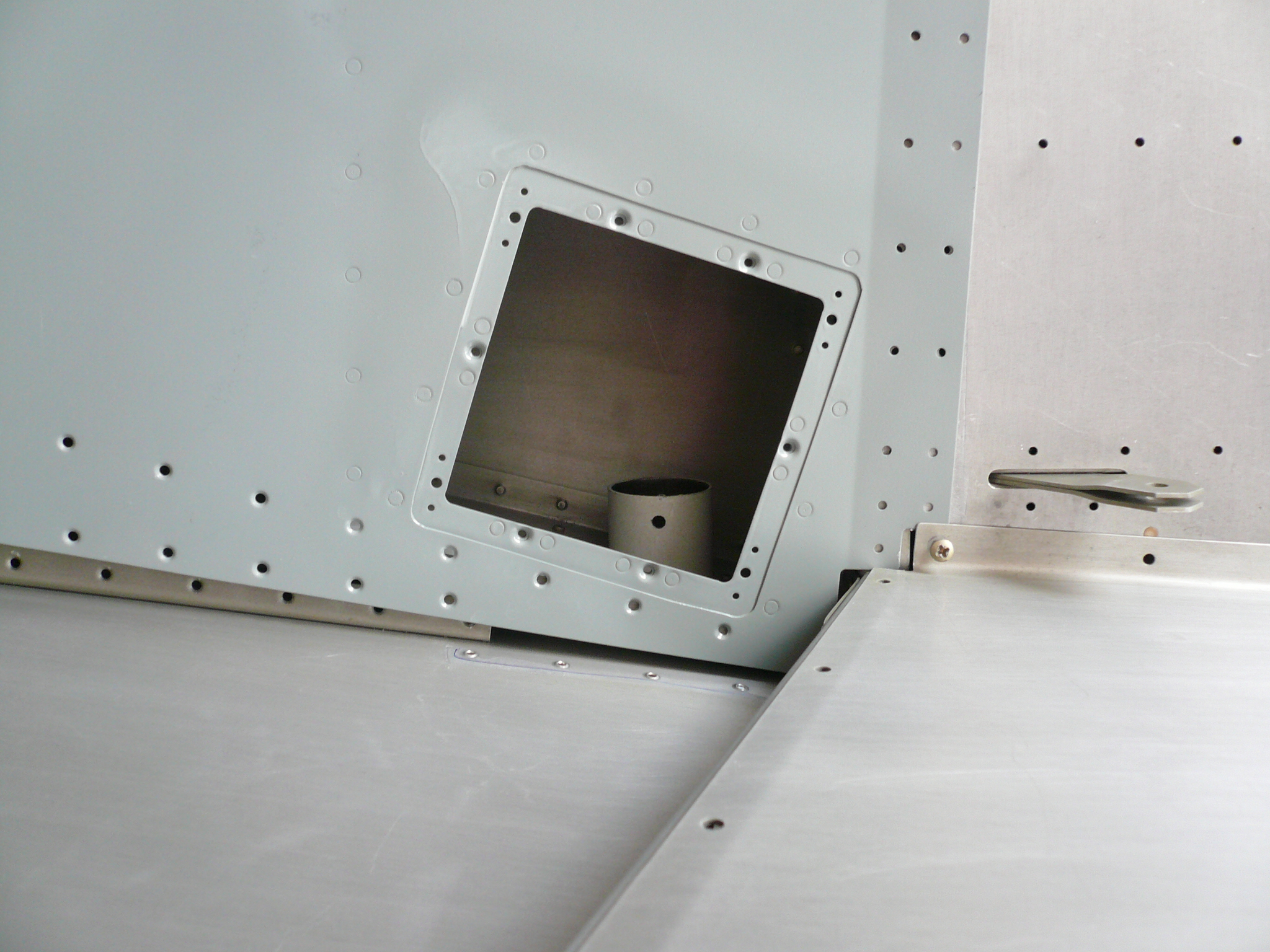

PostPosted: Tue Jun 05, 2012 5:57 am    Post subject: broken pilot step Reply with quote
Truly sorry to hear about the broken step. At least nobody was hurt when it broke - could have caused a nasty gash. I have long recommended an inspection hatch for the step bolt as well as to check on corrosion. I used the access hatch from the wing. Installed it fits flush.

PostPosted: Tue Jun 05, 2012 7:57 am    Post subject: : broken pilot step Reply with quote
Mike,
how did you solve that two of your screws are hidden behind the riveted
baggage side panel? Any picture with that panel in place? I moved mine a
little bit to the center and cut out a bit on the flange of the panel.
Cheers Werner

PostPosted: Wed Jun 06, 2012 3:15 am    Post subject: : broken pilot step Reply with quote
Thanks Mike - this one caught me by surprise. Very good thinking about the installation of the hatch during the build. It will be fun to get the building gear out for a change.
