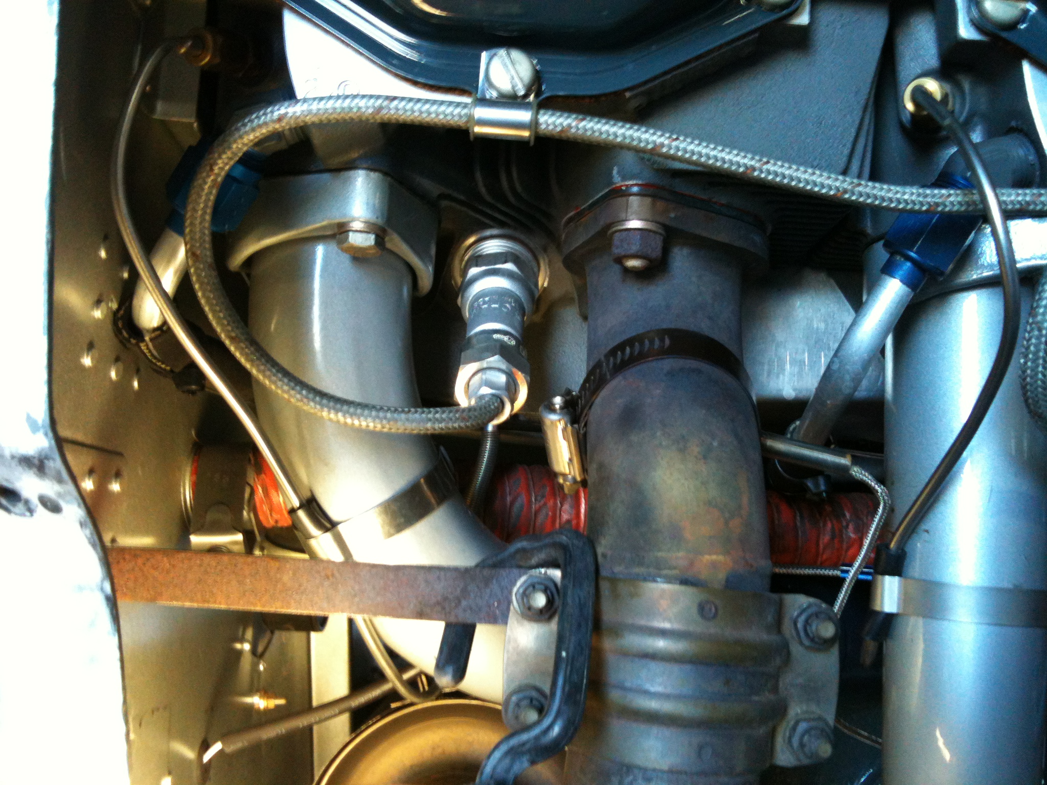

Pic of EGT probe installed so that it needs to be removed in order to get the plug out.

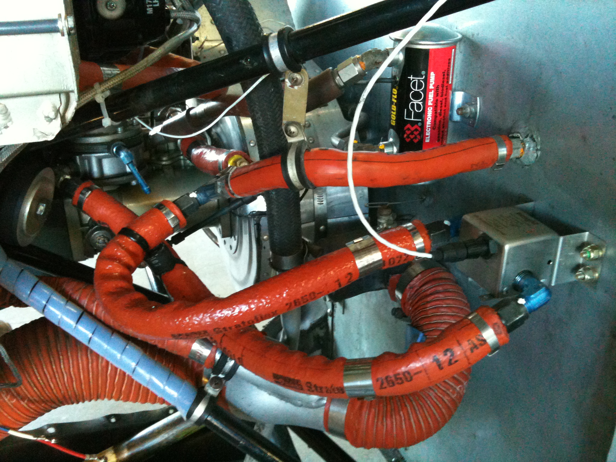

Pic of fuel flow transducer installation. No fewer than 4 90 degree turns. What a mess.
