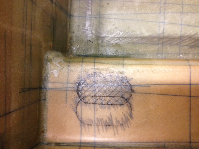

I have been marking the cockpit module to trim and cut out etc. However when it came to marking for the rudder cable access holes I have a problem and don't know which one to cut out.
On the port side of the cockpit module there is 2 lots of trim lines one is hatched the other isn't. There is only one marked on the starboard side, this again has the hatched lines through it.
The attached photo will give a better understanding of the problem I have.
I'm leaning towards the hatched one being the correct one to cut out as this matches the one on the starboard side of the module.
Any help as to determining the correct one to cut out would be much appreciated.

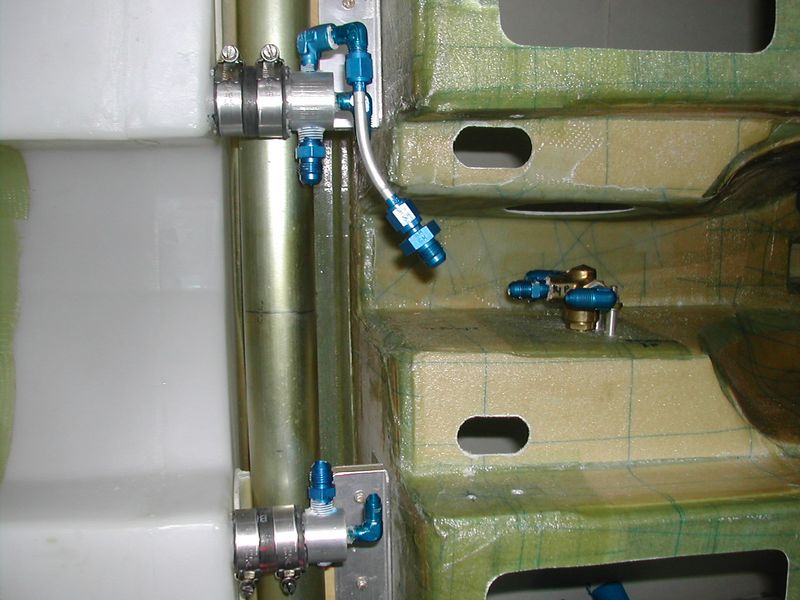

Here's a picture from below of what I believe are the openings in the cockpit module you write about.
[img]cid:ABB6DDFA-88F8-4996-8393-B6A348AD3A94[/img]
They are cut out in the most outboard locations.
