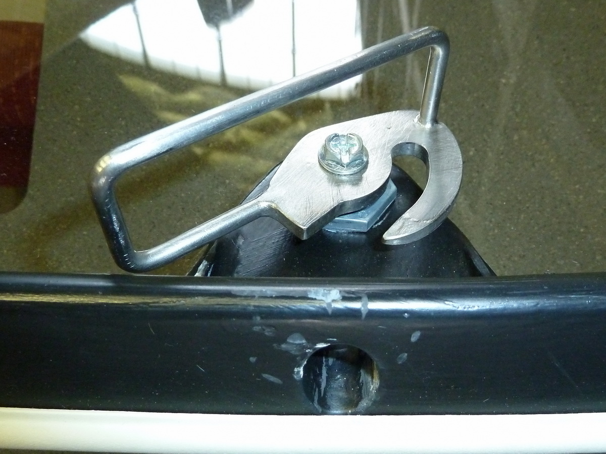

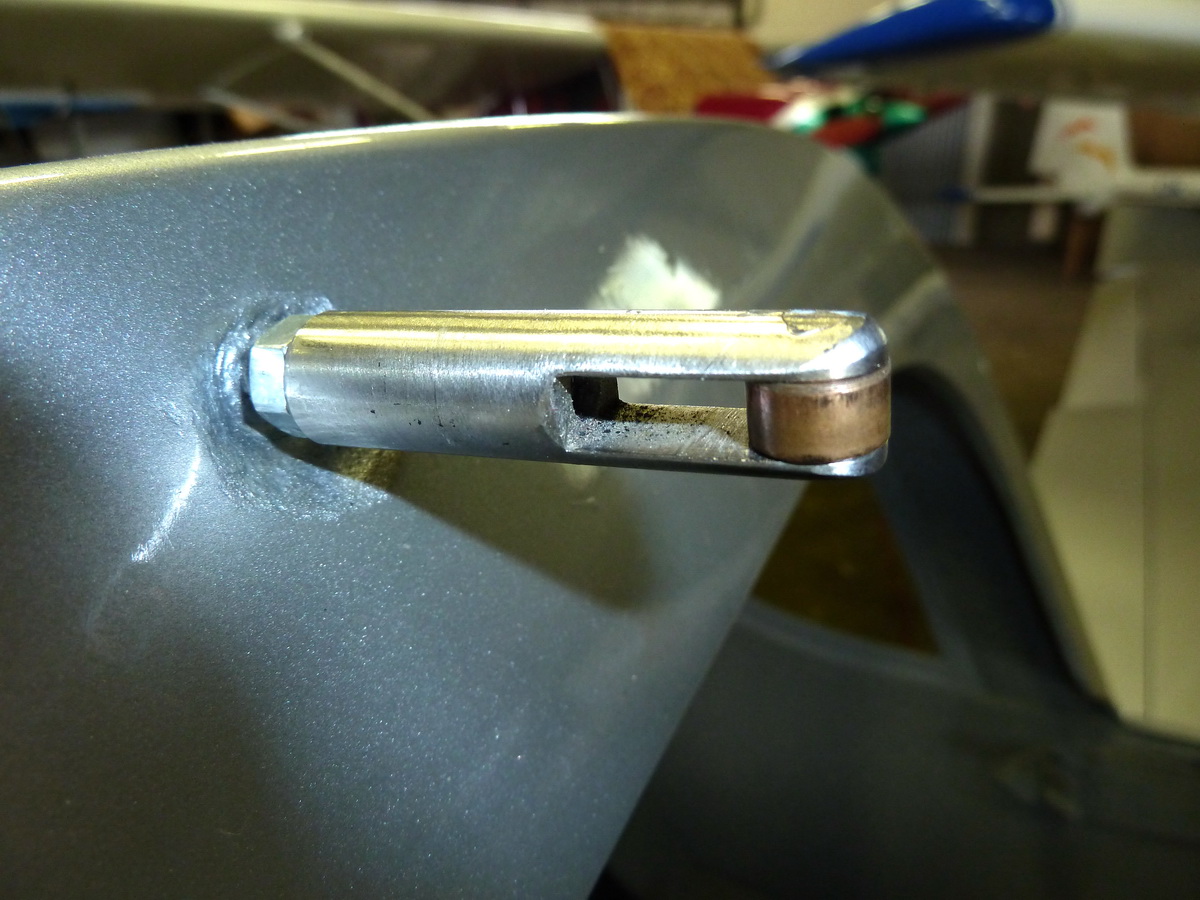

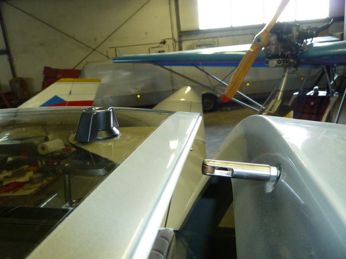

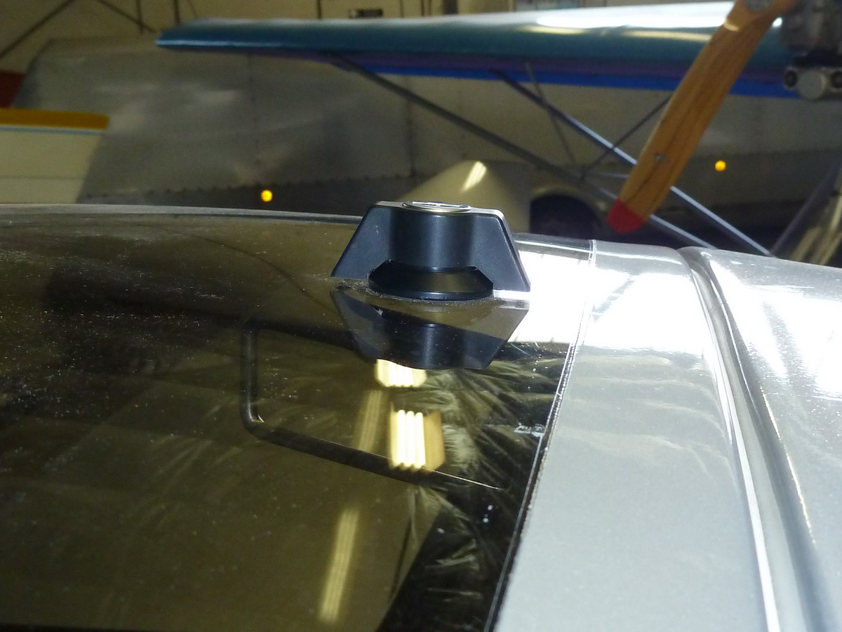

Hi Scott, Re: Canopy catch
I made a canopy catch as follows: Rotating lockable handle on top of the canopy, which is used for sliding the canopy open/close from inside/outside and by 1/4 turn the cam engages into a 1/2" rod with roller attached to the opposite of the cabin opening. This is screwed on a rod for fine adjustment. In worst case you catch your bum on the round roller, not as painful and visible as your forehead!
