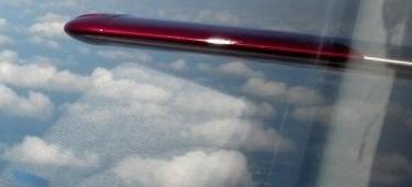

Just short of 30 hours on N7ZK. Attached photo is of the elevator horn in level flight. As you can see, the elevator trailing edge is slightly down. This implies the HS is creating too much downward force and the elevator is adding upward force to compensate. The question for the group is would it be worthwhile to add a shim under the forward HS spar – say .040” or so to correct for this, or is it close enough? This is solo, so any weight in the back would, I assume, make the issue more pronounced.

That is perfectly normal. Looks identical to mine in cruise. Not an aeronautical engineer, but i believe the CG moves aft as speed increases. Also, i think it's designed that way for greater efficiency, as there is less downforce on the HS creating a greater net lifting force of the plane overall.

I'd urge caution. If you reduce the downward force the tail can generate you might find yourself landing nose wheel first, especially at forward cg.

Thought about that, but as is solo (the most forward CG that I will have) I
have a lot of nose up trim left on landing.

Well, most every Mooney I have flown in has a more pronounced elevator
displacement during cruise. I don't think you are going to get
perfection on angle of incidence to the point you get rid of elevator
displacement. Maybe could be done for one specific wt and cruise speed,
but would be out for anything else.

The Mooney uses an all moving tail, including the vertical stab. It is
like any other tail setup, you trim for neutral forces.
Where the elevator winds up is apparently a function of c.g. mostly. To
have a longitudinally stable aircraft the tail has to be generating some
downforce, it can't be neutral.

Solo or hauling the family, mine does not change position much. Like yours, slightly above at 160 ktas. I would leave it alone.
