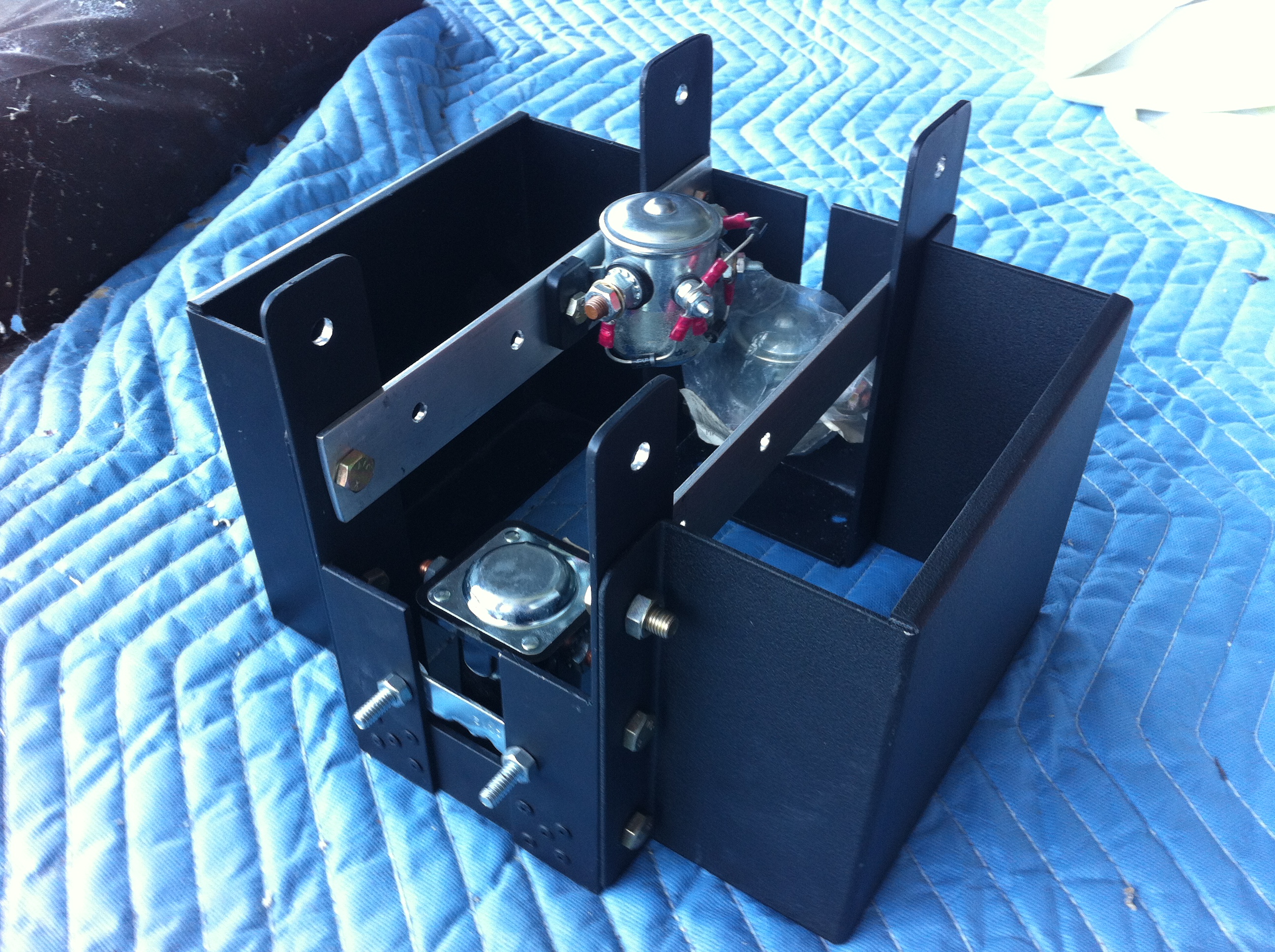

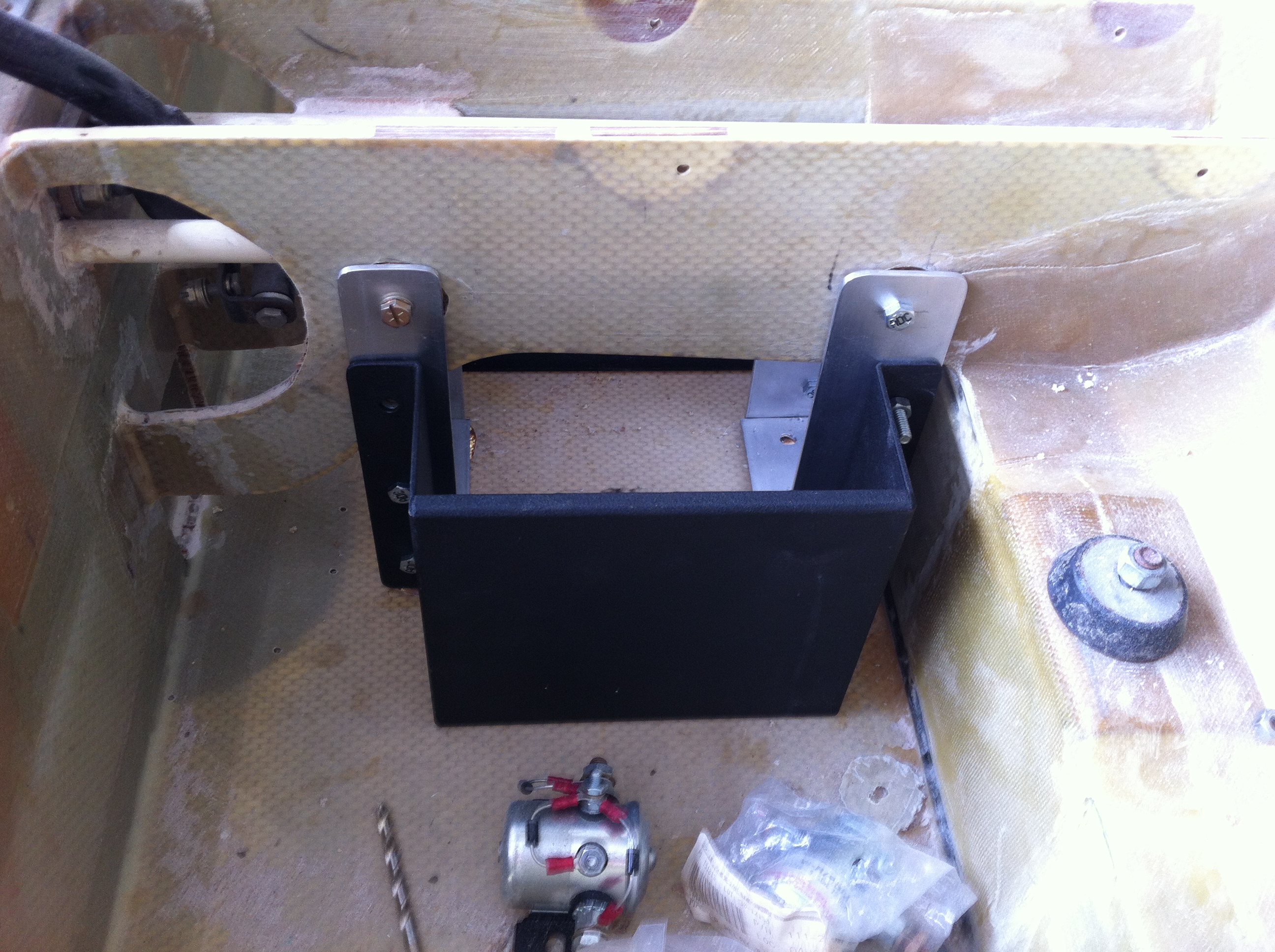

PostPosted: Sun Aug 19, 2012 5:50 pm    Post subject: New Instrument Panel Reply with quote
Sounds Great Galin, I look forward to seeing it in a week or so. Got some time in on my project this week.  Can't believe how long it takes to make what seems like a perfectly simple battery box. Constructed a frame for mounting dual batteries on either side of the center console under the front seats. I decided to put all of the relays (Master, Starter, Crossover, Secondary ) in the frame between the batteries. It is a very tight space but will keep the leads as short as possible. Hand cutting, hand filing, and fabricatioin takes a lot of time but it was a welcome break from SANDING!!!!! Fear not though, filled and sanded the bottom of the fuselage which is great fun if you like having sand dust dropping into your face and mouth. Put in some hard points for support of exhaust system, electric fuel pump, and future auto pilot servos. Trying to finish everthing I can on the inside before putting the top on permanently.

PostPosted: Mon Aug 20, 2012 7:04 am    Post subject: New Instrument Panel Reply with quote
Bob; You didn't build a battery box, you built a complete power station. Looks good. Surprised)

PostPosted: Mon Aug 20, 2012 9:25 am    Post subject: New Instrument Panel Reply with quote
Wellllllll, it started out as just a simple battery box but it kinda morphed into something more. I liked the idea of keeping all the primary power leads short and in one area inside and out of the elements. As I started assembling it just seemed a natural to use that extra space for something useful and everything just seemed to fit. Now to start adding all the wiring.
Bob
