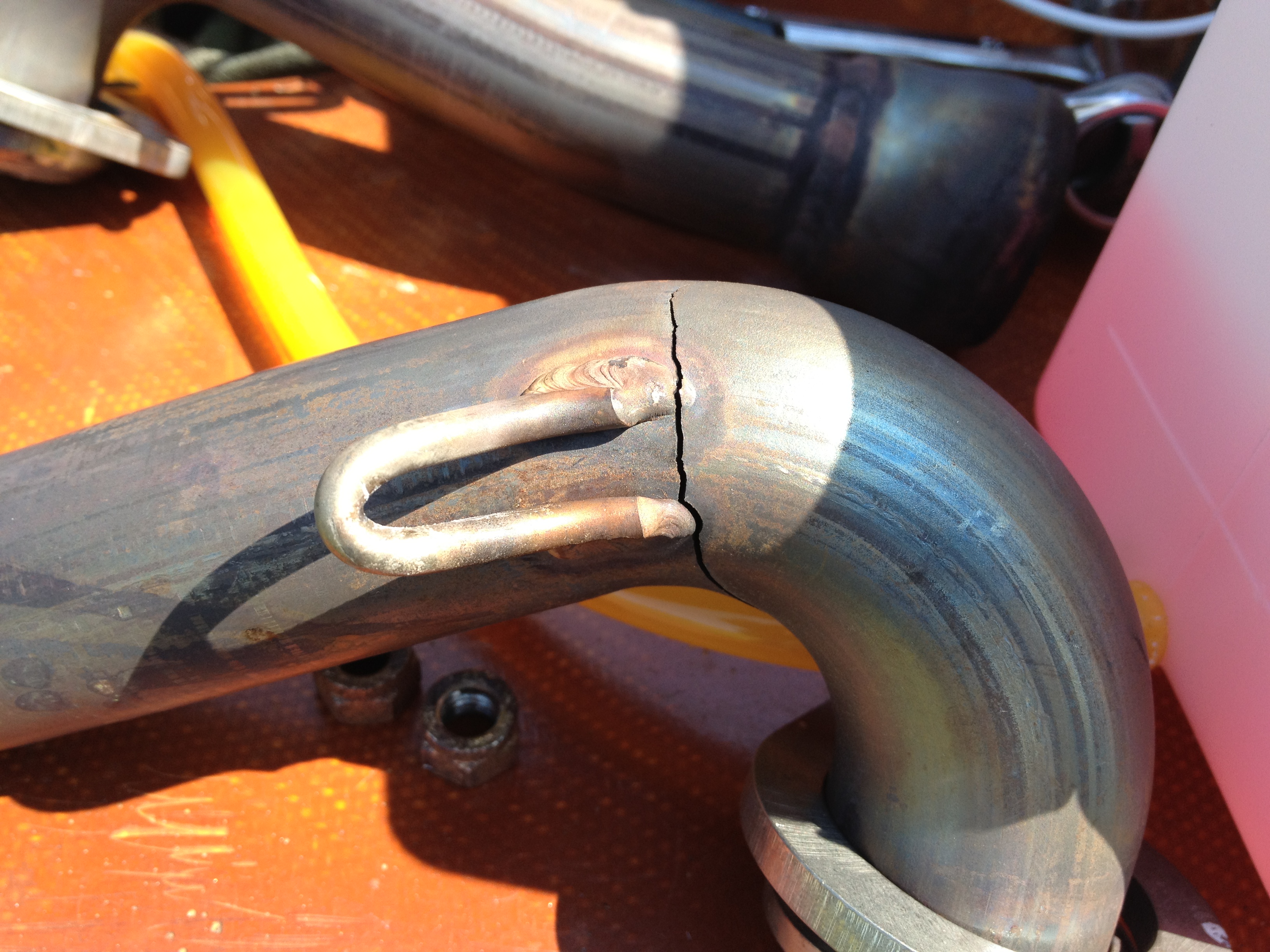

Hi, I'm suffering from exhaust cracks - specifically in both of the rear cylinder downpipes on the inside of the tight bend. The cracks form around the circumference of the bend and when first discovered were approx 75% around each rear pipe! They are very hard to spot normally as the location is right out of line of sight and well hidden. Each one has now cracked twice, the first occasion I found them both cracked and had them welded up, since then I've found them individually (just found the second one gone again).
History - Fitted secondhand Rotax 912ULS last year (replacing the existing Subaru) with a brand new Firewall Forward kit from Europa, including of course the brand new exhaust, this kit I had purchased 2 years prior ready for finding a Rotax engine. The first flight of this engine and new FWF set up was June 2011 and has done 25 hours of flying total since then. The cracks were first spotted after 15 hours of flying.
I am 100% confident that I have fitted the exhaust (each time!) carefully and correctly with no strain or stress on any of the components. The engine always extremely smoothly with no vibration.
I have just e-mailed the factory about it but was just wondering if anyone else has suffered exhaust problems like this or can maybe offer advice?
A photo of one of the cracked pipes is attached.
Cheers, Jon

Hi Pete, thanks for your reply. I should have said that mine already is an XS version, stainless steel by CKT. On mine its both the rear pipes that keep cracking (twice for both of them). The front ones have so far been ok. Attached is a photo of one of the rear pipes - the other was similar.
Cheers, Jon

PostPosted: Fri Aug 24, 2012 10:59 am    Post subject: XS Exhaust System Cracks Reply with quote
Hi Jon
My crack ran along the inside of the bend along the length of the pipe,
rather than round it. It is noticeable that the crack is just along the
bottom of the weld for the exhaust spring, though if that is anything to do
with the problem I could not say.

Hi Bud, Many thanks for your input on this. Interesting to hear about the problems you've had too. Just to give you some data from me, my problem has been both the rear pipes cracking, ie cyls 3 and 4. I first found them both cracked together after about 15 hours flying on my new engine installation. They were both cracked about 75% around the circumference inside the tightest part of the bend. They may have been like that for quite a while as they are almost impossible to spot without a mirror when in situ. It was taking no. 3 off to fit the new HD starter I quite by chance found it cracked. I had them both welded up. After about 2 more hours flying I found no. 3 cracked again, following almost exactly the same line as the first time (but not quite on the weld repair - it was fresh metal that was failed rather than the repair itself). I had it welded again. Since then I did just a quick 20 minute flight and have found no. 4 has cracked again, same pattern. So each rear pipe has cracked twice now. Both front pipes have been ok to date. The cracks do seem to run through where the spring attachment loops are welded on as my previous picture shows. As far as I am aware my springs are stainless - as supplied by Europa (they look stainless to me!). The engine runs very smoothly - as you say it can be a bit clunky on start/ stop but not excessively. My propeller is a BSW (Bog Standard Warp!) ground adjustable 64" non tapered blades warpdrive fitted to my 912 ULS. I always keep the carbs well sync'd. I do notice sometimes a slight vibration during slowing down and/ or descending - if flying fast at a high power setting when I reduce power at high speed, at a certain point during the power reduction - usually when the throttle has been brought a fair way back a slight vibration/ resonance can sometimes suddenly kick in but it's only ever very slight, a slight tremble than an actual vibration. More of a slight change in sound. I've never thought anything of it. I don't really know where to go with this now as it seems to be an ongoing problem I have and I can't really fault anything else in my setup.
