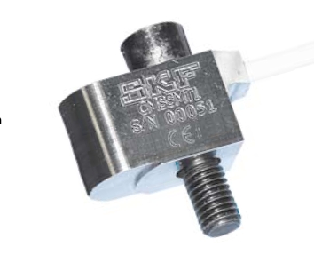

Just saw this critter
http://tinyurl.com/8ejraxb
which seems to be an internally signal conditioned
device. You could google the device and see
if there are any user's manuals floating around
out there.
I wasn't aware of this product.
[img]cid:.0[/img]
Signal conditioning built in and designed for
use on machine tools. See:
http://tinyurl.com/8v3ejxe
Looks like just what you need. You'll still need
to filter irrelevant vibrations so that you can
take a close look at the relevant data.

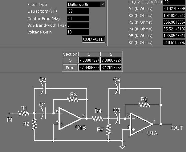

Here's an exemplar band pass filter for 30 Hz, (1800
propeller RPM).
[img]cid:.0[/img]
This is a rough order of magnitude swipe at the task.
You can fiddle with alternative gains, center frequency and bandwidth at:
http://tinyurl.com/9xwbwfm
Good luck!
