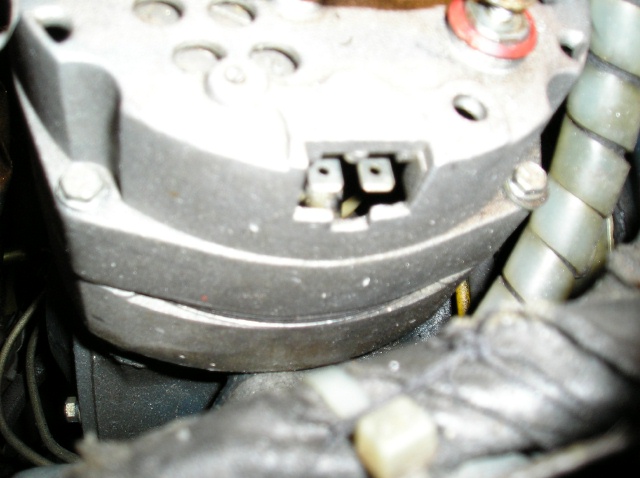

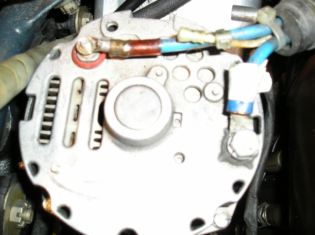

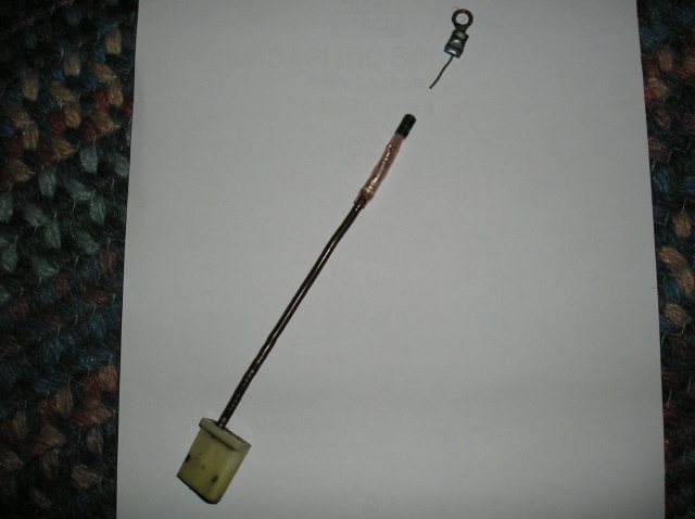

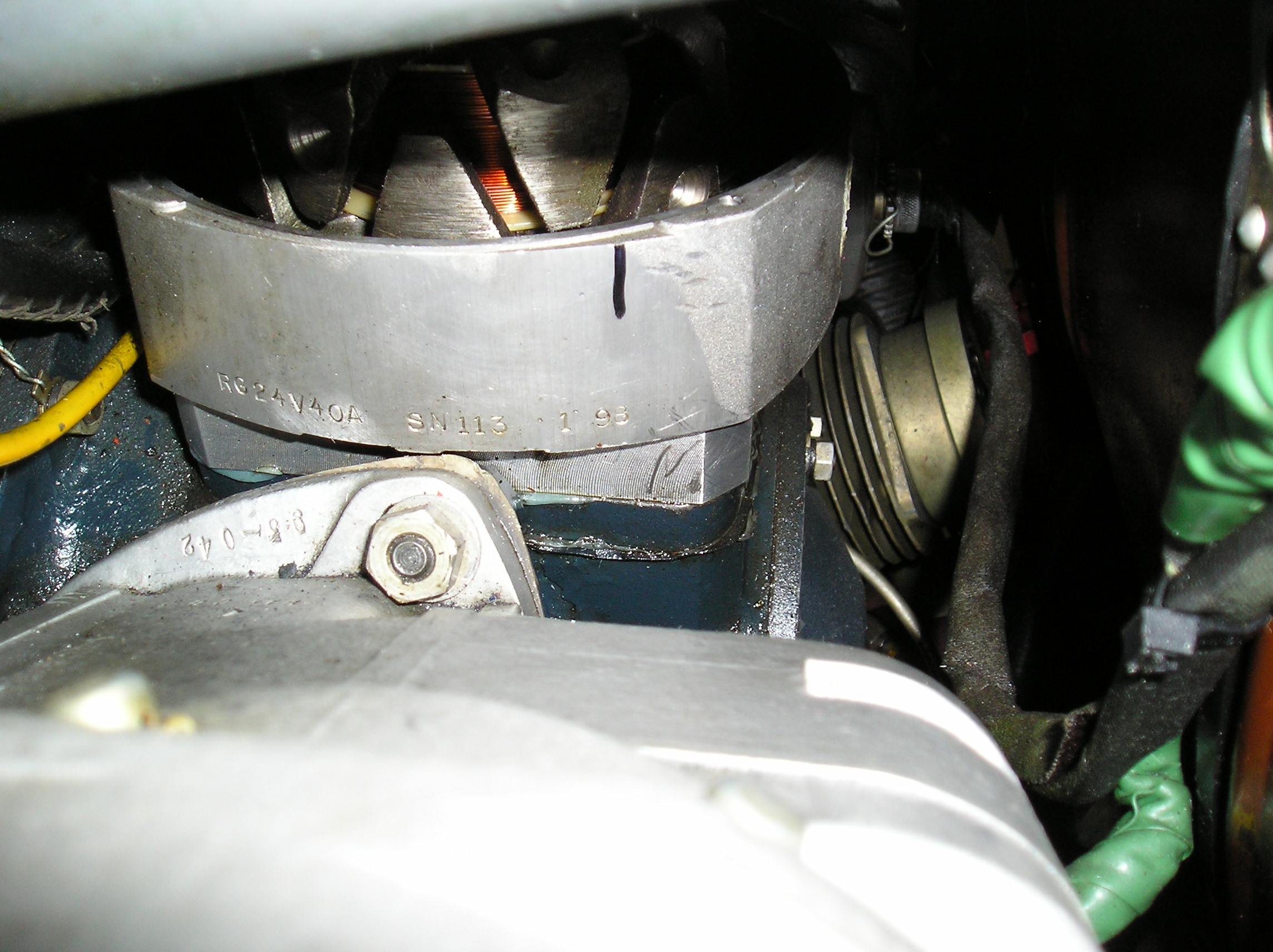

Brian & Mark, photo's enclosed.  The broken wire was attached from the batt. post on the alt. to the bayonet fitting on the side of the alt.

OK, that is an internally-regulated GM truck alternator. The wire jumper between the #2 terminal and the 'B' (battery) terminal is for sensing voltage. You definitely want that wired up. (If you want better voltage regulation you can run that wire back to your main bus but that will probably be more work than it is worth.) If that wire breaks it is possible for the alternator to turn on hard and cause a serious overvoltage event that can damage your battery and electronics. The other (unused) terminal (#1) is to provide connection to the idiot light but that also powers the internal regulator from battery voltage to start up the alternator. You might want to add an idiot light. It will come on if the alternator is not producing output. If you don't want to install a light you should probably install the 10 ohm, 10W resistor in place of the light. That ensures that the alternator will start right away.
There are actually two flavors of this alternator. One requires the idiot light or resistor and the other, the so-called "one-wire" alternator, doesn't. If you have the "one-wire" version you may have to run the engine up to 2000 RPM or so before the alternator will come on.

Paul, it would help if you would also include a picture of the small
part that broke off that you copied the number off of so that Brian can
see that too.

It looks like someone might have put a diode in series with the lead from the 'B' terminal to the #2 (sense) terminal. The diode is probably a 1N4007 and the banded end would be toward the #2 terminal and away from the 'B' terminal. That is a way to get the alternator to produce about 0.7VDC more output to raise the voltage to correct for voltage drop across the 'B' lead going to the battery and/or main aircraft bus. If someone used a smaller gauge wire from the 'B' terminal you could have a volt or so of drop and this would correct for that.
Of course, the right answer is to run the lead from the #2 (sense) terminal back to the bus rather than connecting it to the 'B' terminal, and then not use the diode.
As for the marking on the alternator, it just says that it is a 24V at 40A alternator. When you put the alternator back together be sure to push the brushes fully into their holders and put a stiff wire (paper clip will do) in the small hole in the brush holder to hold them in place until you have the alternator case back together.

If you read the part number incorrectly off the small device that broke
off, then Brian Lloyd's explanation is perfectly plausible and could
easily be correct.
If you read the part number correctly and there is no chance that you
made an error, then the device is not a diode but instead a trans-sorb
and Brian's explanation of why it is there is possibly not correct.
Either way, it is no big deal.
Personally, I am not sure why someone might wire up a trans-sorb in the
fashion that it is wired, but I am willing to admit that I don't know
everything in the world there is to know about electronics and someone
might have put it there that knows more about it than me.
Given the fact that it was working perfectly for quite some time before
it happened to break, then I would make an assumption that it will work
just perfectly again after you replace the part. If this is not the
case, then ignore what I am suggesting.
Be absolutely sure what the number is on the side of the thing. Order
one, try Digikey Electronics. It will only cost a few dollars IF THAT.
Get it in, and if it looks exactly like the one that broke, wire it up
the same way it was, and be done with it.
Mark Bitterlich
p.s. Brian and I will agree to disagree on this one.

I believe it is possible that the NTE 4934 is part of a voltage
regulation scheme and I would not recommend replacing it with a 1N4007,
but instead would replace it with the exact part number that was already
in there. I would not change any part of the design until the total
design is fully understood.
At the present time a full understanding of system operation is not
present. So either we dissect this thing down to Parade Rest, and then
redesign it from the ground up, or we replace the broken part and fire
it up.
Your choice.
Mark

Brian, should I use the 1N4007 diode or the NTE 4934? Both are available.
Frankly, neither. More below.

Paul,
easily be correct.
Mark Bitterlich
it up.
Your choice.
Mark
it up.
Your choice.
I agree with Mark. But my feeling is that the right answer is to indeed make sure that this has been done right rather than just replace the part and move off, fat, dumb, and happy.
These internally-regulated GM alternators are dirt-cheap sources of power. They are also super simple. The built-in regulator controls the output of the alternator to keep its voltage at the desired level, i.e. around 14V (usually 13.7V) for a system with a 12V battery, or around 28V (usually 27.4V) for a system with a 24V battery. You can even make a 14v alternator into a 28V alternator by putting a 14V zener diode in series with the sense lead to the regulator, make the regulator see a voltage that is 14V below the bus voltage.
Now here is the real kicker and the thing you really need to think about. When the voltage regulator in these alternators fail, it can fail one of two ways:
  1. The output of the alternator can drop to zero and you are running on battery power only.
  2. The output of the alternator can jump up to about 100V quickly destroying the battery and shortly thereafter, everything else in the electrical system.
Frankly, failure #2 bothers the heck out of me. No, it doesn't happen very often so maybe you don't have to worry about it ... much.
FWIW, this is the reason that you almost never find internally-regulated alternators in aircraft unless the alternator has a fail-safe way to interrupt the current to the field (rotor) winding in the alternator. The stock GM alternator does not offer that. On my boat where I had a pair of these alternators to handle the battery charging chores, I opted to modify the alternators to remove the internal regulator and control them from an external regulator that had overvoltage protection, just like the standard charging systems in production aircraft.
Anyway, I am willing to expound further if you are interested.
