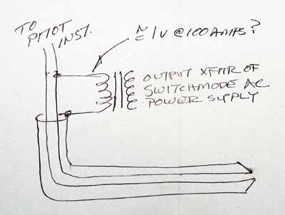

After being tasked with participating in one
such a hat-dance, I took a hint from Weller
soldering guns, HV supplies in CRT/vacuum
tube TV, and modern microwave magnetron
power supplies and proffered this idea:
[img]cid:.0[/img]
Suppose you made a pitot tube out of concentric
stainless steel tubes like this and excited
the assembly with very low voltage, high
current energy from a switchmode power supply
built into the base of the tube. I hypothesized
that one could distribute heating energy between
inside and outside tubes by controlling wall
thickness.
The tube WAS also the heater. No temperature drop
across heater/tube insulation. Plenty of heat
thoughout such that tailored distribution
issues might go away. No independent heater to
fabricate, no heater-tube insulation issues . . .
or LOSSES.

There was a time when I worked my first projects
with Beech that somebody would have taken this
ball down-court to at least see if it bounced.
I hear the Russian space program is turning blue
with loss of grey-mater. See:
http://tinyurl.com/blzjvu3

So, perhaps there's an opportunity for somebody
out there with some metal working skills and
a curious nature. I'd be willing to stroke
the electronics if some one of you could acquire,
bend and weld alloys of steel that might make
good heaters cum pitot tube.
It would be interesting to see if this ball
would at least bounce. Could we learn to "build
the better pitot tube" for MUCH less than
$600?
