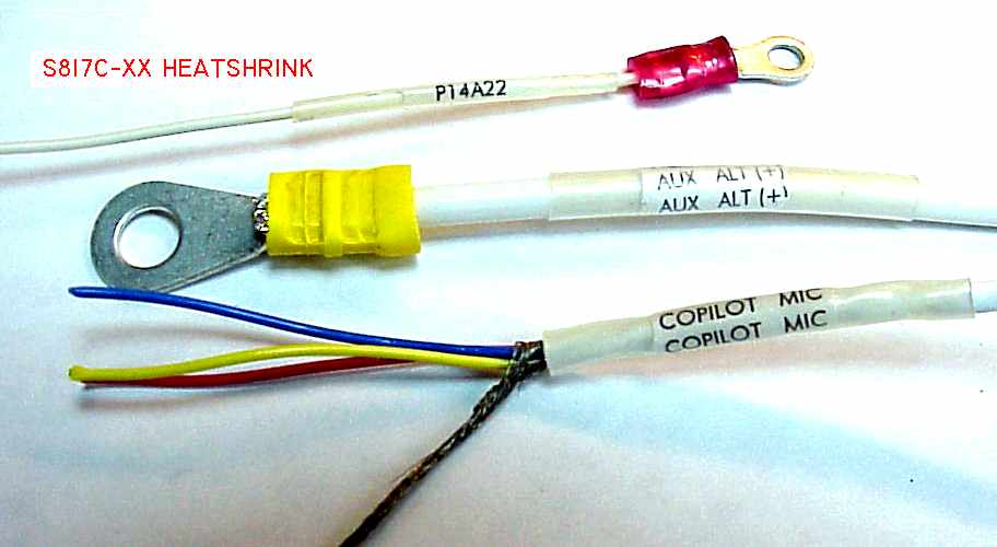

PostPosted: Sat Sep 29, 2012 4:59 pm    Post subject: numbers on wires Reply with quote
See bottom of this page
http://www.matronics.com/forums/viewtopic.php?t=62540&sid=671cc22fb30c3b9b8dbbcf933f2dd3d5

PostPosted: Sat Sep 29, 2012 5:04 pm    Post subject: numbers on wires Reply with quote
[quote]http://www.buyheatshrink.com/dymo-label-writer/rhino-5200-heat-shrink-tubing-printer.htm
