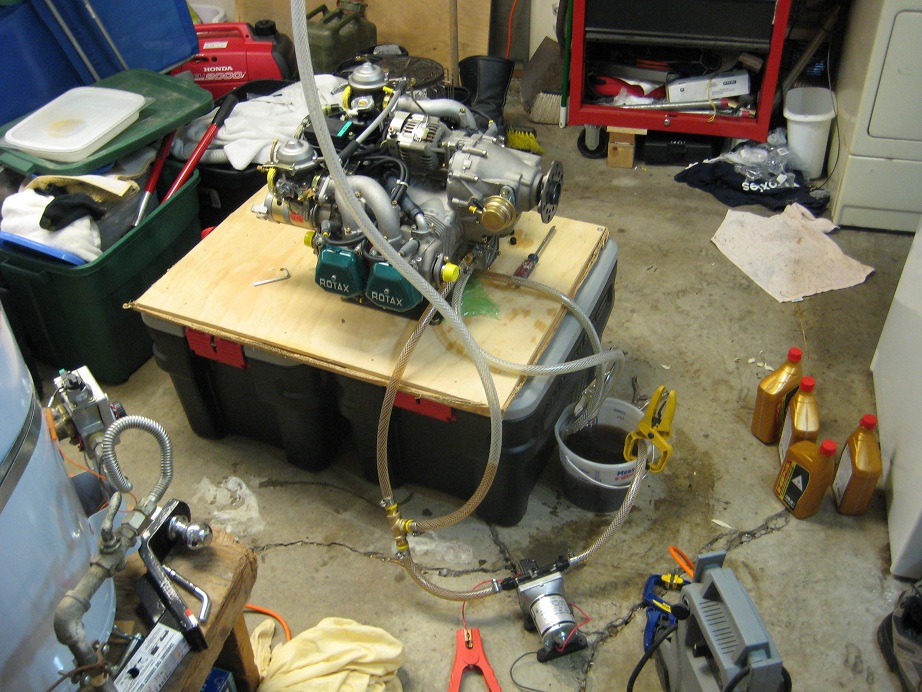

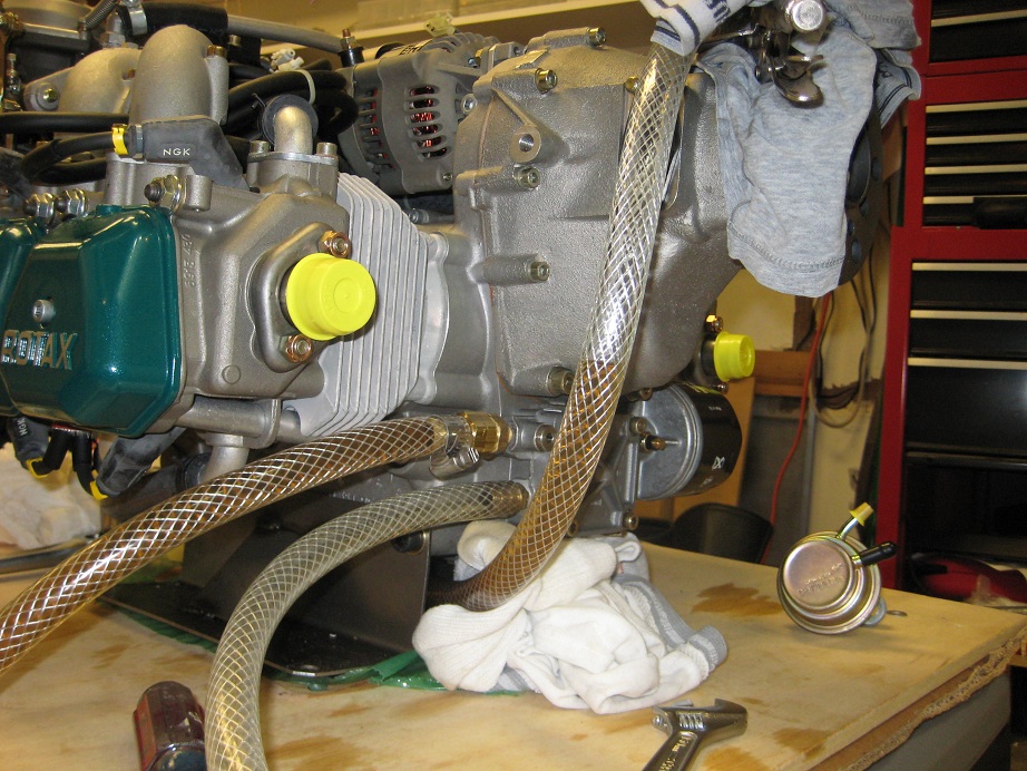

Greetings all:
I looked in the archives and didn't see an answer so here goes:
I have a 912ULS, in the crate I bought it in 2005. I just unwrapped it and would like to pressurize the oil system with engine oil since the engine has been sitting so long and I am very concerned about roating the engine (dry) to get the internal pump to move oil. I have a 12 volt oil pump, return tank and accessories to accomplish this, however I have a question:
Can I simply feed the oil pump inlet hose-barb with oil pressure to circulate oil throughout the gallery? I am concerned the pump will not pass oil if the engine is not turning.
Alternately I could remove the pressure sender and feed the gallery from there unless there is some reason not to. My preference is to feed through the larger oil pump inlet in the hipe of greater flow through the gallery.
I plan to return the oil by draining the crankcase through the return hosebarb and back into the return tank.
Any thoughts or suggestions to circulate oil through my engine?

PostPosted: Fri Oct 26, 2012 4:02 pm    Post subject: Pre-oiling 912ULS Reply with quote
Hi Roger,
Thanks for the response.  I agree on the value of the Rotax Owner site.  For years I got the updates, and am now reviewing the latest docs.  I just joined the pay portion (is paying to play new?) and reviewed the video.  The procedure does make sense, and I recall in the maintenance class they stressed the critical importance of purging.  That said my question is can I pump oil into the engine *without* rotating it?
The procedure suggests air pressure against the tank to force oil into a turning engine.  I am fortunate to have an electric oil pump so I don't need the air pressure.
I am several months from engine start, and have had the engine in its crate, wrapped in plastic for years.  I want to circulate oil without rotating what I fear are dry (or nearly so) bearing journals.
When engine start comes I will follow this purging procedure to the letter.
Until then I wish to circulate oil, without first turning the engine.
I will re-examine the engine docs to look at the oil pump/bypass topology, but to save time I was asking if anyone on this list knew if oil can be pumped past a stationary oil pump.
My intent is to rig up my system and pump fresh oil through the gallery several times a month until engine installation.  If I am lucky perhaps that will make up for having a new engine in mothballs so long.
Do you (or anyone else) know if a non-turning engine will allow oil under pressure past it?
Thanks, Jim

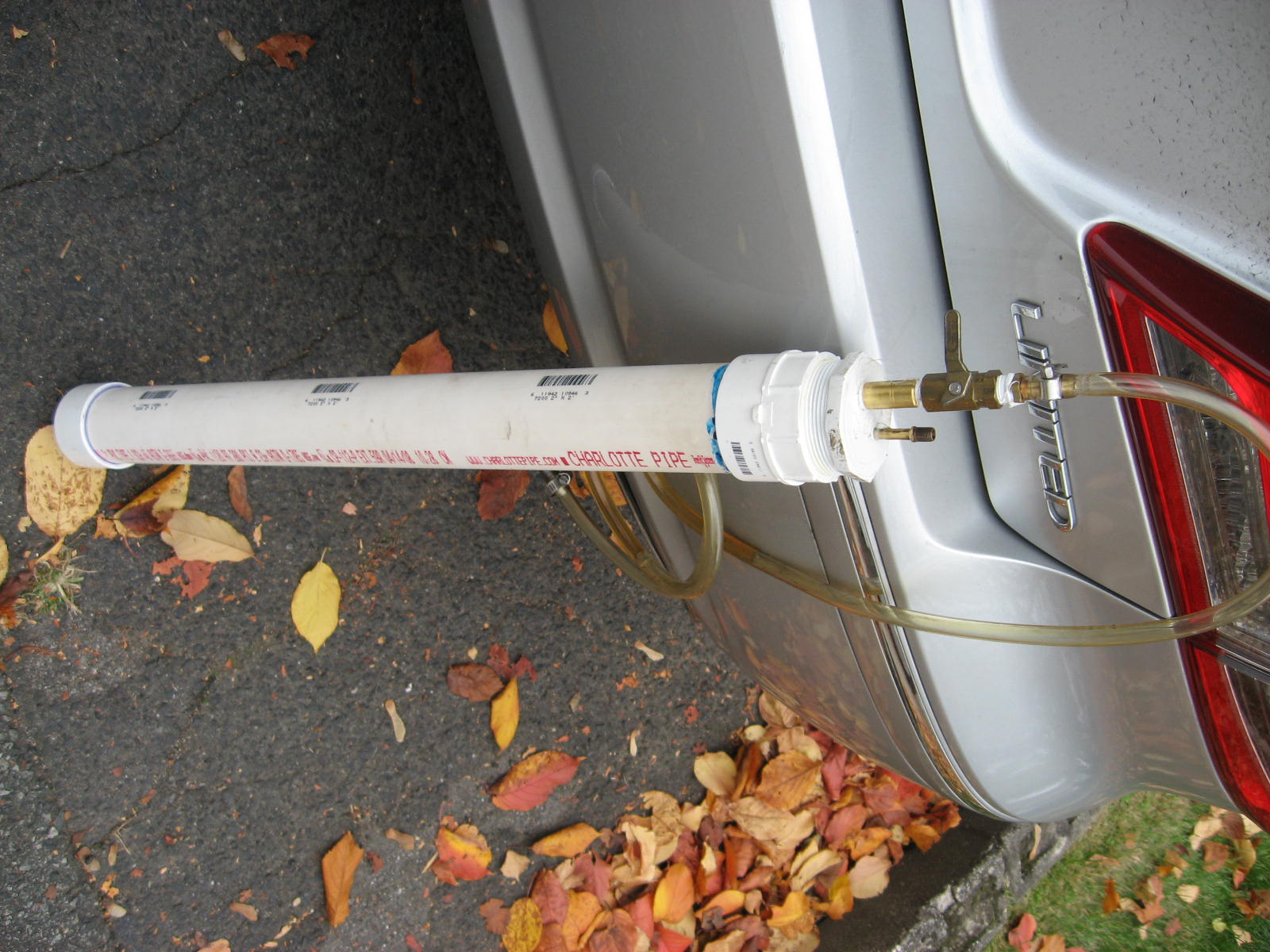

3 - I do not know if the picture I attached will get through.  If it does not contact me directly and I will send it directly to you.
4 - This picture is of a Pre-Oiler I made.  It can handle oil pressure up to 150 PSI.  YOU pick the oil pressure your engine operates at and Pre-Oil at that pressure.
5 - Use the engine operating pressure so any valves will be opened by the pressure and the oil spray will cover the same areas as during normal operation.
6 - Since the engine has an Oil Pressure Regulator (item 1), you should pressure the pre-oiler higher than operating pressure and because the pressure drops in the pre-oilier quickly as volume of oil drops.
7 - Monitor the Oil Pressure Gauge of the plane/engine, since the Oil Pressure Sensor (item 2) is hooked up.  There will probably be only a small deflection since the pre-oilier is applying pressure for only a short time.
8 - Now, here I have to ask a question.  Does the Oil Pump (item 3) have a reverse flow check valve?  If YES then you are limited to pre-oilier flow direction.
If NO then - Use the Pre-Oilier in BOTH directions - The IN and the OUT.
9 - When I Pre-Oil, it is done with one (1) quart of oil in each direction - From the Oil Cooler into the Engine and then Into the Engine on the OUTPUT side of the Engine.  See note 8.
10 - Now, here you have some options:
a> You can leave the Oil Tank (item 4) attached and it will catch any oil that makes it to the exit of the engine.  And remember to hook up a overflow tube to Vent Tube (item 7).  I really doubt if this will ever happen, or...
b> Put a Plug on the Engine Exit line/hose so it develops a good pressure to spray the oil all around inside the engine.

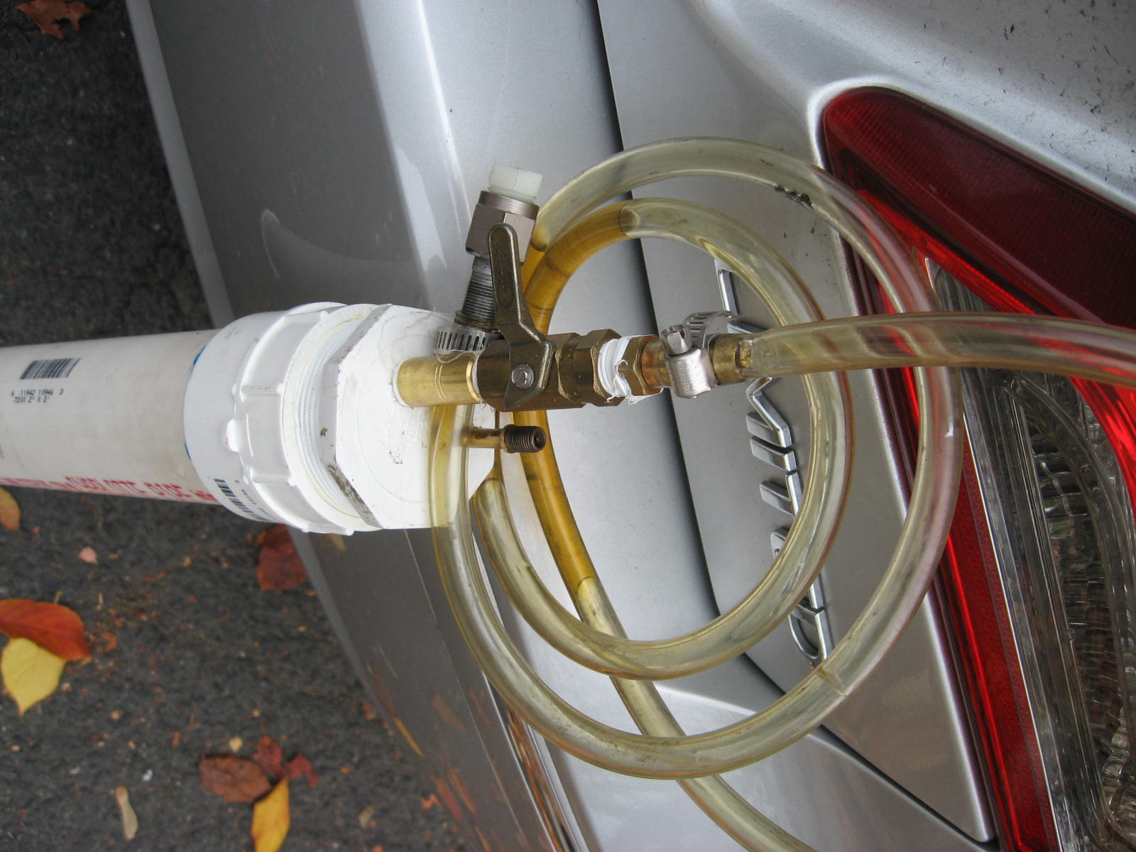

The Pictures:
Pic #1 is a general overview
Pic #2 shows the fittings.  One thing you can not see is the inside of the unit.  From the oil line on the outside is a nylon pick-up tube that goes to the bottom of the unit.
You will see a Shrader valve on top.  I hook up a 12VDC portable tire pump.  Pressurize the unit to 125 PSI, you can leave the tire pump on and running when you open the valve.
This system is so easy that I pre-oil anytime the engine sits for a month or more.

I purchased the engine around 2005. I peeled back the plastic, took a bunch of pictures and rewrapped it tightly sealing the plastic and reassembled the crate. The crate lived the next 7 plus years in my spare bedroom, temperature controlled.  Fast forward to last week. I opened it and pulled the engine out of the crate. Close inspection showed the engine was still externally slightly oily, and the crankcase has remnants of the oil used during the test run at the factory. All good news I think.
After much consideration I decided to inject oil into the pressure sender port. As was confirmed by this list’s experts the oil pump is a positive displacement type (no surprise) so I needed to inject oil upstream of the pump if I desire gallery oil pressure without turning. I didn’t inject at the pressure regulator as suggested cause I didn’t have ready access to the metric fitting holding the spring, and I wasn’t sure if I would simply vent oil directly to the crankcase bypassing the gallery if I took the regulator apart.  So I went with the pressure sensor port.
I removed the pressure sender and fed it oil (semi-syn motorcycle formulation since it will touch the wet clutch in the gearbox) at 40 to 55psi from a 12 volt pump. Added a tee in the pipe and 6 feet of sealed tubing (see pic) to act as a pressure accumulator so the pump doesn’t chatter. Worked out to 3 seconds of pump runtime to 12 seconds of resting.  After running all day the pump wasn’t even warm. I opened the valve covers and saw oil coming out the pushrods, confirming the oil gallery is pressurized.
Next I raised the drain line to trap oil in the engine (see pic), and used it as a sight glass to predict the level in the crankcase. The level was also high enough to submerge the bottom passage to the gearbox (see pic of open gearbox from the servicing class). Then I leaned the engine left and right, forward and back to submerge the pistons/pins and slosh oil around in the gearbox. Drained the crankcase, put a couple of tablespoon of oil into each sparkplug hole. Finally, after hours of oil circulation I turned the engine over, plugs still out.
Note I was using a clean bucket for the oil supply. I seem to have misplaced my oil tank. I will look around for it a little longer before I worry about buying another!
I offer this only for entertainment purposes and don’t suggest anyone perform this procedure without approval from your Rotax dealer. My engine is long out of warranty and I alone am responsible for the outcome. I intend to keep the engine in this oiling regime until I am ready to start it; at which time I will purge the system and confirm lifter status per the Rotax procedure.
-Jim

The Pictures:

PostPosted: Mon Oct 29, 2012 3:33 pm    Post subject: Pre-oiling 912ULS Reply with quote
Jim,
In my opinion, you did well, though it might be overkill. Nothing wrong
with having the engine thoroughly oiled before use.
Someone mentioned possible problems with the gearbox : you can't do much
harm to the gears by turning the engine by hand a few turns, even if
they happened to be dry.
Very few jounals in the Rotax, so the main issue migth be moving the
pistons in a dry cylinder. Not sure, but you certainly took care of this
by injecting some oil through the plug holes before turning anything.
Apart from this, no much risk with piston pins etc...
If correctly drained, too much oil will not harm the engine.
FWIW,
Best regards,
Gilles

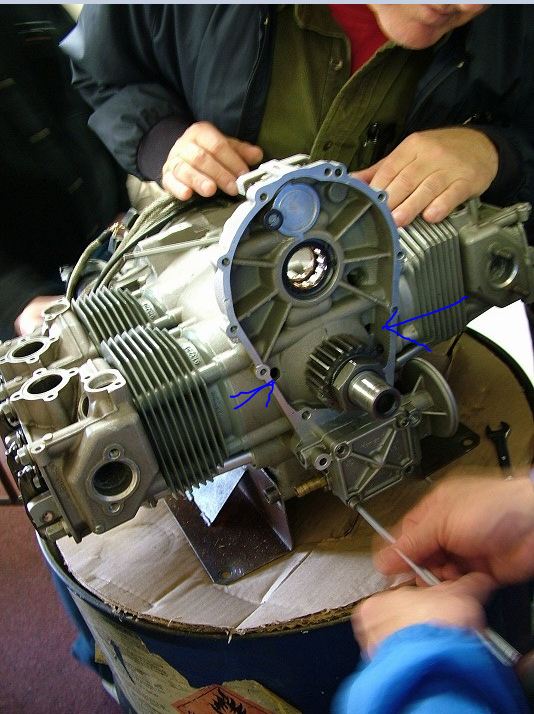

just a thought on a bit off subject.. but looking at the pic of the back side of the gearbox...
has anyone thought of plugging the oil journal holes in a gearbox... tapping a plug hole in the top and filling it with 90 gear oil... would solve a lot of issues with 912 and the oil debates. and the problems with excessive wear.. i am not sure of effects of slipper clutching.. just talking bout gears only boxes....

PostPosted: Wed Oct 31, 2012 6:16 am    Post subject: Pre-oiling 912ULS Reply with quote
Jim:
Sorry for the delay in responding, I'm in NJ and we lost power for the last
day or so.
HEY Smile Really great contraption. I love your set up. You have just
done a better job of oiling than Rotax ever would. The idea of the sight
tube (Egyptian Water Level) for oil level is a great idea. Now you now
know exactly the level oil and what was covered. Good Job Old Man.
Now, don't be surprised if you make a lot of smoke on your first start up.
It will last only a few seconds and only those outside the plane will
notice IF they pay attention. The prop blast will disperse things rapidly.
Getting oil to the gears is the next big issue. Lots of moving parts and
lots of metal on metal contact areas. If you were to:
1 - Remove the spark plugs.
2 - Ground the Mags.
3 - Totally flood the gear area - AND -
4 - Then turn the engine over by hand or with a heavy duty 1/2" Electric
Drill.
You will have covered all bases and will have that Totally Warm Fuzzy
Feeling.
5 - You could also squirt some oil in the cylinders prior to turning over
the engine by hand.
The only really rough Metal on Metal area is the rings and cylinder - Extra
oil there worn hurt.
Great Job - Keep us informed.
Barry

The Pictures:
or more.
Barry

Now, don't be surprised if you make a lot of smoke on your first start up. It will last only a few seconds and only those outside the plane will notice IF they pay attention. The prop blast will disperse things rapidly.
Getting oil to the gears is the next big issue. Lots of moving parts and lots of metal on metal contact areas. If you were to:
4 - Then turn the engine over by hand or with a heavy duty 1/2" Electric Drill.
You will have covered all bases and will have that Totally Warm Fuzzy Feeling.
5 - You could also squirt some oil in the cylinders prior to turning over the engine by hand.
The only really rough Metal on Metal area is the rings and cylinder - Extra oil there worn hurt.

Hi Barry,
Thanks for the confirmation regarding a possibly dry engine being rotated to introduce oil. Your pvc pre-oiler is really cool! Thanks for the pics.
-Jim

The Pictures:
Barry

forward while the crankcase was full, I am concerned about the big
bearings on the prop shaft. I was thinking of again removing the fuel
pump, putting a couple of pints of oil in, and closing it up. Then
with several helpers turning the engine upside down. This would trap
oil at the prop-shaft end. Leave it upside down for perhaps a couple
of hours to marinate two big bearings. Looking at the photos I took
in the servicing class, I suspect those bearings need a bit of splash
to keep those two lubed. I figure an hour or so marinating maybe soak
in enough oil to suffice. Once done I will turn it right side up, and
allow all the oil to drain.

> Hi Barry/All:
> Thanks!  I am running the pump 30 minutes a day so
the overkill makes
> me feel better about storing the engine for so long Smile
> I agree with respect to the gearbox.  While I did
lean the engine
about the big
it up.  Then
the photos I took
bit of splash
> I am several months from mounting the engine on the
plane, so this
> system will stay in place awhile.  Wish I could
find the oil tank as
> the open bucket has to go.  I will post separately
asking if anyone
> has a spare oil tank (I know...not likely).
> -Jim

Jim:
For testing you could make a tank from PVC piping.  It will handle the pressure if any and also the temperature.  You could also install a simple oil filter in line.
I know you will find the tank... Of course it will be in the last place you look.  Wink
Barry
