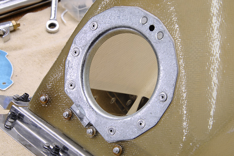

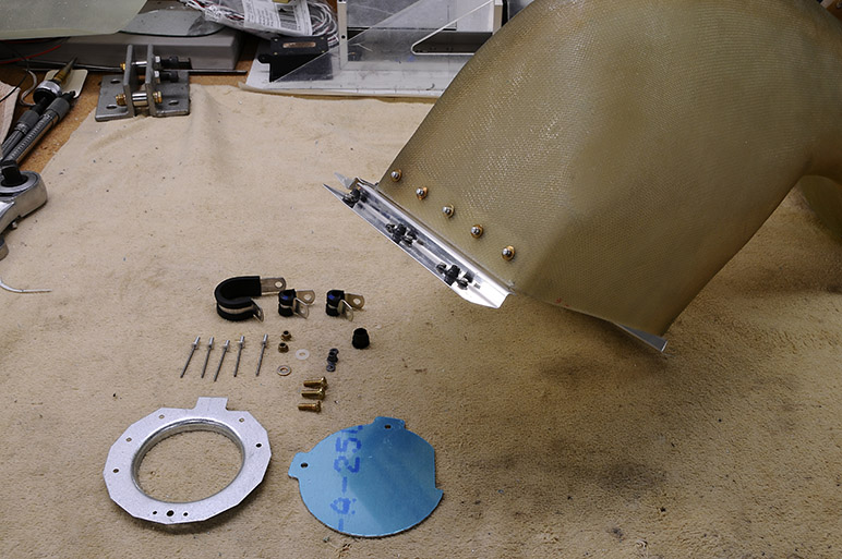

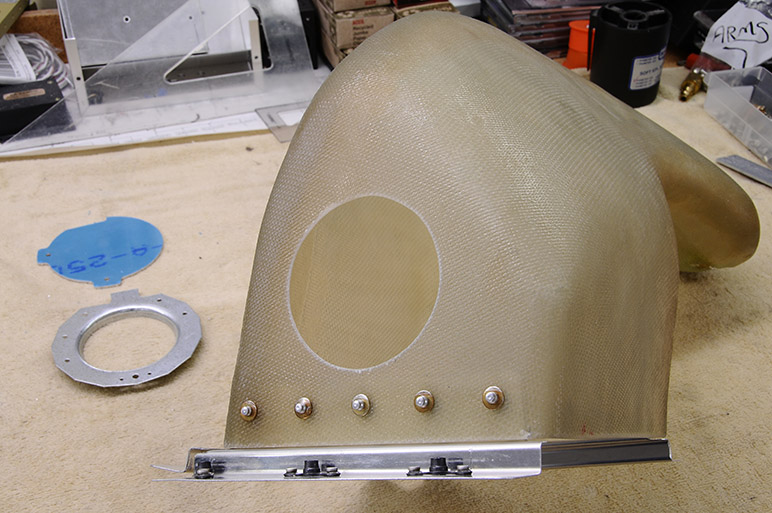

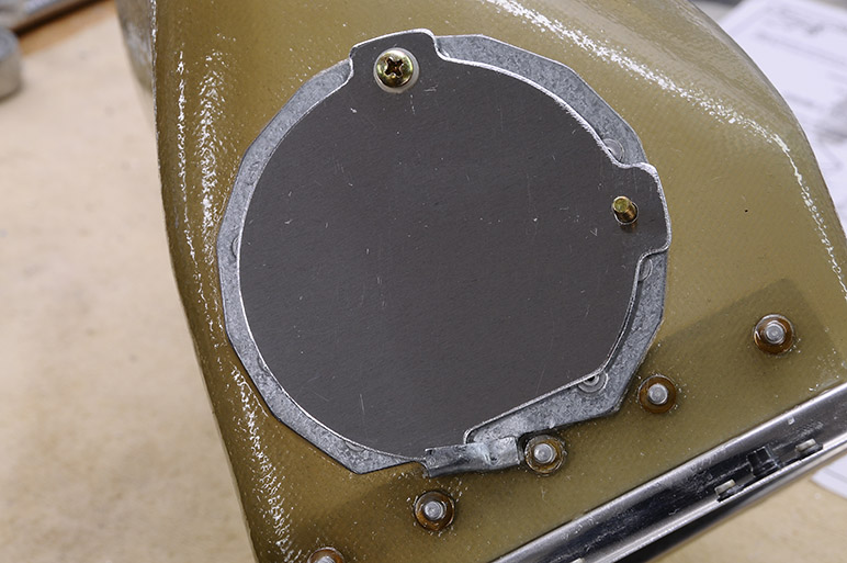

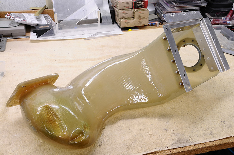

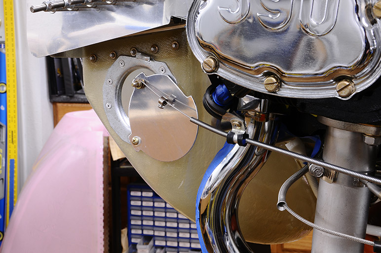

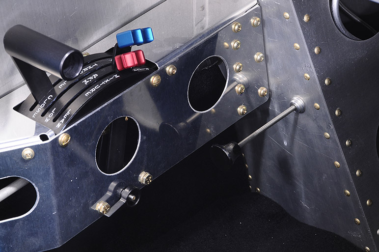

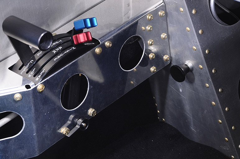

If you design the cable installation correctly, there's no need to remove the cowling. It will work like a normal control. Here are a few pictures of my installation.

We generally seal up the Alternate Air Door with a little bit (read thin
layer) of rtv sealant. You should test your installation to make sure
it will break away. We usually "test" it about 3 or four times before
first flight just by pulling on it and saying "hey, what's this for
again . . . oh yeah . . . woops". So label it early.
