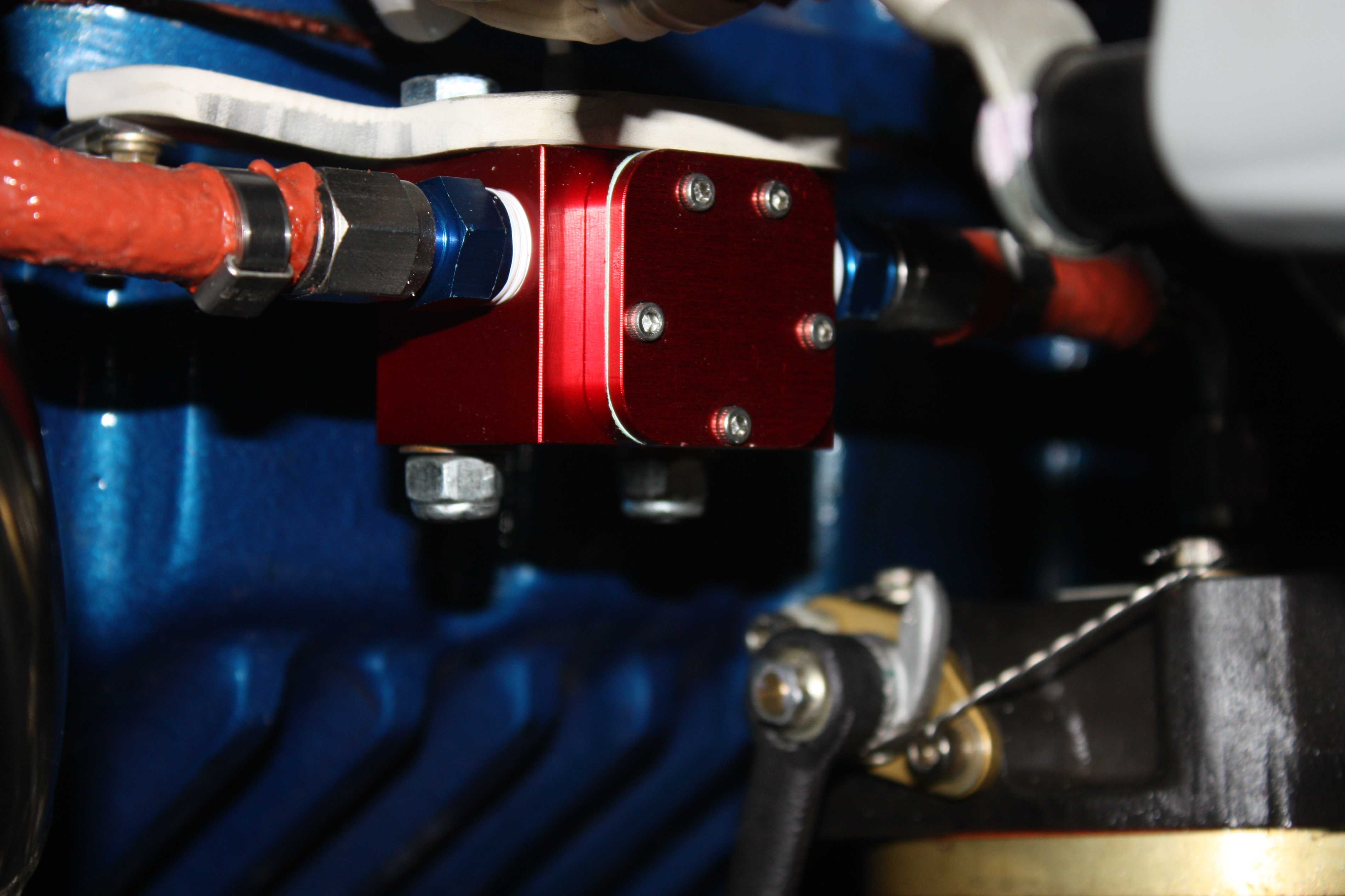

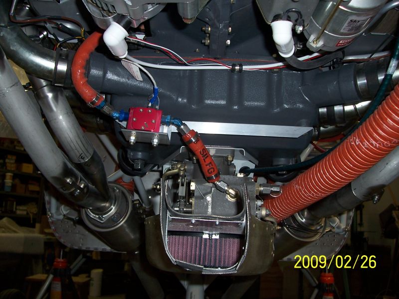

Hey Myron. Don McDonald here.... I have several... pic 6812c is actually mine... white is rubber (totally mounted to the rubber)... Just an fyi.. I was having trouble with the fuel flow going to zero about 2% of the time... wouldn't necessarily stay at zero, but long enough to screw up the fuel burn calcs.... since moving it forward, it's absolutely dead nuts on!

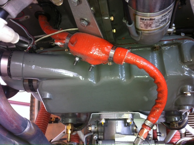

Myron here is how I mounted mine. 355 hrs and no problems

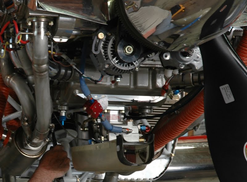

Here is a pic of mine. 280 hours with no problems. I fireslleved mine per
directions but I didn't follow the statement: Do not attach the transducer
directly to the engine......
Here is some notes from the installation manual.
Fuel Flow Transducer Notes
. NEVER blow through the transducer. Keep the yellow caps on until it is
installed.
. The fuel flow transducer(s) should be installed in a straight section of
your fuel line. (6 straight inches on each side is desirable).
. The fuel line should not drop down after exiting the transducer.
. The wires MUST NOT come out of the bottom of transducer. Wires pointing up
is the best .
. When assembling fittings into the 1/4" NPT inlet and outlet ports do not
exceed a torque value of 25 ft.-lbs.
. Do not use Teflon tape in an aircraft fuel system. Use "Fuel Lube/Ez Turn
Lubricant"
. The transducer should be mounted down stream of a fuel filter.
. Do not attach the transducer directly to the engine to avoid excessive
vibration.
. Do not mount the transducer near the exhaust systems or other hot engine
components.
. If the transducer is in the engine compartment, it should be covered in
fire sleeve to protect it from excessive heat.
. The transducer wires may be trimmed any desired length
Possible Transducer Placement Locations:
1. Between the auxiliary electric boost pump and the engines mechanical fuel
pump.
2. Between fuel injection servo and the distribution block.
3. Between the Engine driven pump and the Carburetor
Note: If your engine is equipped with a fuel return line from the carburetor
back to the fuel tank you will need to install two flow transducers.
One in the feed line from the fuel pump to the carburetor and one in the
return line from the carburetor back to the fuel tank. This applies to
certain Continental engines and Rotax 912(ULS) and 914 engines.

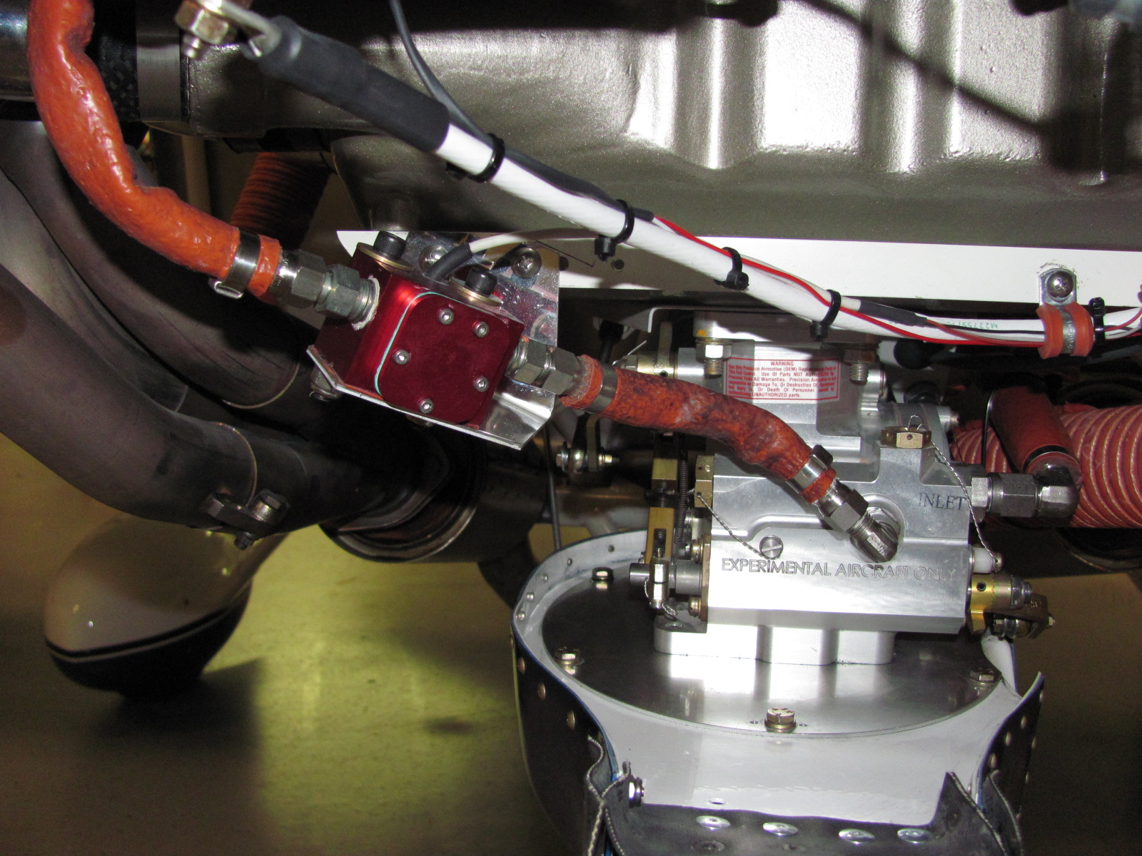

Rick,
I bought mine from Aircraft Spruce. The first link is what I clicked on and then onto the proper size, which I can't currently remember. I would just measure a rough circumference.
The second link is a new one for me. I would have ordered this if it was available when I installed mine.
http://www.aircraftspruce.com/catalog/appages/stratofs.php?clickkey=4118
http://www.aircraftspruce.com/catalog/appages/gbfireslvft.php?clickkey=4118
I cut the bolt holes through the firesleeve and pushed it on then stuck the bolts through both. I then connected the fuel lines.
As you can see I mounted mine to the engine which the instructions say NOT to do for vibration.
