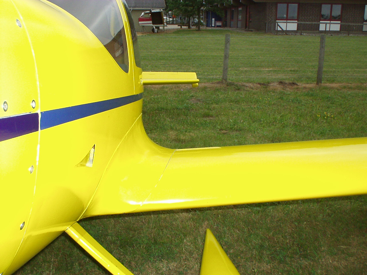

Julian Bone used his taildragger TR-1 from shorter unpaved runways in the UK until he landed at a too short field. Julian worked on the wing-fuselage intersection and reported improved handling at low speed and improved landings after he put on much bigger fairing. I enclose a picture I took of Julians TR-1 in Denmark in 2004. There should be many e-mails in the archive of this forum discussing the wing-fuselage intersection topic
