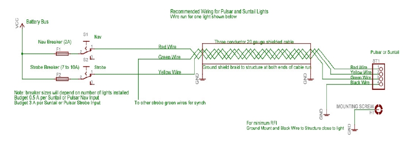

Hi all
I've started wiring my -10 and am wondering if what I'm proposing is within normal wiring standards.
A shielded 20 ga, 3 conductor wire enters the wing tip near the rear wing spar, goes forward to the leading edge.  I'd like to remove about 2" of outer insulation, 3' from the end, pull the shielding away from the 3 wires, solder another wire to the shield and ground to the metal wing rib.  The 3' shielded wire then goes to the Aeroled light via a 4 pin connector, with the shielding tieing to the Aeroled base as per  installation instructions.
The idea is to ground at the light base and at the outboard wing rib while still having enough wire to set the wing tip on the floor.  I guess I could run another ground wire from the light base directly to the ouboard rib, but why not use the shielding as it passes the rib?
Does this configuration seem right?
Thx,  Rick

Bob, a pair of Pulsar NS 90's and the Suntail.
Here's a link to the installation instructions.
http://www.aeroleds.com/LinkClick.aspx?fileticket=VLoy7bgULOw%3d&tabid=6250
I've seen your description on how to add a faston connector to shielding, so I'm basically proposing the same thing, just not at the end of the wire.
Make sense?
Thx,  Rick

Their installation drawings don't make sense.
ASSUMING that the installation has been proven
to BENEFIT from shielded wire. Who is the victim,
who is the antagonist and how does this shielding
break the propagation?
SOME led power supplies have proven problematic
for integration into airplanes. One notable product
are the LuxDrive supplies popular with some
DIY position lights installations. We crafted
a filter board for these power supplies to
fix a fundamental shortcoming for use on aircraft.
If the AEROLED product has a similar problem, shielding
the power leads won't fix it. Similarly, if the AEROLED
has some vulnerabilities to on-board transmitters, the
once again, shielded wire wont fix it.
Suggest you ditch the shielding (if the wires are already
in place, use it as a bundled trio and ignore the shields.
Install connectors as convenient to your anticipated
service requirements.
If a noise issue presents itself, let's attack the
problem with the judicious application of filter(s).

Bob, I believe the "victim"(s) are coax antenna and associated radios.  The "antagonist", I'm not sure.  I did speak to Dean at Aeroled, and I remember him talking about these lights not having a capacitor discharge, therfore the noise characteristics were different than "Whelan" type strobes.  How the shielding breaks the propagation of noise, I have no idea.
It's going to be months before I will have the strobes and radios powered up, but I'll let you know how I make out. Wiring has been installed, but no connections made.  I'm planning to go to Sun & Fun  so hopefully the Aeroled people are there and I will have a talk with them again.
Thx,  Rick
Yes, the noise is very different. While
h.v. strobe systems are replete with fast-rise
current/voltage waveforms at the flash rate
of the strobes, the LED supply noise is
an artifact of the switchmode, constant
current power supply typically used to
drive leds.
If the AEROLED product generates noises at
unacceptable levels, it's likely to be
CONDUCTED noise that will propagate right
down the power lines, shielded or not.
Have Dean give me a call any time. My mobile
phone is 316-209-7528. I'd like to explore
his perceptions of noise issues for his product.
I think we can be of service and perhaps save
future customers from jumping unnecessary
hoops.
I'm 99% sure that shielding these wires is
of no value. If there are noise problems to
be addressed, then filters located at the
source are called for.
Bob . . . [quote][b]

Did you use the latest wiring diagram off their website? The one that comes with the units is out of date.

I have the AeroLeds (two of the combined nav light/white strobe units) installed on my trike (Z19 RB). I wired up as per their instructions but they exhibit a small 'three click' noise in my headsets every time they flash. Not very loud but frustrating since all the other electrics work just fine.
I've not had time to do further debugging since early last year/2012 but I tried their suggestions of ferrite wraps. This did not help.
. . . and I wouldn't expect them to help.
What 'black boxes' are driving the headsets?
Do you have an intercom? Does a radio also
speak to the headsets?

Mike, Sorry to hear you've got a problem.
I'm assuming you used the shielded, 3 conductor 20 ga wire that Aeroled recommends?  Did you run the wire separately or in wire bundles and/or with any coax antennae cable?
No, at the time of my installation they simply specified regular 18ga wire.  I did install it with a twist the entire length. Like I said, I've just been too busy and unable to address this. When I get the time I will go back and review their latest suggestions.
I would just suggest that people considering LEDs should not assume they will be noise free (because they are LEDs!). I like mine a lot, they are low amp usage, very bright, easy to configure as sync'd lights, but the actual noise-free install is somewhat more complicated than I appreciated. Two+ years ago we were all a bit less educated on this (I certainly was), but it seems these issues are better understood.
LED lamps are, like their incandescent predecessors are quite noise free. Problem is that they are low voltage (2-4 volt) devices best driven as series parallel arrays by constant current power supplies. The power supplies are POWER OSCILLATORS with high probability of harmonic content that extends into the range of interest for radios. There may also be switching transients generated by wig-wag flashing that propagate mainly on the power supply lines.
Here's the problem. These devices are advertised with claims to having been awarded PMA for use aboard type certificated airplanes. This implies that they've been tested to the legacy electro-magnetic compatability issues common to thousands of other products presently sold into the TC aircraft industry.
When you're jumping the DO-160 EMC hoops, the product is treated as a stand-alone 'black box'. It must meet emissions standards without regard to installation issues. A requirement for shielded power/control wiring or a suggestion for avoiding wire bundles carrying other airframe wires is not allowed.
I've written to AEROLED asking to have some conversation with one or more of their techno-wienies with a goal for understanding more about (1) installation recommendations and (2) noise experiences articulated here on the List.
There's a BIG disconnect here. I'll continue to pursue a better understanding. ASSUMING we discover that AEROLED recommendations for installation are VALID, then the quality of their PMA is in doubt . . . which is really immaterial to our task. It may be that a simple set of filter components located at the power and control terminals of the device will eliminate the noises. In any case, shielded wire or selective routing of wires is a band-aid that admits to less than optimum design of the product.

Bob, forgive me for coming into this thread late. I also have been having issues with an Aeroleds setup in my RV-7A. I used to have the Whelen System 7 that Vans sold, but the powerpack failed and I decided to install these instead.
The noise I have is characterised by:
1.Noticeable dead spot from signals to the rear (at least prior to sorting out a ground as indicated below)
2.Noise on all comm frequencies caused by the NAV lights. It does not break squelch but can be heard when the squelch is disengaged and the navs turned on
3.Reduction in effective range of the Comms over my Whelen System 7. I used to be able to get the ATIS on my home field from 50nm and 7000’. I still can with the aeroleds turned off. If they are on I get nothing until I turn the lights off.
4.I can hear Nav and strobe noise in weak comm signals.
5.Navs + Strobe is even worse
6.The whole setup does not compair favourably to Whelen.
I use my aircraft for IFR/night etc and have over 500 hours in four years or so, so probably fairly aware of how the systems should work.
I spent a few hours in the hanger looking at my Aeroleds on the weekend and some more yesterday. I came to a few conclusions:
1.I have/had wired them as per the instructions.
2.I did find that the tail light was not properly grounded between the case and the black ground wire so I fixed that and it did reduce the noise but still not to where I am happy. (took for a test flight)
3.The wiring scheme suggested by Aeroleds actually looks like it would causes a ground loop between the airframe and the shield (when grounding both ends of the shield) . When connected on the Left wing it reduces the pop from the strobe on right and tail it appears to make no difference.
4.The tail nav is by far the noisiest and virtually impossible to quiet down. I assume because it has a lot more LEDs in it. I reduced noise by disconnecting the ground wire entirely (runs to my aft fuselage bulkhead). This seems to imply that local grounding is required. I may need to look at how I can achieve that with my rudder.
5.The Green (RHS) nav light is the next noisiest, followed by the red one (LHS). Both of these are very quiet in comparison.

PostPosted: Mon Jan 14, 2013 8:14 am    Post subject: Aeroled wiring Reply with quote
At 09:04 PM 1/13/2013, you wrote:
--> AeroElectric-List message posted by: "rwtalbot" <richard(at)talbots.net.au>

at the installation manual for one of their nav/strobe
combo products we find this wiring diagram:
[img]cid:.0[/img]
This 'smells' . . . If I had proposed a product that REQUIRED
such accommodation by the system integrator/installer, I would
have been summoned to the boss' office for a come-to-jesus-meeting.
More importantly, I'm not sure just how I could take such a product
to the EMC lab for testing with shielded hookup wires. If one places
a conducted emissions probe over a shielded wire, it is EXPECTED
that measured energies will be attenuated with respect to that
which flows on the wires. I'd really like to read their EMC
report. If the system just barely passed conducted EMC emissions
with a shield, what would they have measured without the shield
or at the end of the shield where the wire break out to hook
up to the rest of the airplane?
I've written, observed and/or orchestrated hundreds of DO-160
EMC qualification programs . . . the experiences of List
members combined with AEROLED's published installation
requirements suggests that somebody dropped the ball for
getting this product to market.
