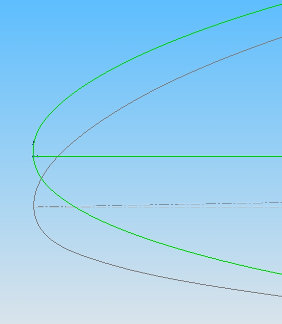

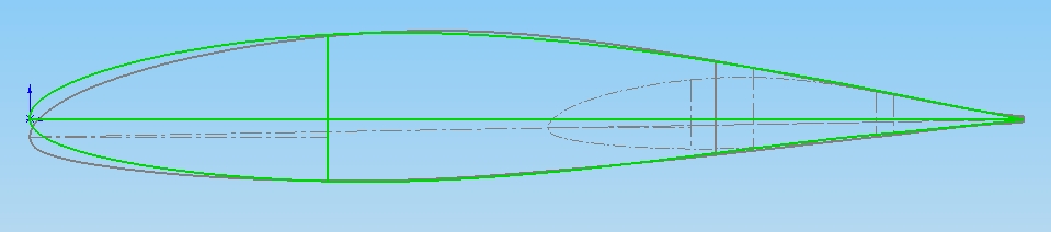

I draw up both airfoils for evaluation and when aligning the portion where main and after spar will be, it is a different of 1 degree at the chord line. (From nose radii to trailing edge)
The NACA is in Green
From the main spar and back there is very little difference in shape, meaning the lift at same angle will be about the same with this difference in angle
The chord line is just a reference line that is convenient to draw and measure, but aerodynamically it is almost a fictive line, the important line or angle of an airfoil is the zero lift angle, from this line the lift is generated if it is given an angle to the relative wind, think of an symmetric airfoil where the zero lift line and chord line is the same, and at alpha zero it will not produce any lift.
An airfoil with camber will produce lift even if the chord line is at alpha zero, or slightly negative, because the zero lift line will have a positive alpha to the wind.
To make a cambered airfoil to produce zero lift, the nose have to be lowered until the zero lift line is parallel to the wind, so an cambered airfoil is said to have a zero lift angle of minus some degree depending of the camber, it can be -1 to -6 degree on common airfoils and camber.
The NACA 63A-215 have a zero lift angle of -1.64 degree, and the Riblett GA-37A315 -2.14 degree.
A difference of 0.50 degree.
angle

I draw up both airfoils for evaluation and when aligning the portion where main and after spar will be, it is a different of 1 degree at the chord line. (>From nose radii to trailing edge)
lift.

on the bottom side of the Hinge line, inside the elevator, inside the rudder, inside the aileron, and bottom of the flap hinge line.
Having them unsealed is like driving with the parking brake on.
On a Kitfox it is the difference of being able to make a 3-point or not with or without sealing the elevator gap.
Jan Carlsson
JC Propeller Design
Ps. Sorry to say, I have never been onboard a KIS.
www.jcpropellerdesign.com
http://forums.matronics.com/viewtopic.php?p=392088#392088
http://forums.matronics.com//files/63a215_37a315_le_rad_133.jpg
http://forums.matronics.com//files/63a215_37a315_184.jpg
