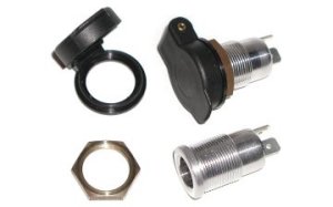

I'm not sure about popularity, but I'm installing some of
these in my RV8:
http://www.powerletproducts.com/
They seem to be used on millions of motorcycles, and
are of much higher quality than the cigar lighter type.
The powerlet products people are also very good folks.
Mickey Coggins
http://www.rv8.ch/
#82007 finishing

PostPosted: Fri Jun 09, 2006 2:34 am    Post subject: Power and audio input jacks Reply with quote
Where'd you find a bulkhead-style plug? I"m having trouble locating one.
Brett

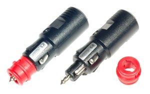

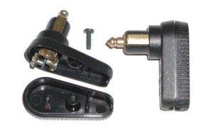

PostPosted: Fri Jun 09, 2006 4:35 am    Post subject: Power and audio input jacks Reply with quote
A little further research on their site shows they also have right angle plugs...another good idea!
[img]cid:part1.05000604.08090402(at)agelesswings.com[/img]
And if you ABSOLUTELY want to have a device usable in both types of sockets, there is a plug that fits both the cigarette lighter and theirs for $15:
[img]cid:part2.08040506.03060400(at)agelesswings.com[/img]
Looks like they can supply a means to hook up or adapt anything you want.  Good site!
(And, no.,..I don't have an association with them...just like the ideas!)

PostPosted: Sat Jun 10, 2006 3:29 pm    Post subject: Power and audio input jacks Reply with quote
They are smaller than the traditional cigarette socket/plug (which is a
good thing for our aircraft, no?), but they also have adapters so you
can plug your cigarette lighter plug accessories into their power plugs
and not have to wire one of their plugs onto the accessory and then not
be able to use it elsewhere!
They also have these that are all aluminum for $30:
I originally bought the "military style" (PSO-003) connectors,
but I ended up sending them back. I think they would be fine
on something like a dune buggy or snowmobile or sand rail,
but are severe overkill for the inside of a cockpit. The
screws tops are hard to get off and on, and the chain
tends to bunch up when you spin the cap.
I sent them back to Powerlet, and they gave me full credit,
and shipped the other model with the flip caps (PSO-001) to
me in Switzerland at their expense. That's what I meant when
I said they were good people to deal with!
These connectors are small, and there are *tons* of accessories
that use this type of connector in the motorcycle world. They
have a lot of the same types of requirements we do. As you
mentioned, there are adapters to the cigar lighter connector,
and a lot of other connectors.
http://www.powerletproducts.com/products/cables.php
I bought a cigar lighter adapter, and one for the SAE type
cable, which works perfectly with the battery tender.
