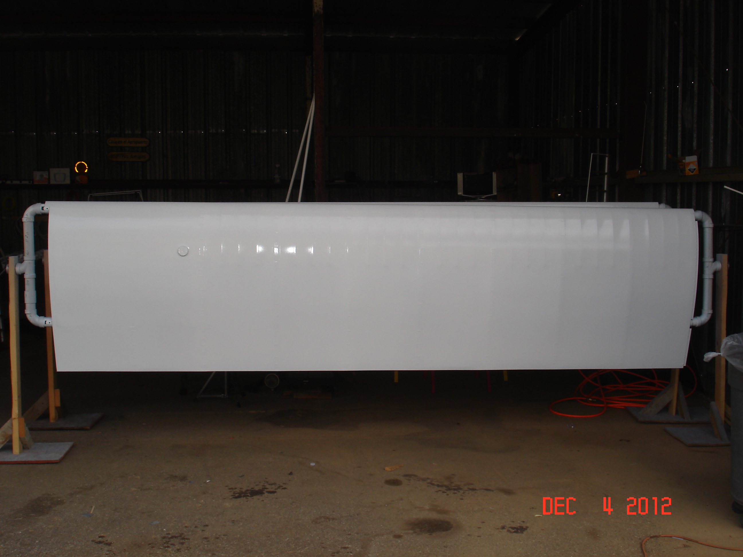

I am using Stewart's System on my my KF7.
I'm using their adhesive, fill, and paint.  I've only painted the wings so far.  I used less than a gallon of White two-part epoxy paint from Stewart.  I am not a painter, first time to attempt to paint with a spray gun.  But I have to say the quality of the paint job we did is as good as I've seen anywhere.  The paint is water borne, not water based.  Clean up is a snap compared to the other paints.  I'm going to try attaching a picture of the finished product.  We put six coats (three cross coats) of fill and six (three cross coats of epoxy paint on the wings.
If I can paint, without any runs and get a good smooth finish, anyone can.
Stewart supplies a seven DVD set that guides you through the process from preparation, to the finish paint.  That really helped me.  You can also find a lot of their videos on line at UTube.com
