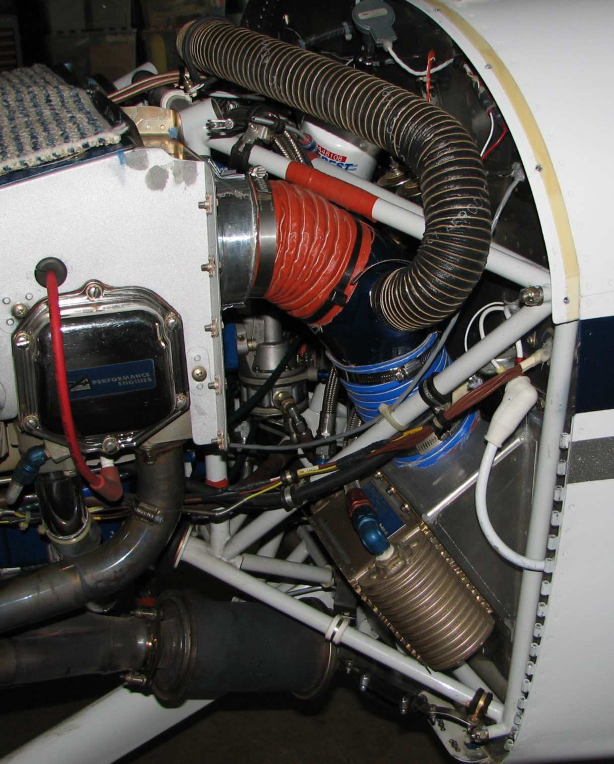

I posted this awhile back on what I did:
I have a small piece of KoolMat http://www.aircraftspruce.com/pages/ap/insulation/koolmat.php on the firewall. It is between the cabin heat control valves and the firewall, then extents up and over the top of the valves. The idea is to not blast the engine and fuel pump with hot heat muff air that bounces off the valves back toward the engine when the valves are shut (on hot days when you least want hot air banging on the fuel pump). So the KoolMat insulates some thermal heat transfer to the firewall, and looping the KoolMat over the top and then down in front of the valves directs the dumped heat muff air down and away from the engine.
Regarding the heat muff air itself, there is a balance between having heat on a cold day, and on hot days robbing engine cooling air off the top of the engine just to dump hot air near the cowl exit – right where you want the lowest pressure possible to draw more cooling air through the engine. I have two 2” SCAT hose flanges over #5 cylinder, one for each heat muff. This proved to be way too much air volume. I put a piece of .025 aluminum disc with a 1” hole in it over the edge of each flange (the disc is just a bit bigger than the flange diameter). The disc is held in with aluminum tape and the SCAT hose slides over it. This does two things; reduces the volume of air coming off the top of the engine and slows down the air in the heat muff so the air is warmer, but less flow in the cabin. This is still more heat than I’ll likely ever need, but I’m happy with the compromise. If you are still building, an easier way to do this is to just have one 2” flange on the rear baffle, then a Y to connect two SCAT hoses.
One other trick I did was fabricate a couple of 2” to 1.5” reducers so I could run 1.5” SCAT hose in the tunnel for the rear heat. This solves a lot of clearance issues caused by the 2” rear heat SCAT hose.

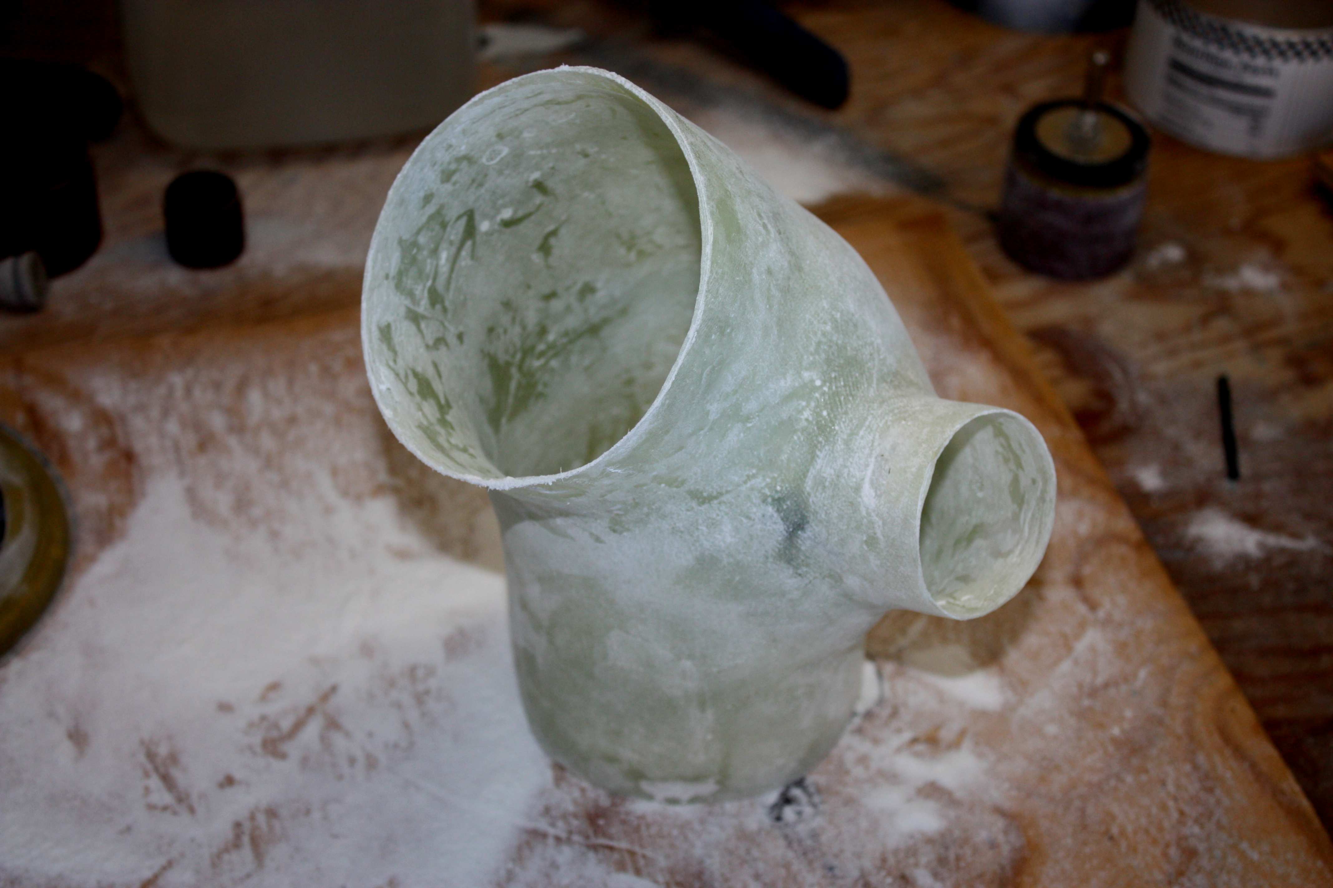

Sure you can remove the heat muff.... I did... And as far as I know.... no one has done this.... I have cold air induction, and one of the things I did to cool things down a bit was to run the rear cabin heat air straight out of the back of #5 cyl over the top and into a fiberglass "Y" I made that has the 4" line from #6 and that 2" line from #5 going into the "Y", and into the oil cooler.  In the winter I put alum tape over the outlet for the 2" line (at the back of the plenum for #5) and use the butterfly valve on the 4" line to keep the oil temp exactly where I want it.
I also used a "Y" to split the heat from the remaining muff into both the front and rear heat ducts.

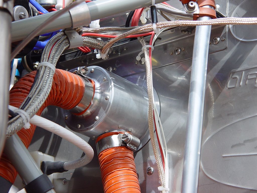

Thanks, Gordon... the reason I want to disable it is that it dumps hot air directly onto the firewall, which makes the cabin warmer. Anyone know if it's possible to remove the heat muff completely?
On Thu, Mar 21, 2013 at 2:00 PM, Gordon Anderson <[url=/mc/compose?to=mregoan(at)hispeed.ch]mregoan(at)hispeed.ch[/url]> wrote:
Rob,
I think your concern is valid. The muff will insulate the exhaust pipe and you may end up with a high temperature gradient between the section outside the muff and inside it, possibly resulting in deformation or cracking after a while. Since cracking would release exhaust into the cowl area, it could become a real concern. Personally I would keep the cool air supply to the muff and dump the hot air coming out of it. Since that is what happens in the stock system when the heater flap valve is closed, I don't follow why you want to disable it at all, rather than just not use it. If I really wanted to disable it I would probably just disconnect the control cable and use Biotherm to seal the flap in the closed position.
Gordon Anderson
On Mar 21, 2013, at 2:44 PM, Rob Kochman wrote:
Thanks, guys... my concern is that with no airflow into the muff, it's acting as an insulator on the exhaust pipe. Perhaps it's nothing to worry about, though.
-Rob
On Thu, Mar 21, 2013 at 5:32 AM, Jesse Saint <[url=/mc/compose?to=jesse(at)saintaviation.com]jesse(at)saintaviation.com[/url]> wrote:
Rob,
Not all exhaust pipes even have heat muffs. I can't imagine it getting too hot there and being ok with the temperature along the rest of the exhaust. I'd leave it off completely. Instead, you might hook it up as normal and just cover over the hole in the baffles so you could easily add it if you want to.
