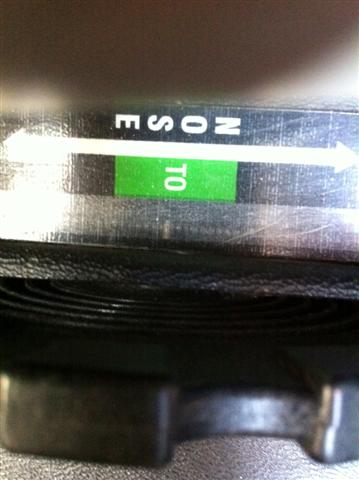

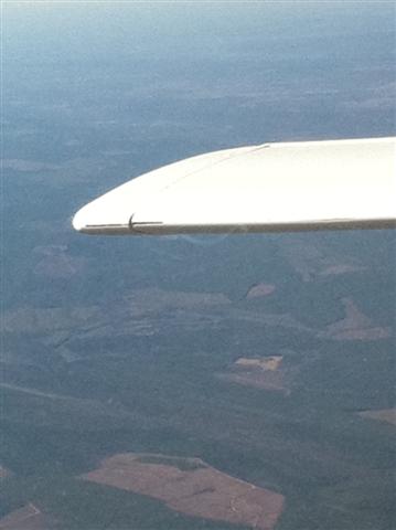

Ned posts:
Ok, I'll buy that.
My tiger flies with neutral trim at its maximum speed. The horizontal stab is aligned with the elevator which is aligned with the trim.
So it has no drag due to trim while racing.
Also, it has the engine thrust pulling straight ahead. So I lose no thrust due to a downward component.
Now I understand better why you say you need to fly the tail on your plane. That is, you don't have the horizontal stab aligned with the elevator aligned with the trim. Your plane has to have some pull up to counter the engine pulling it down.......???
Like you I reflex the flaps to lower the nose for a little bit more speed. The amount of reflex is dependent upon how much fuel, (weight) I have on board. I find best speed is when flap reflex gives about 1 to 1.5 degree nose down as indicated by the canopy rail.
