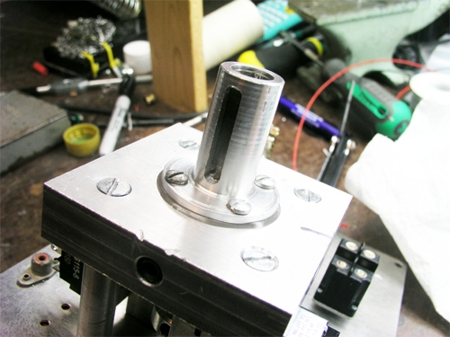

I've got a project that hit a bit of a snag. I'm
building a recovery parachute control system that
uses a t-handle to deploy the parachute. I found
a really handy size T-handle in McMaster-Carr
and proceed with my endeavors.
One of the last operations during assembly called for
cutting the shaft of the t-handle to length and then
drilling a 3/16" hole in the last 1/2". The hole
accepts a roll-pin that runs in the slot on a guide
collar to set stroke of the handle and to restrain
rotation.
[img]cid:.0[/img]
When I cut the shaft with an abrasive cut-off wheel, the
it turned out to bet harder than the hubs-of-you-know-what.
It's the right length but now I need to drill the hole. No
chance with any tools I have.
I think I recall that steel can be heated to some pretty
ordinary temperatures (less than incandescent) and cooled
slowly to remove the heat treat. Strength in this area is
very un-critical. I can put a thermocouple on it and heat
with a torch. I've browsed some heat-treat documents
but the without some time consuming study, no immediate
notions of process jumped out. I need to soften this part
so that I can drill it with ordinary high-speed drills.
Are there any folks on the list with some practical experience
in this area? Hoping to deliver this thing tomorrow but
it ain't gonna happen without the pin installed. Any
suggestions from the List?

EDM aka Electrical Discharge Machining. Google it for a machine shop that has that capability in your area. EDM easily penetrates any conductive material.
Good luck, Bob
P.S. You would need to locate a RAM type (plunge) EDM setup as opposed to a wire type EDM machine if you intend to go this route.

I don't do a lot of this but if it is carbon steel just heat it up to a
nice red color and air cool it. The hardening only occurs if it is shock
cooled in oil or water or the attached heat sink is relatively massive.
A room temperature slow cool should take out the hardness.
A good carbide masonry bit running slow will sometimes go through pretty
hard steel. A hardware store cobalt bit is dramatically better than an
High Speed Steel bit.
Ken

There are many people that will say duh, but there may be a few that will
later thank me.
I have heard many complain about drilling the stainless firewall and taking
an hour and one drill bit per hole.
I will share what I learned the hard way.
I am able to drill the stainless in less that one minute and not dull a bit.
It is all about removing heat from the drill bit and the part you are
drilling.
If you use a high speed and it doesn't cut it will burn up the bit.
In order to remove the heat you need to have chips flying.
Aluminum is soft so the 4000rpm air drills we use work fine.
The chips are a flying carring the heat away.
For harder metals you need to increase the pressure and slow the bit down
until the chips fly.
It is as easy as that. Slow the drill speed down and increase the pressure
until the heat is removed by flying metal chips.
Now I have not tried anything too hard since I learned this but I sure have
made butter out of the stainless that other people complain about.

rotation.

Bob -
If the part is not critical, just heat it up red hot, hold it there for a minute or so, and let it air cool. Here is a fair discussion of the process. http://www.efunda.com/processes/heat_treat/softening/annealing.cfm
Alternatively, a very sharp drill bit, turned very slowly will also work with lots of cooling fluid. I set up my drill press for that very purpose (had to drill some spring steel with out having to re-treat it) by installing a secondary motor with small pulley. Liked it so well that way that I just left it set up. Doesn't do well on soft metals, but is not nearly as hard on drill bits, and works for nearly any type of steel.

Bob -
Essentially that's what I did.
I tried that earlier but the stuff was so hard
my center punch wouldn't even mark it! Couldn't
get a bit to set still in one spot long enough to
remove any material.
Softening it up worked great.
