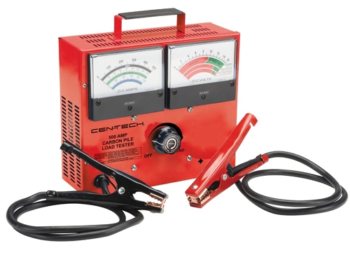

This is a good beginning . . . unfortunately, starters make very poor loads for the purpose of conducting diagnostics. Starter current is directly related to load . . . which varies wildly as the engine rotates through cylinder compression cycles. Taking a reading from a digital display watching voltage drops generated by a starter motor is difficult if not impossible. An analog meter will be a little better but not by much. Measuring voltage drop across various portions of the power loop under known load is fundamental to the low-ohms adapter hardware and articles offered on the website. The low-ohms adapter illustrated offers a maximum of 1 amp excitation current. A bit low for measuring starter circuit drops with commonly available instrumentation. One would LIKE to excite a path under analysis with a steady 10 or even 100 amps. This isn't as hard as it might seem.
The folks over at Harbor Freight offer this carbon pile load battery tester which is capable of developing a reasonably steady state load at 200 amps or more.

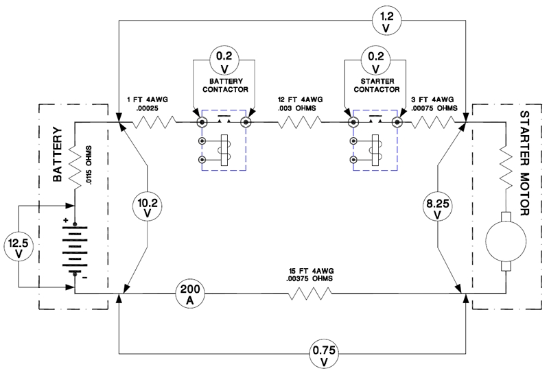

[img]cid:.0[/img][/b] To use this device as a circuit quality tester, you need to wire it to your airplane such that it REPLACES the starter as a load on the system. This is BEST accomplished by adding short test-pigtails to the ship's wiring such that the 'test clamps' do not connect to the airplane's wiring. If these 'slip' or fail to make good contact throughout the test effort, they might arc and damage parts of the airplane. The BEST way to make these connections is to cut the clips off the test cables leaving about a 6' pigtail on the clip. Install ring terminals that can be used to bolt the cable back together later thus restoring the original functionality of the tester. With the clips 'unbolted' you can attach tester wires to the crankcase and the starter power terminal. For this test, remove the jumper on the starter's pinion gear engagement solenoid to disable the starter. You might also wish to fabricate a hand held 'pickle switch' to energize the ship's starter contactor. The lead wires for this piece of equipment needs to be long enough so that you can control the load from any place you're observing your voltmeter.
Now, you may need to enlist the help of someone to 'manage the load' . . . tell your assistant to crank the load knob up to achieve the desired test current, 100A is probably enough. With a little practice, you can easily hold a test current to within 5 amps or so.
Now, as you probe various portions of the (+) or (-) starter circuit with a voltmeter, you can hit the system with a test load likely to produce useful readings for voltage drop on your plain-vanilla multimeter . . . either digital or analog. Most off-the-shelf meters have a 200 mV full scale reading. With voltmeter and pickle-switch in hand, you can explore the cranking circuit in its entirety. Any portion of the circuit with compromised integrity will probably manifest with rather striking voltage drop. Your starter contactor is an intermittent duty device; you want to make the readings rather quickly.

In the mean time, you can modify the HF battery tester into a steady-state load that will yield very useful data for evaluating the integrity of your system's fat wire circuits.

True. But placing the touchy-feely technique into context, I rather imagine
that any component that exhibits an extra-ordinary rise in temperature after
a few seconds under load is on the verge of driving over the cliff of
precipitous failure.
For example, I would think that dissipation local to the 'touch point'
must toss some goodly watts heat. Consider the 1' foot wire segment
between battery(+) and the contactor in the figure below. 0.00025
ohms x 200A = 50 millivolts of drop. 50mV x 200A is 10 watts. A 10
second 'cranking event' may produce detectable rise but would you
be able to tell if the rise were say TWICE the normal amount?
The 200 millivolt drops I hypothesized for each contactor is a total
for up to 6 metallic joints in the path that includes wire to terminal,
terminal to contact post, contact to armature, armature to contact,
contact post to terminal and terminal to wire. EACH of those joints
is very low in resistance but NOT zero. The drops in components and
joints can all add up to a significant total but no single joint
produces a predominantly obvious drop.
I think I once suggested that there's no such thing as a "12v starter".
I made that assertion based on a hypothetical not unlike that pictured
below.
[img]cid:.0[/img]
This figure illustrates the reasoning behind the notion for measuring
a battery's ability to deliver a current to a terminal voltage on
the order of 9 volts. We like to see numbers in the 400+ amps
range. This demonstrates that with a 200 amp load, voltage drop
within the battery will be about half thus leaving us with 1 to
1.5 volts of 'head room' to toss off in cranking circuit components
and still get 8-9 volts to the starter.
If one observes a change in cranking performance the prime suspect
will be the battery. It's either not fully charged or nearing end
of life. Look at the battery voltage under load first.
The starter is a second order suspect. Measure its terminal voltage
under load. If 'high', then for what ever reason, it's drawing
less than normal current (high internal resistance) and is probably
self destructing. If the voltage is low, then start looking at the
remainder of the cranking loop voltage drops. There's a lot of
opportunity for loop resistances to go up with the most likely
prospects being contactors. Any contactor who's voltage drop has
risen so much as to affect cranking performance will probably
be smelling bad but might not demonstrate a marked temperature
rise detectable by feeling the outside surface of the enclosure.
This narration is the foundation for the starter circuit analyzer.
An 8-channel, a/d complimented with data integration software
could take a 10 second look at a cranking event and instantly
highlight the probable culprit for poor starter performance.
The probability of identifying a 'warmer than usual' component
in a suite of components that warms up in normal situations
is somewhat problematic.
 Filesize:  109.79 KB
 Viewed:  12682 Time(s)
