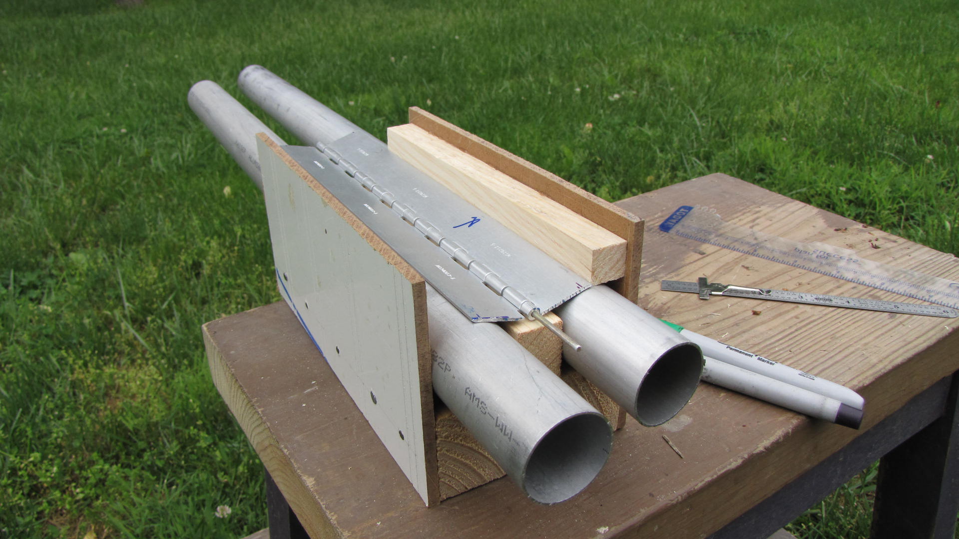

The picture shows a jig which immobilizes the hinge in position for drilling.

Doug- What kind of bushings? Keep posting!!!

My other tip shows cutting bushings and someone asked "what bushings" on this thread showing the hinge drilling jig. FireFly uses bushings cut from 5/16 ID steel tube. They are used where horizontal stabilizer attaches at the back to the elevator and at the top and bottom of the lift struts. Bushings act as spacers on 5/16 bolts.
