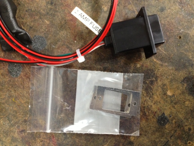

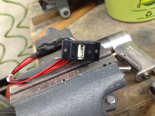

PostPosted: Fri Jul 12, 2013 1:40 pm    Post subject: USB Charger Adapter Reply with quote
Here are a couple of pics
On Jul 12, 2013, at 12:50 PM, Albert Gardner wrote:

PostPosted: Fri Jul 12, 2013 1:55 pm    Post subject: USB Charger Adapter Reply with quote
His site describes this as 1.5A, which I do not think is enough to charge an
iPad.
rv10flyer(at)live.com
PostPosted: Fri Jul 12, 2013 3:02 pm    Post subject: USB Charger Adapter Reply with quote
with a 2a fuse, as seen in the picture, I guarantee it would not work on an
Ipad.
stein(at)steinair.com
PostPosted: Fri Jul 12, 2013 3:11 pm    Post subject: USB Charger Adapter Reply with quote
They are 2A units, but experience and lots of testing has shown us that the
real world usable output of these things is closer to 1.6-1.8 instead of 2.1
when plugged into a running iPad. That means that if you have a regular
iPad up and running something like Foreflight along with Bluetooth, gps and
music going then this will just keep a float on it and not charge
aggressively...but if you shut off the intensive apps or it's resting then
it charges it just fine. It'll also charge an iPad mini in all conditions
(apps running or not). We spent a whole lot of time testing these out on
the bench and in the planes and I wouldn't sell something based on just
magazine info...you can find plenty of those out there that in fact don't
perform in the real world as advertised. Anyway, it's the best that can
easily be done in a reasonable price point and will cover a large majority
of what it's intended to do; so as usual I'd rather under promise and over
deliver instead of the other way around.
Just my 2 cents as usual!
Cheers,
Stein Bruch
President - SteinAir, Inc.
651-460-6955

Thanks, good reminder to do the math. See you at Oshkosh.
Bill Greenley
wwc4(at)njit.edu
PostPosted: Fri Jul 12, 2013 5:16 pm    Post subject: USB Charger Adapter Reply with quote
PostPosted: Fri Jul 12, 2013 5:37 pm    Post subject: USB Charger Adapter Reply with quote
If you say it works I would never bet against that based on your history! My
history has never seen my ipad work on a outlet with a 2a fuse however. You
have always been different Stein. So no! I wont bet against you and your
word..ever. a losing proposal!
Thanks for trying however!! Wink
