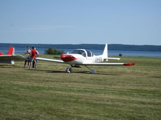

I knew this Mark, but I have not gotten around to do that modification.
It now moves upward on my to-do list Smile
Thanks everyone else for sharing the experiences with the gear leg, and the
advices.
I think the way to go is to remove the leg, remove the paint and get someone
competent to re-shape or replace the bent part. Then modify the Pilot
handbook to say "stay away from grass runways"!
Hans Christian

The main issue with the nose gear is the main gear location!
On most trigear aircraft the main gear is placed so that about 85% to 92% of
the load is carried by the main gear and only 8% to 15% is carried by the
nose gear with a loaded aircraft. On the TR-1 with the stock main gear
location the nose gear has about 30% of the load! Twice what it should and
twice what the nose gear is designed to hold.
So if you have not done so already move your main gear forward. The
simplest way is to angle it forward by making a flox wedge shim between the
gear and the gear tunnel. Not only will this reduce the load on your nose
gear it will make takeoffs and landing much more smooth.
If your nose loads are what they should be and you land on the mains you
should have no problem with the original nose gear.
Mark Kettering
